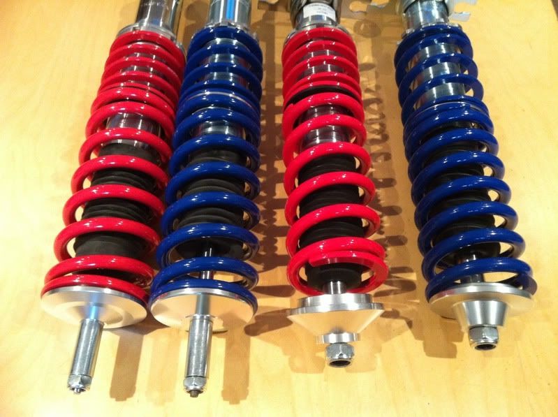

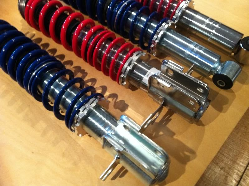

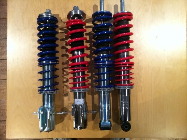

Firstly how do they look ?
at first glance they look identical apart from different colour springs.But when you look further you start to see differences
1 - Jamex units very slightly heavier
2 - Jamex spring on compress by hand test were a lot firmer
3 - Jamex shocks return almost immediately when compressed while hotuning shock returned a much slower rate

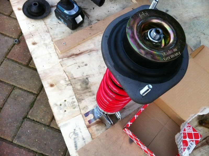

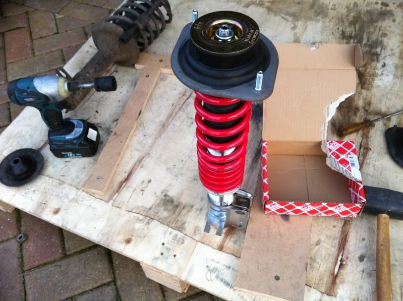

Top Tip if your going to change your suspension well worth changing the top mount at the same time ! I went for original quality Bilstein Febi (Made in germany about £40 the pair)
My Bro fitted these with ease and tightened it all up and then was just a matter of repeating the process on other side took him less than a hour,

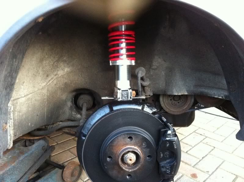

Then stuck the wheels back on and lowered the jack !
Even though there was 40mm still left on thread the jack still got stuck ! Car was to low !! so I had to pick it up while my bro pulled the jack out .
Wow what a difference
So it was getting dark so we decided to continue tomorrow on the rears but couldn't help ourselves and decided to go for a 5 mile test drive .
I was pleasantly very impressed with these even at this height the ride felt really smooth obviously not like stock but no bunny hopping down the road, another surprise was how the fronts did not bottom out ( my AVO kit banged hard on even the smallest London pot hole even on soft setting) another immediate difference was in how much more responsive the front end was just a little turn of the wheel made the car steer accurately.
But that's all for today folks, going to put the rears on tomorrow and will continue the review.

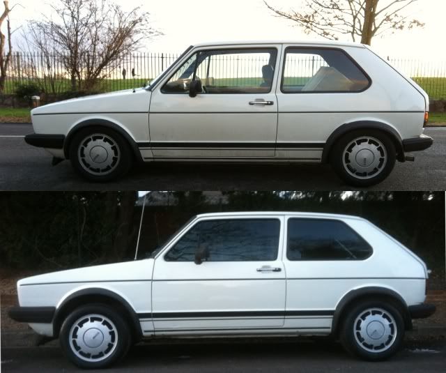

Looking at the before and after shot we must have actually come down at least 85mm already the MK1 looked liked a totally different car !
We kept the front a little lower to give it a proper mk1 aggressive stance.
