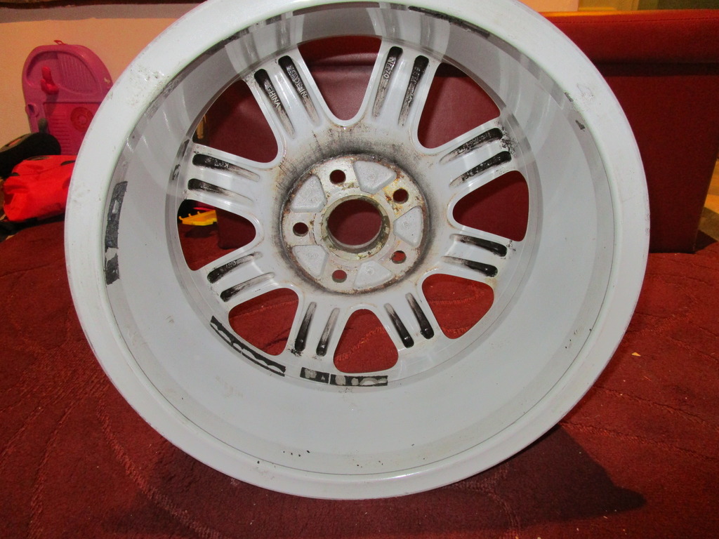

The front alloys are creoded on the lip and when they fitted the new tyres they did say they might leak air which they are so every week I have to pump up the tyres. I have found a second hand set without tyres for £50 delivered to my door! Bargain price I thought so I'm just cleaning and painting them to swoop the tyres overs and I now have a spare wheel.
Never realised the edge was diamond cut.
Bit of cleaning!
And painted.
