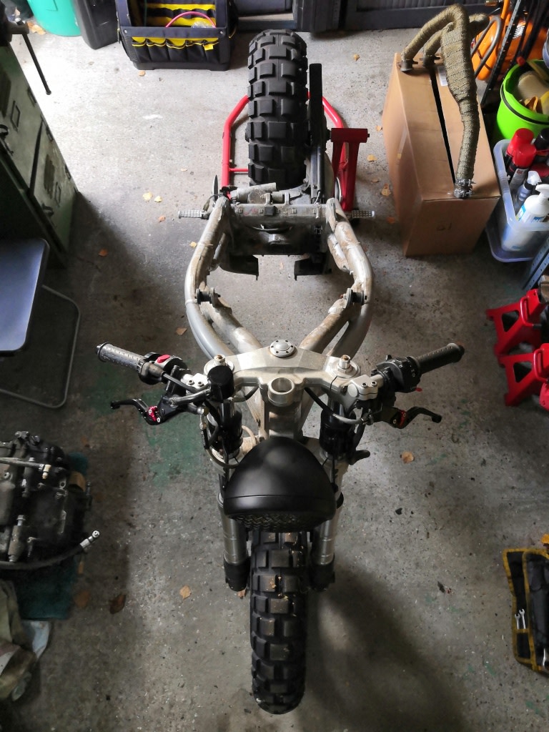

First thing was tyres
Managed to pick up a near new pair of Continental TKC80's in exactly the size needed
Next was to scrap the flat bar conversion (and sell for a tidy sum) before fitting the original bars, new 7" headlight with yellow lense and grille and billet brake fluid reservoir (not fitted in photo)

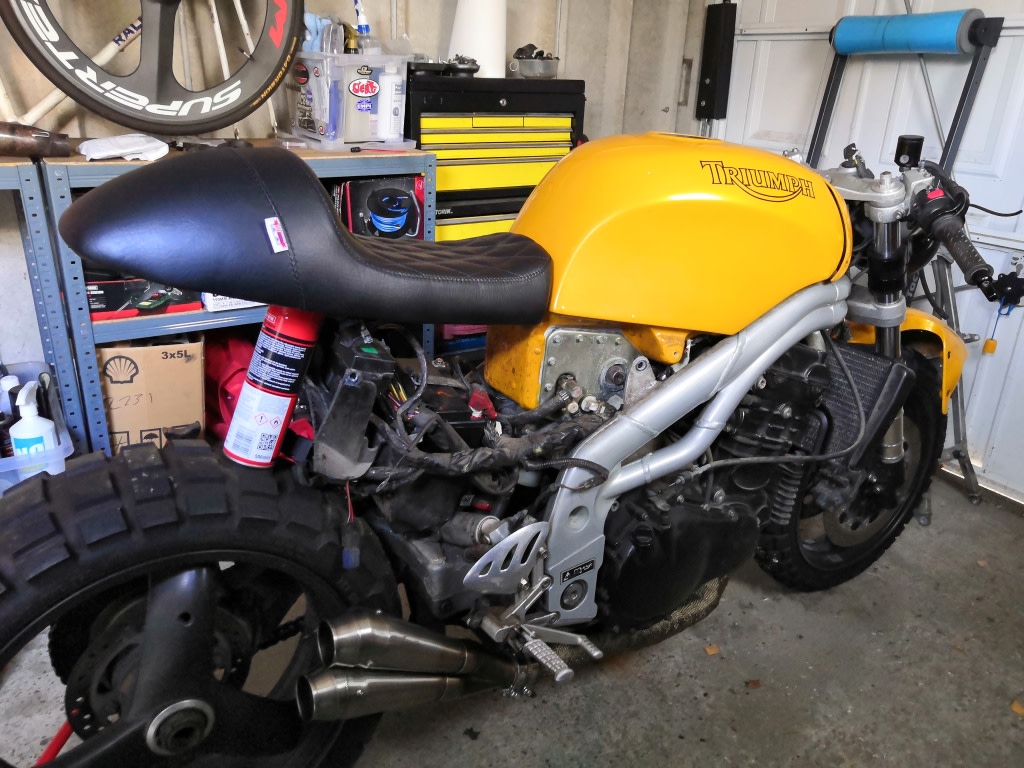

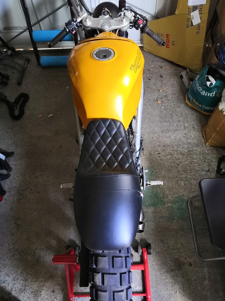

I eventually decided on a seat unit I liked and mocked up where I wanted it to be
Its going to sit about 3 inches taller at the back than before but being 6'2" that's not an issue and it means the numberplate can be mounted underneath in front of the back wheel
All the rear lights and indicators will be housed as LEDs in the rear frame itself

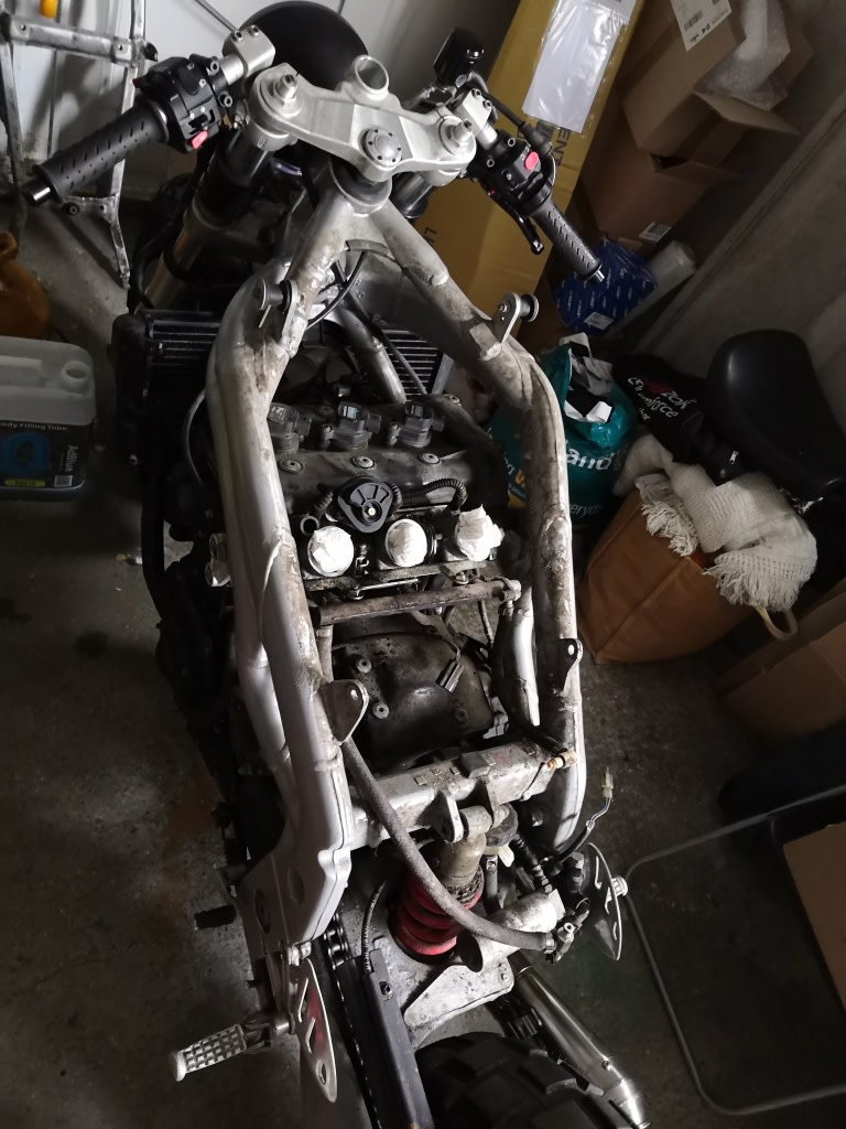

Time to get it ready to send to the fabricators for the rear subframe
Removed the full loom and with the help of a label printer marked everything up,  coolant system off and lump out
And its off to the fabricators, hard to believe but this is progress
