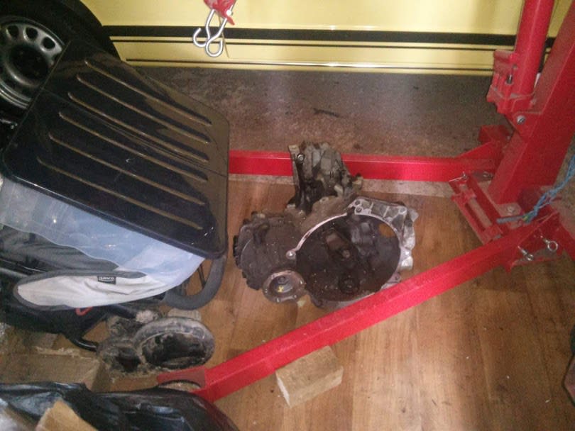

And V5 gearbox:
At the weekend I can get the engine and gearbox on stands and start the clean up process :)

Got the gearbox and engine on stands :) gallery_23668_521_11876.jpg gallery_23668_521_48647.jpg gallery_23668_521_144627.jpg

gallery_23668_521_17466.jpg gallery_23668_521_207895.jpg gallery_23668_521_320338.jpg gallery_23668_521_366158.jpg
Put the 100mm cups on for you Lhasa2008 :lol:
