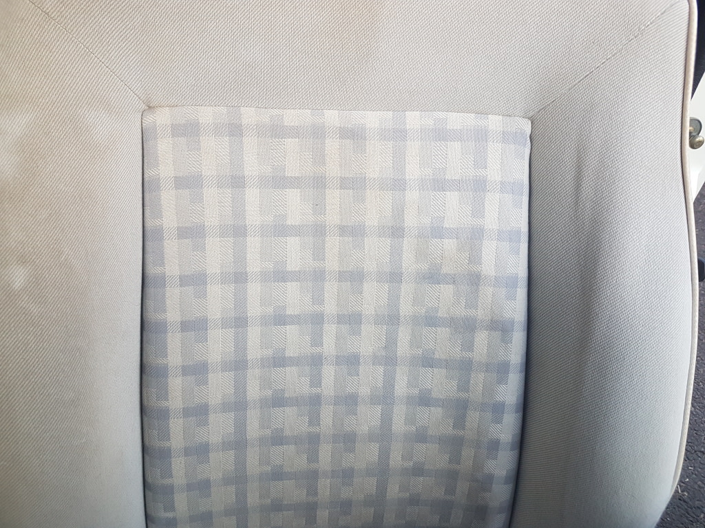

I'm having the golf fully restored and I'm going too have all the seats and door cards renewed,  I've been on west trading website for the material but they don't seem too have it , I've emailed them. I was just wondering if this is the original cloth or has it been re upholstered at a later date. Any advice would be greatly appreciated many thanks.. 20180830_185831.jpg 20180830_185837.jpg 20180830_185915.jpg 20180830_185826.jpg 20180830_185815.jpg

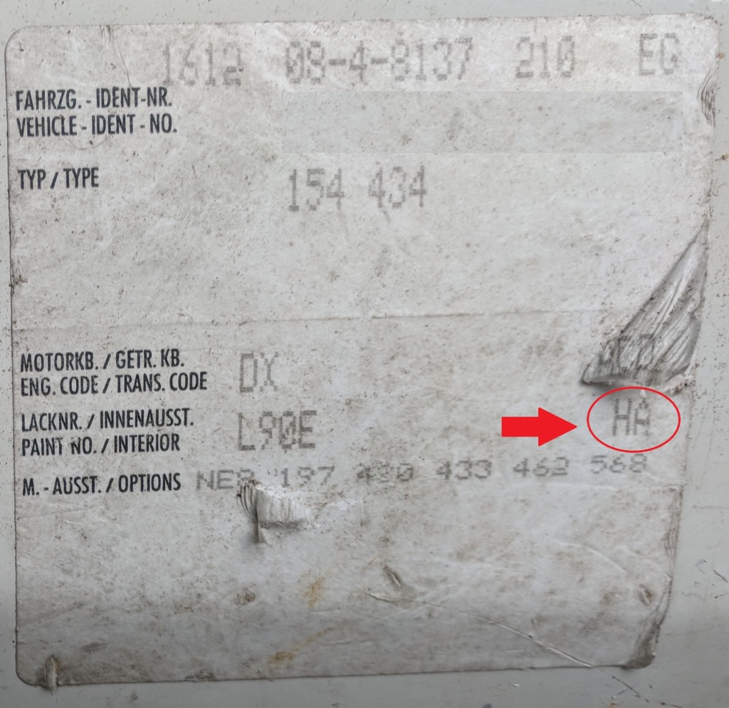

If you still have the sticker in the boot check the code for upholstery.
See the pic.
Then try to find the original fabric using Briano1234's link. It may be the case yours are not the car's original. In my case it is Lasky White for example.
However I believe yours are listed under "white" section rather than "grey". See codes: FD/CY
