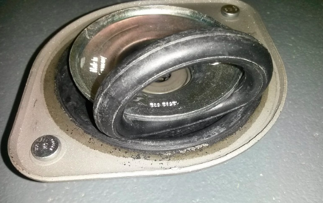

Also I used to use 3m Window weld on the lower side of the mount about a week before the jog to extend the life of the mounts, I also tack welded the studs to the bottom of the mount, I had 2 new mounts spin one of those as I was tightening it and I was left with the issue of not being able to get it off, or tighter.  I ended up worming my arm up the strut tower, and getting my wire welder up through there to hit the heads of the studs, I had used a pair of Vice-Grip pliers on the studs nut to keep it firmly up as I welded it.  So now I advocate doing it prior to installing any new mount.

But since then I have another easier trick to fill the gap.
Some guys simply buy these exhaust rubber straps:
Dimensions:45 x 69 x14 mm
Opel, FIAT, SEAT
OE Referencenumbers: 4387294, SE138115514A, 1473296, 1134920082, 852707, 852712, 8952181
EAN: 0741187265140
Then insert them between the bottom of the mount and the metal to fill the gap, doesn't need a week to two weeks to fully cure as the urethane 3m window weld does and does the same thing by limiting travel of the front mounts
