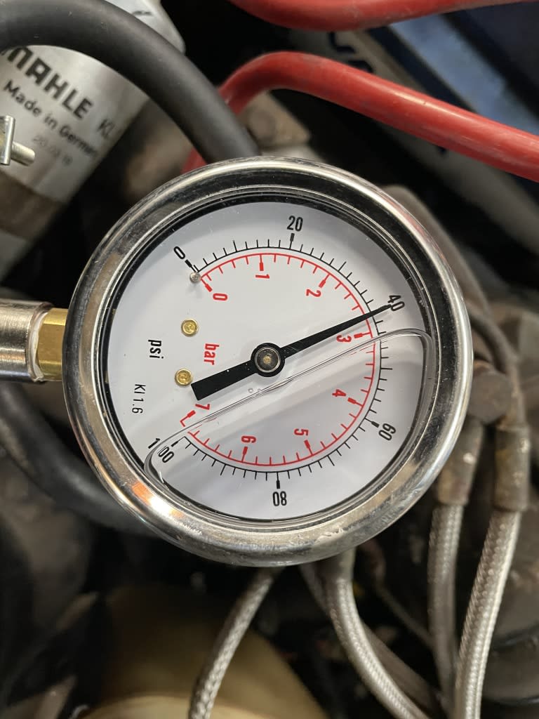

Hi guys and gals! I need a little advise from any K jet gurus out there please….
I've had my 83 GTI tin top for a little while now, in that time I've been working through all the usual issues with success!
The car has always driven really strongly, although it had rubbish cold start!
So a couple of weeks ago i started to investigate what the problem might me? I've tested the time out switch! OK! I've tested the 5th injector! OK! I've tested AAV! Faulty! so replaced with a good unit I bench tested before fitting! I have stripped and cleaned the WUR and rebuilt it with a new rebuild kit off eBay! Now the car starts first flick of the key!!! But sadly is undrivable
Start the car and the gauge reads zero fuel pressure??
Close the tap (even only half way) to check the system pressure and she stalls? instantly!!
With the engine off is the only time the fuel pressure gauge registers any pressure @ 40 psi which holds strongly which I know is telling me the the accumulator is working fine.
Now seeing the only part I've messed with on the fuel side is the WUR I've had it apart again and all looks good???I Don't know if the WUR rebuild kit had any faulty parts???Any sound advise would be great as this is the last hurdle and I really want to get out and enjoy my GTI.
Many thanks Mark.
