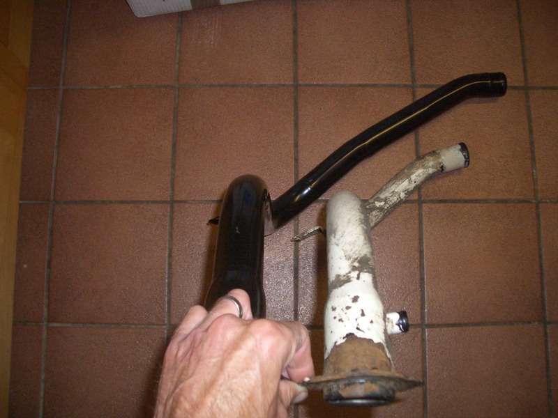

Make Sure you get the right filler neck as cabrio ones are different to tin top car, there is also 2 sizes of fuel tank, larger tank cars have a space saver spare wheel and a shorter filler hose, smaller tanks have full size spare wheel and a longer filler neck.

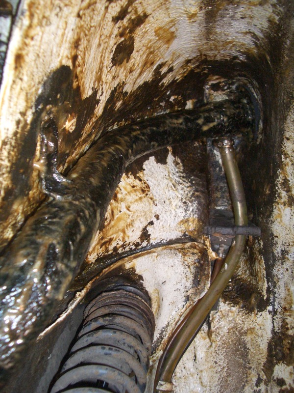

Picture to see what I mean.

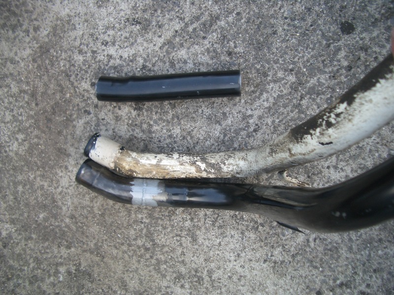

This is from my 1988 Gti with a larger fuel tank, I used a tin top filler neck as I heard it will fit if you just cut is shorter but I found out it does not, I had to get it cut and welded to same angle as my old one.

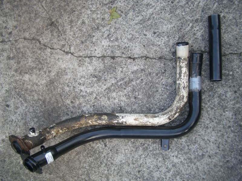

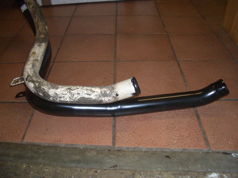

Tin top filler neck with a smaller tank next to my old one.
You can see the angle is different

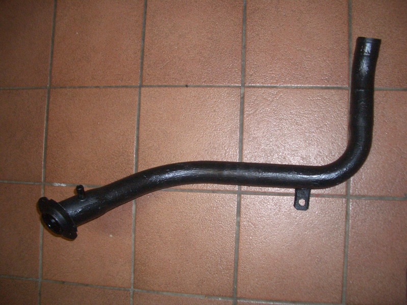

Cut and welded the end back on.

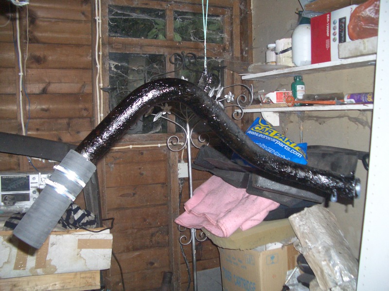

Painted with epoxy mastic then stone chip paint then underseal then waxoly.
Test fit before final painting.

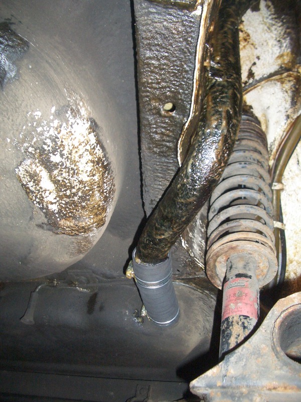

Finish the underseal.

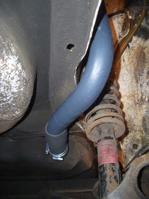

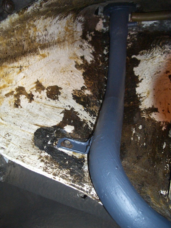

Fitted then the waxoyl.
My car is a daily drive and gets used all year round so that's why I went a little bit over the top on protection.
