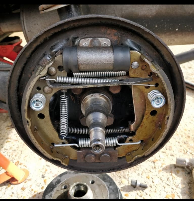

I had an MOT failure on my campaign 3 weeks ago due to rear brake imbalance. I basically bought a set of new brake shoes and spring kit and replaced the whole lot. Gave the drum a good clean and rub with sand paper.

It's a pain removing and installing the springs. I managed to do with a parrot nose, pliers, screwdrivers. After doing the job I decided to invest in spring pliers for future. Hopefully will relief some frustration doing such jobs. Here is the link on eBay but I haven't tested it yet so don't know how good they are.

Remember to push the wedge up so the shoes squeeze inwards before putting the drum on. Also make sure the wedge is in correct orientation, the small round shaped extrusion should face the rear, this stops the wedge slipping through the assembly.
