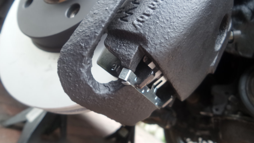

hopefully a yes or no answer
Standard 239mm discs and gti calipers.
Is the front of the caliper (closest the ground) meant to tuck under the carrier or not.
No matter that I try it wont squeeze under but all the bolts do line up.
Thanks guys, see pics below
