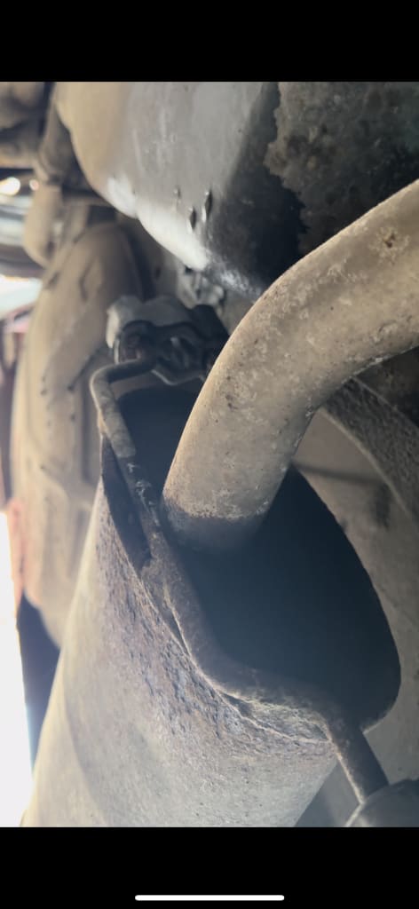

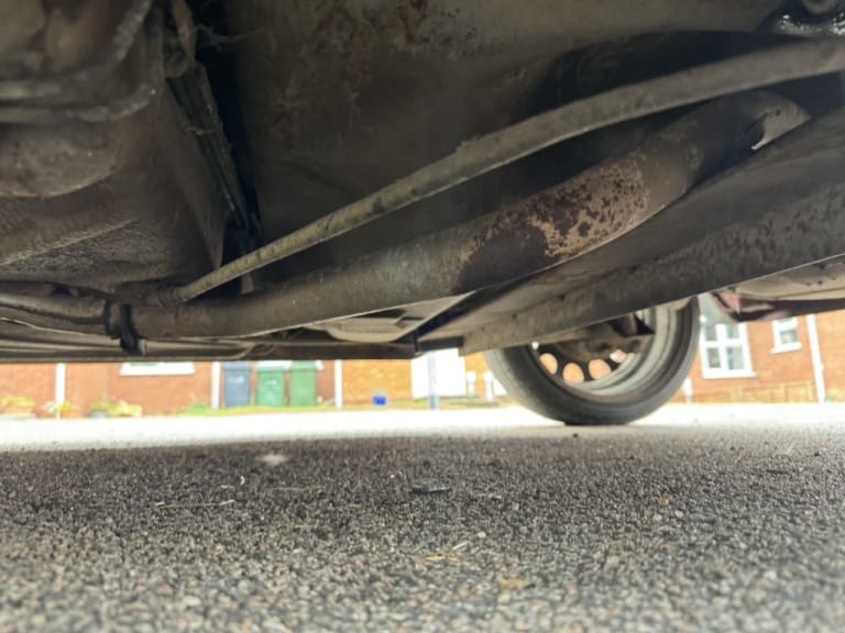

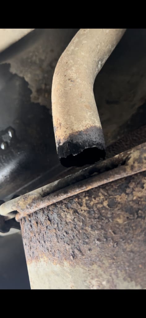

Hi,
1985 Mk1 Cab 1.6L GL
I am wondering if anuone can point me in the right direction with finding a replacement back box/rear silencer.
Mine decided to completely detach itself from the backbox and so now sounds like a monster truck…
I have looked breifly myself, but seem to be many variations.
TIA
C.

Thanks, just wanting to replace the rear section.
Just seems to be multiple versions for different years etc. So wondered if anyone knew of anything exact so the mounts were in the correct position.

I do believe that you will need to replace the Piping between the resonator, and the rear silencer.

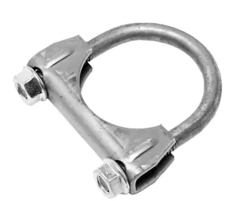

If you do decide to go the whole route, then may I suggest that instead of using the old fashioned silencer clamps (We call then muffler clamps over here.).
That tend to Crush Pipes and distort them making them a PITA to remove or re-use piping with out a Pipe expander to straighten out the kinks.
OLD style

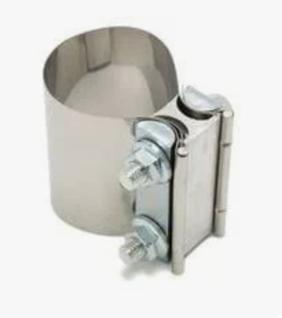

NEWER style

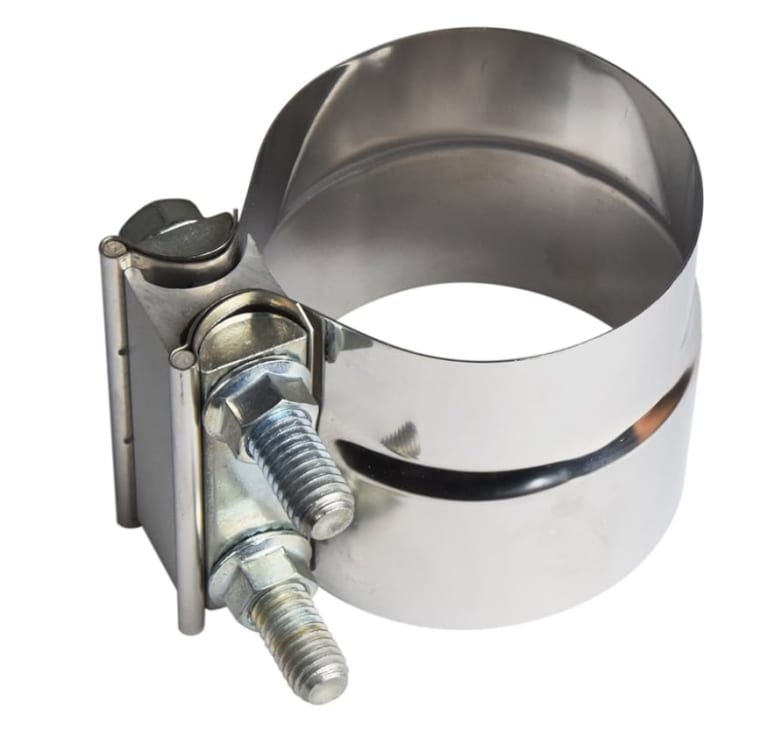

Use SS band clamps as they come in different sizes and can be bought to reduce diameters as well.
They clamp circumference of the pipe with no distortion
and the pipes can't wiggle loose or leak when the pipes are cut square and butt up to each other.

Is the reason in having to replace the pipe work between the resonator and back box due to not being able to buy a replacement where the pipework is welded/attached to the back box and the first connection is before the resonator as it is now/originally?
If the replacement silencer has the feed in port that is sufficiently long enough to be attached then no but your pipe looks to be a little brittle (weak) and maybe not last long.  Just my observation.
