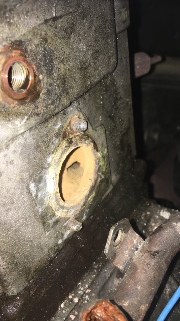

image.jpg Change of plan! Found why it's leaking! Part number / part name please 😂
if that is the rear plastic flange on the engine (year and type of engine) as 1989 CIS…. that is a bigger help.
https://www.vwheritage.com/026121144e-coolant-flange-with-o-ring-vw-spare
to flush and back flush a system see my how do I do that thread in the archive section how-to's briano's 90 cabbie post.
Or click the link in the signature.
That looks like the badger, mine is metal tho! However one of the bolts just snapped 🙈
Great
Oh no that's not good… if you cant get the stud out you need to drill very carefully and re tap the thread in the head.
When fitting new bolts back in smear them in copper grease and it will stop the aluminium to steel bolt seizing together which happens over time.
Good luck and let us know how you get on…

Do I remove head to remove these bolts? They are flush now as flatting and using adjustable sapped them further
At bit of a cross roads
I've only ever had to fix a bolt on the front water flange, access is not very good on the side of the engine and you might find it tricky to get a drill in there and make sure you drill the stud straight (use a good centre punch) so not cause any/much damage to the head.
I know it's a pain but if it was me I would take the head off but you will need new gaskets etc.
Have you had the head off before?
If not might be a good time to change valve steam seals as they go hard over time and check the valves, valve guides, cyinders etc…
Up To to you really?
Perhaps others will offer advice etc….

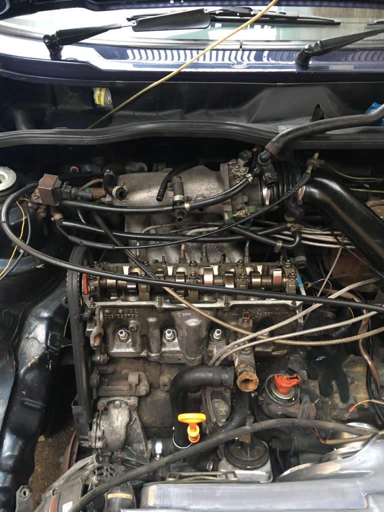

Don't forget to get new head bolts as well as you can only use them one and use the proper tool to remove the bolts, I think it's a 12 sided spline tool but can't rememeber….
I did buy it to learn about cars after all lol
Yea got the spline tool, had enough for one day tho tbh 😂😂
Will keep you updated.
The plus sides that once head gasket replaced and cambelt is done (luckily the one I bought I hadn't fitted yet) I've pretty much replaced all the big boys. Oil pump was one of first jobs. I'll get water pump too as might as well get that done now too.

I was thinking this, it has only done about 18k since it had head gasket, skimmed etc according to previous receipts  so unsure whether to take it all that far. Will see more when it's apart but I couldn't be arsed with it any more today.
Got a few days hol to take before April so might invest a couple into her
It should be alright then, I'm surprised they did not remove the flanges before getting the head skimmed etc…
At least you can have a good check inside the engine when it's apart.
I smear a little high temp grease over the ends of the metal flanges when refitting the rubber coolant hoses as this seems to slow down the pitting/corrosion and makes it easier refitting/removing the hoses.
I also use ready mixed coolant as tap water is not the best when mixing coolant, I use the blue stuff that needs changing every couple of years.
