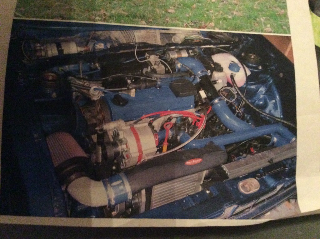

Anyone know anything about this rolling shell just bought.  Hopefully saved

I little bit of work needed there…..
Odd place to put the fuel filter when the engine was in there, right next to the heater blower you would not want any fuel leaks there, nice big hole into the cabin for fumes or flames!

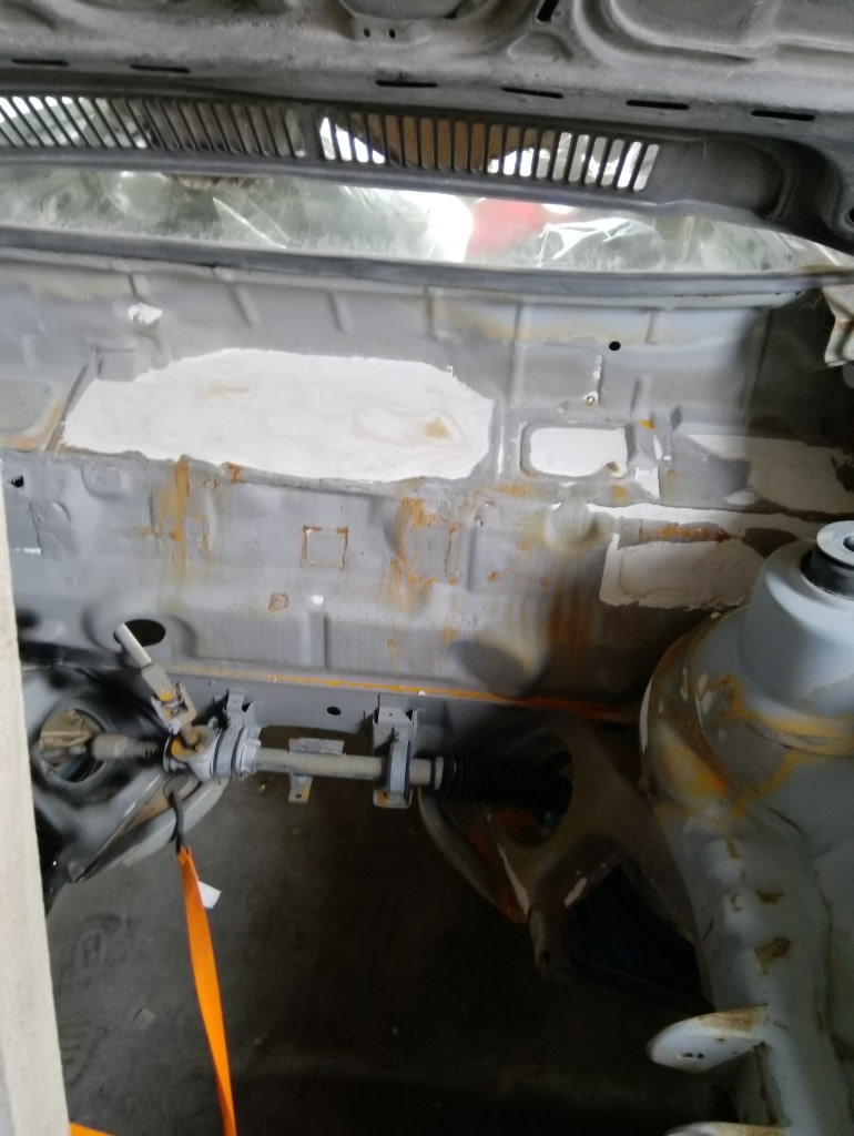

Strange in the lasted pictures the scuttle has been cut out..

I've bought it how is in last photos
They tryied smooth bulk head
Not sure what going do with bulkhead they wrecked it I think

I'm just sad bulkhead being hacked no.id number anymore      Going get bit plate stamped and welded in somewhere

I'm just wondering how to bolt in steering coloum since bulk head being smoothed no holes in sight
Don't really want weld in coloum
I'm doing conversion from mk4 golf gti
Got coloum and frame from that do I just fit this

Made start today blasted bulk head try sort out IMG_20190614_174827.jpg IMG_20190614_174821.jpg IMG_20190614_174817.jpg
Started putting bulkhead back in to car
Little bit now now I've put holes back in bulk head fitted mk2 golf heater box
Door post repaired where hinge was chopped off
Power steering rack bracket done and fitted
Mk4 golf servo fitted to bulk head with clutch cylinder
Was bit of pain with the mk4 golf adjustable column fitted
Mk1 golf fuel tank modified take mk4 golf gti tank unit
Mk4 golf full harness just about all in
It's bulk head what took time to repair I add photos later date
