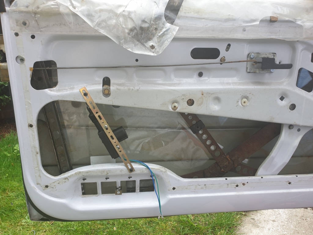

I also fitted it with a cheap £10 central locking kit so it locks and un locks doors, linked into headlights via relay so it turns them on for 10 seconds on arming as well as flashing all indicators to show it's armed and illuminate driveway.
Also as it used the interior door light switches (with diode soldered in) it illuminates that on unlocking like modern cars - and if you want (I don't know why you would) you can link it to start the engine from a alarm button without you in the car????

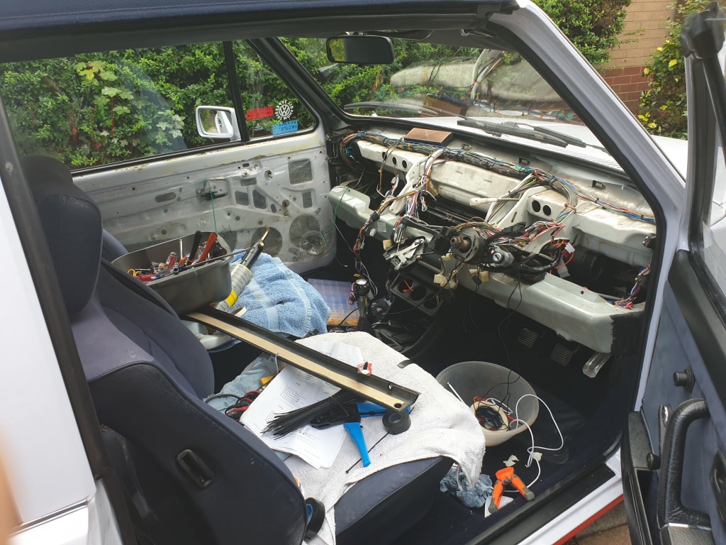

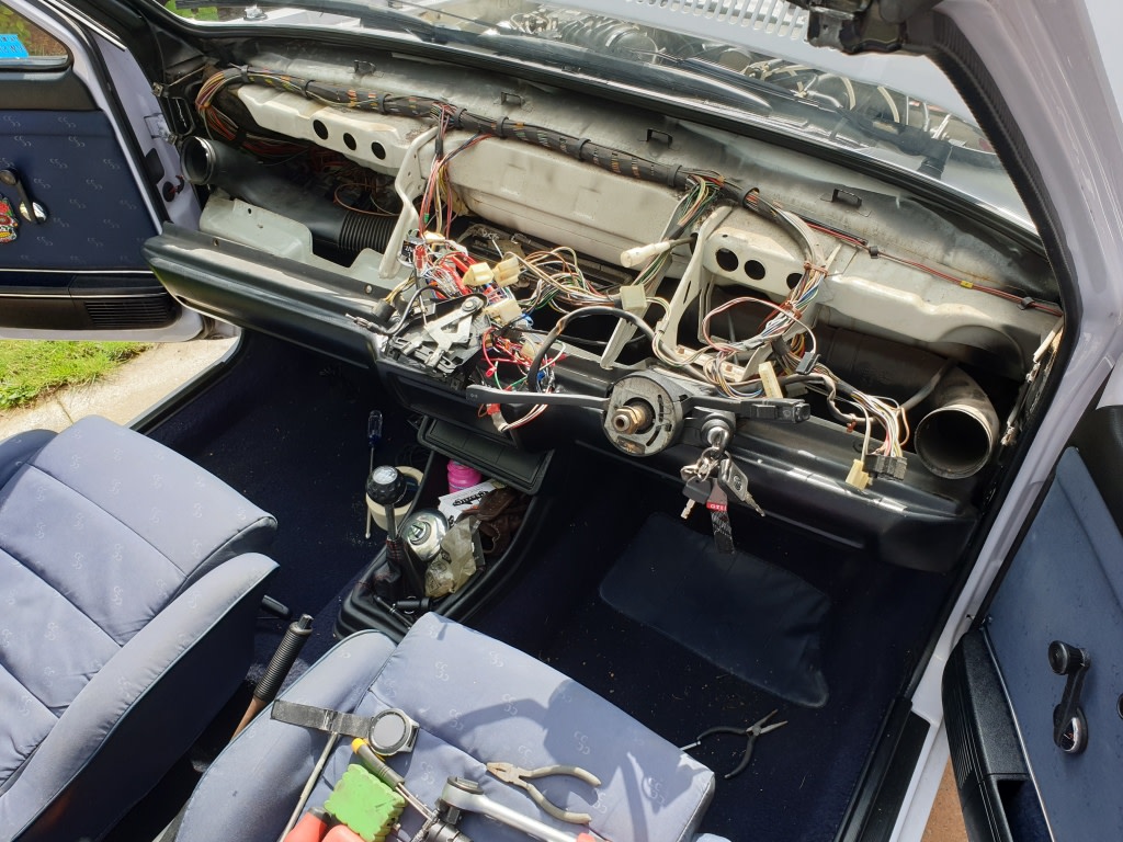

Get the dash off and it's a doddle to fit, the only difficult part is you would normally want to cut into the starter wire to immobilise but he'll it's a thick wire carrying some juice so I left that alone and as I have 2 fuel pumps - the lift and main cutting one of those does nothing as it will still start (on my one at least) so that leaves a few other options or use both immobilisation wires for each fuel pump or double them for the starter but risk blowing the unit - Or go for coil, injectors, ECU etc.
