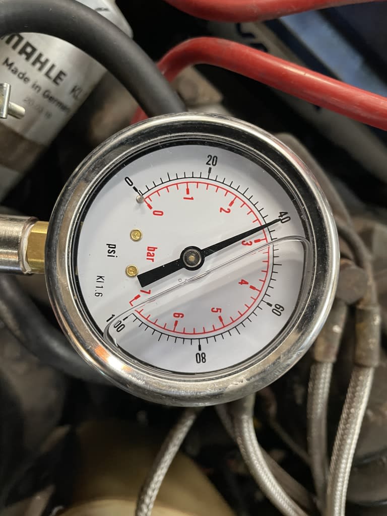

Hi guys and gals!
I need a little advise from any K jet gurus out there please….
I've had my 83 GTI tin top for a little while now, in that time I've been working through all the usual issues with success! the car has always driven really strongly, although it had rubbish cold start!
So a couple of weeks ago i started to investigate what the problem might me? I've tested the time out switch! OK! I've tested the 5th injector! OK! I've tested AAV! Faulty! so replaced with a good unit I bench tested before fitting! I have stripped and cleaned the WUR and rebuilt it with a new rebuild kit off eBay!
Now the car starts first flick of the key!!! But sadly is undrivable
Close the tap (even only half way) to check the system pressure and she stalls? instantly!!I
With the engine off is the only time the fuel pressure gauge registers any pressure @ 40 psi which holds strongly which I know is telling me the the accumulator is working fine.
Now seeing the only part I've messed with on the fuel side is the WUR I've had it apart again and all looks good???
I Don't know if the WUR rebuild kit had any faulty parts???
Any sound advise would be great as this is the last hurdle and I really want to get out and enjoy my GTI.
Many thanks Mark.

After being pointed in the right direction by paceman it was quite easy!
leaving the pressure testing kit on the car I removed and stripped the WUR again!!! lol
I then drifted the post that the bi metallic strip attaches to, up until it was almost flush with the WUR casing!
Then I rebuilt the WUR again and reattached the fuel lines but left the power supply disconnected and left the WUR off the engine!
Whilst the WUR was resting on the front panel on a bit of timber!
I then started the car and the stone cold control pressure shot up to 3.7 bar, I got one of the lads to steady it and using the right sized drift I tapped the post back down very carefully until I had 31psi (2.1bar)
I then plugged the power supply back into the WUR to start heating the bi metallic strip.
after several mins (the fan kicking in and out a couple times the fuel pressure settled at 51psi (3.5bar)
I then checked the system pressure and had 73psi (5bar)
With the the engine off it held 40psi for over 20 mins
set the O2 and happy days……….
