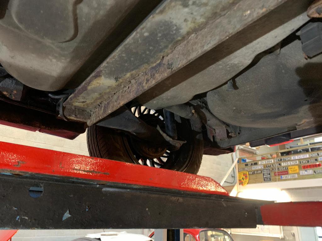

I'be had a good look over the blue one and it has a bit of surface rot - though the price has moved a bit to reflect.
Its the value I'm just not sure on.

Worth it?
Getting it right properly is well over a Grand.
Did you check rear window frame for rust?
The engine bay looks original as you can see the waxoyl VW coat them with.
Front suspension top mounts are shot and need replacing as there is a big gap between the metal and rubber.
The rear parcel shelf in the picture of the boot has started to lose the carpet as you can see the staples and this is usually a sign that water has been getting in so feel along the bottom of the metal window frame for rust.
