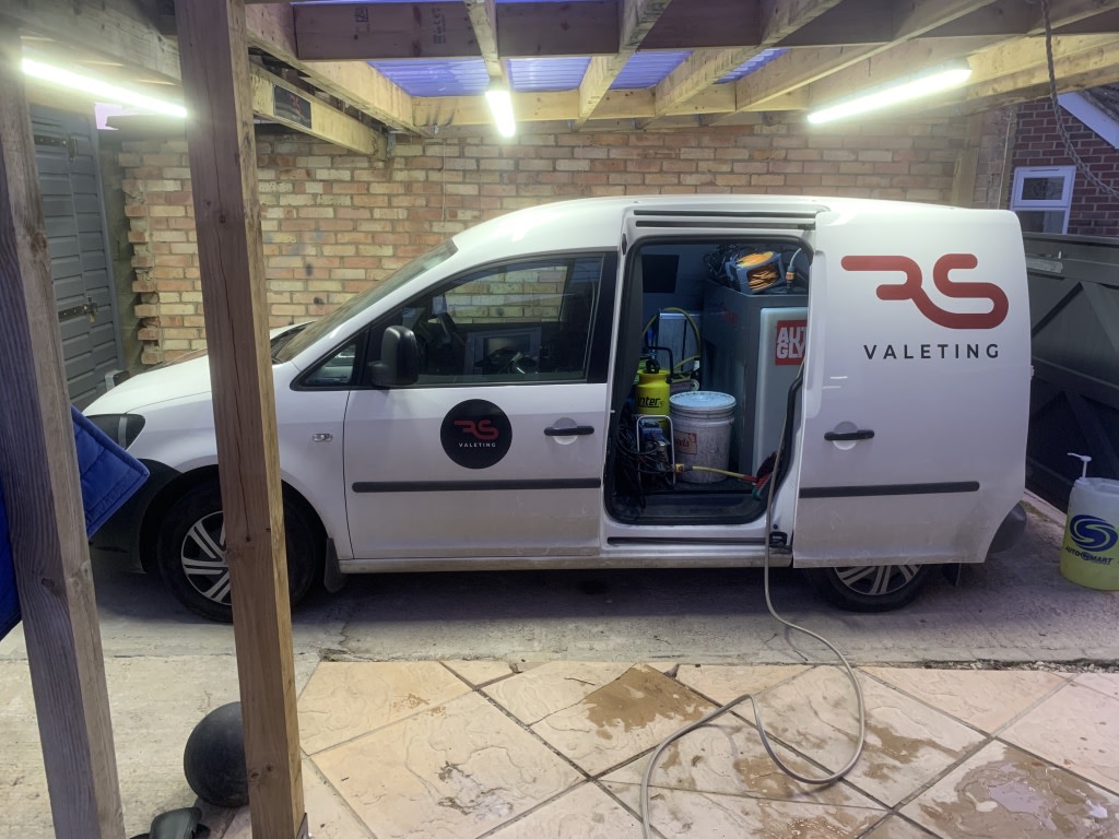

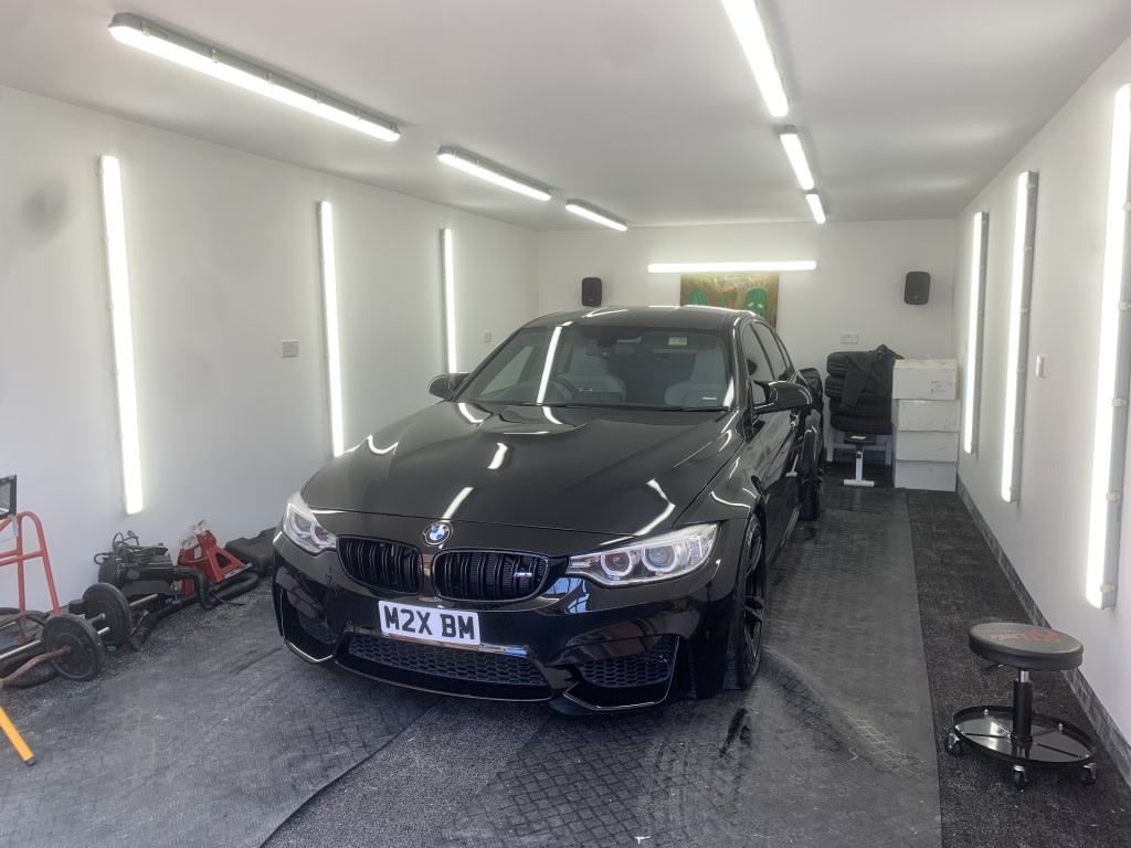

No planning or regs required….. that car isn't mine btw…
Wooden garage build
I don't have any photos of the outside of it. But I have some of before work was insulated and boarded out.
