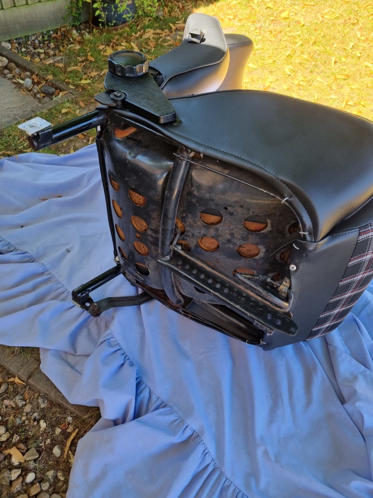

These are of my current seat

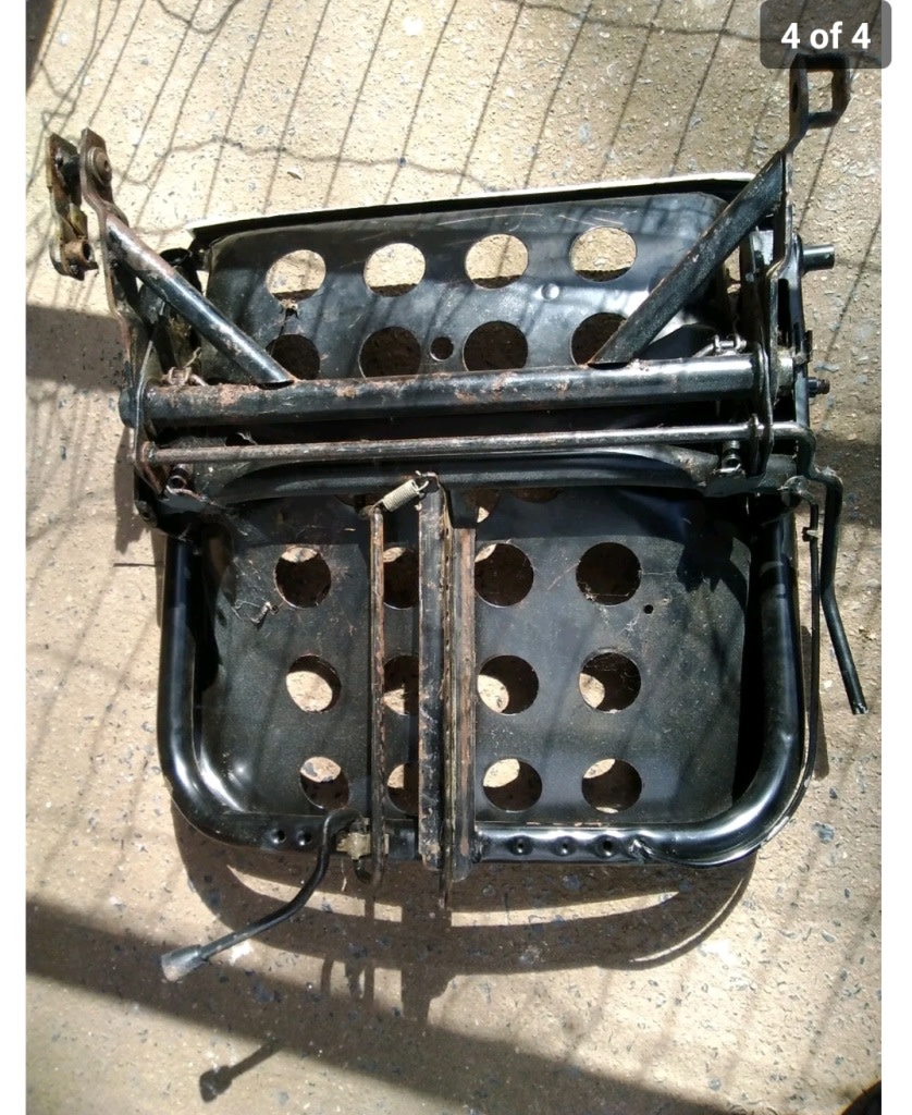

This is the 'new' scirocco base
