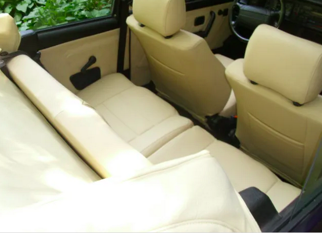

I am sorry for being a bit blunt earlier. I have had the occasion to re-dye, re-spray a variety of seats, over the years.
I cleaned them with TSP, and other detergents. I have then had to re-soften the vinyl to make it totally devoid of all soap residue, with Spray Brake Cleaner on a rag.
I resprayed the seat with VHT and was well pleased with the result that lasted about 6 years before it started to wear off. Not like the MG's seats that I re-sprayed back in the 70's that tended to flake off….(lesson learned) even tho it was scrubbed clean. Paints were not very good back then.
Here are some during an after cleaning shots of the boot cover, that I cleaned, then hit with brake cleaner to get all the crud/ dirt, and residual protectorant out of the grain, I had to be quick as if left on too long you can melt the vinyl..
I then used VHT Saddle Tan to re-spray it to match my new Mohair top and interior.
(only shot I have to show the boot)
I am well pleased with the result, and hope it lasts as long as the Seats I re-sprayed for a car show (Bright white).. did get Second Place that year..
