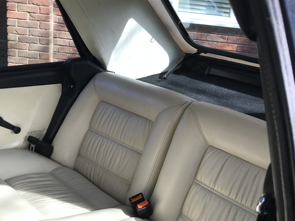

Pictures of the interior, reading everyone’s replies (which I am entirely grateful for  - thank you) it would appear that the seats and door cards have been replaced at some point. Would really like to get it back to it’s original state. Anyone know of any one who specialises in re-trims?
The exterior is in good condition - original paint and engine is fine, low mileage, Previous owner kept it off the road for a large part of its life.
thanks again for the responses, really helpful 😀 7ED4DA10-563C-456E-8C98-F64A1FD4F5F9.jpeg ECB09ACE-C383-40F5-A9EC-44E6C9315483.jpeg 2394E909-A5F6-4898-BEFA-D0D19286191E.jpeg
Your chairs are pretty nice even if they aren't what it left the factory with.
I'd probably pick up some beaten ones, gather foam cushions from passenger seats so they are like new and then present them to a trimmer, sell the old ones to make some money back. You'll be looking at the best part of a grand!

The seats etc look to be in great condition, if I was you I would find another complete interior and get that re-trimmed then sell the complete leather interior, looks like it's come from a Rivage and they do sell at a premium as it was an option when new so not all cars had it fitted…. That is if the seats etc are leather?
See if anyone breaking a car has a complete set.
The main problem you will have is getting hold of the original material as I think is no long available..?
