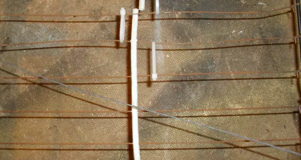

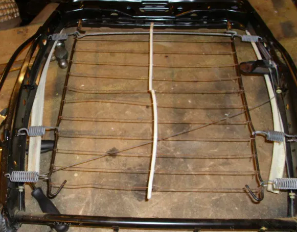

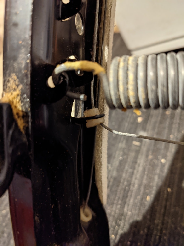

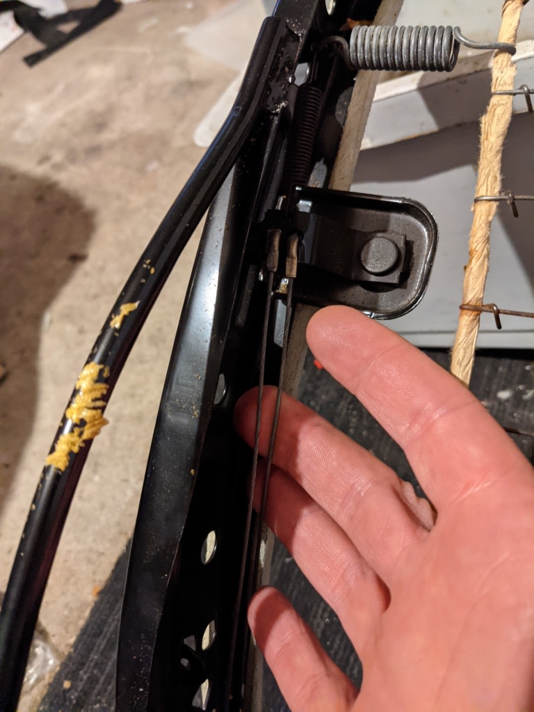

I have got some ideas.
One problem is while at garage they pulled the cable off so I do not know where the top part is to join.
Some of the diagrams are good but if anyone one has it I would like to know the way the cable goes from the top to bottom middle.
