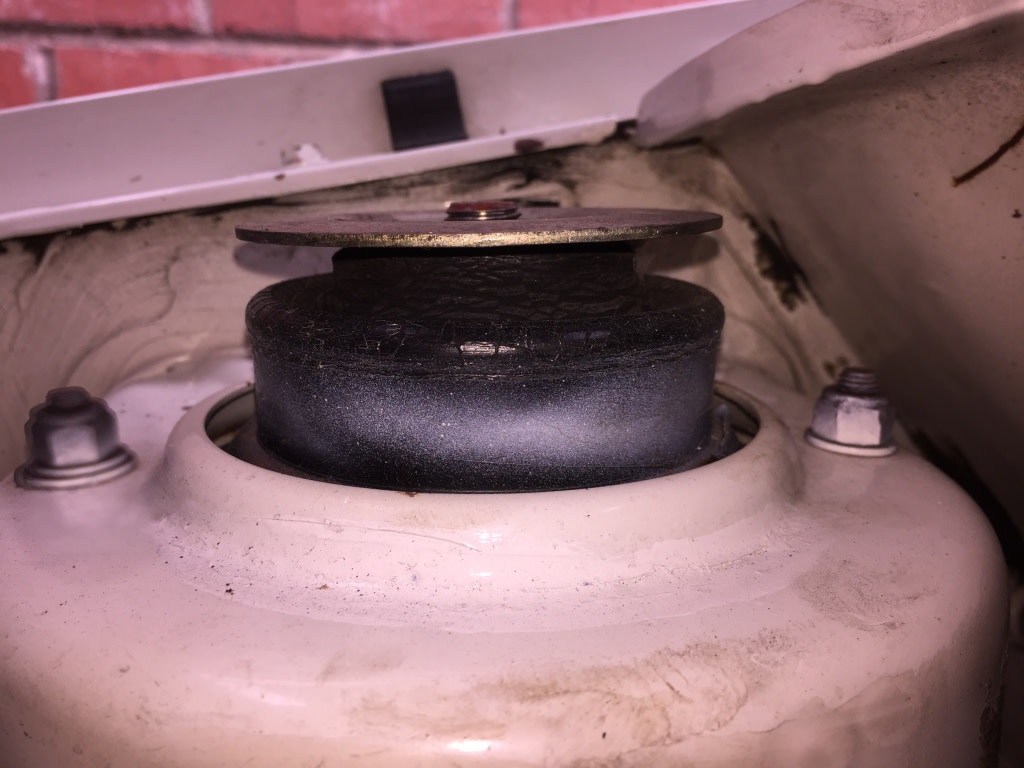

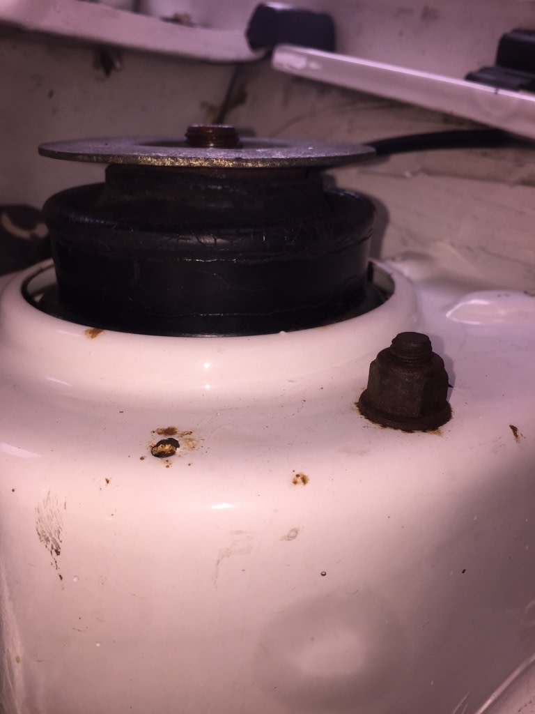

I would check the fronts first. You should be able to see the if the top mounts are okay. Briano has a good guide on it: https://www.volkswagenownersclub.com/threads/replacing-front-struts-and-mounts.32171/
I think the dampers have to come out to check them properly. Push the piston all the way in and watch how long it takes to come up. Something like this should give you an idea:Briano1234 said
This is a bad mount:
Good mount Bad mount .

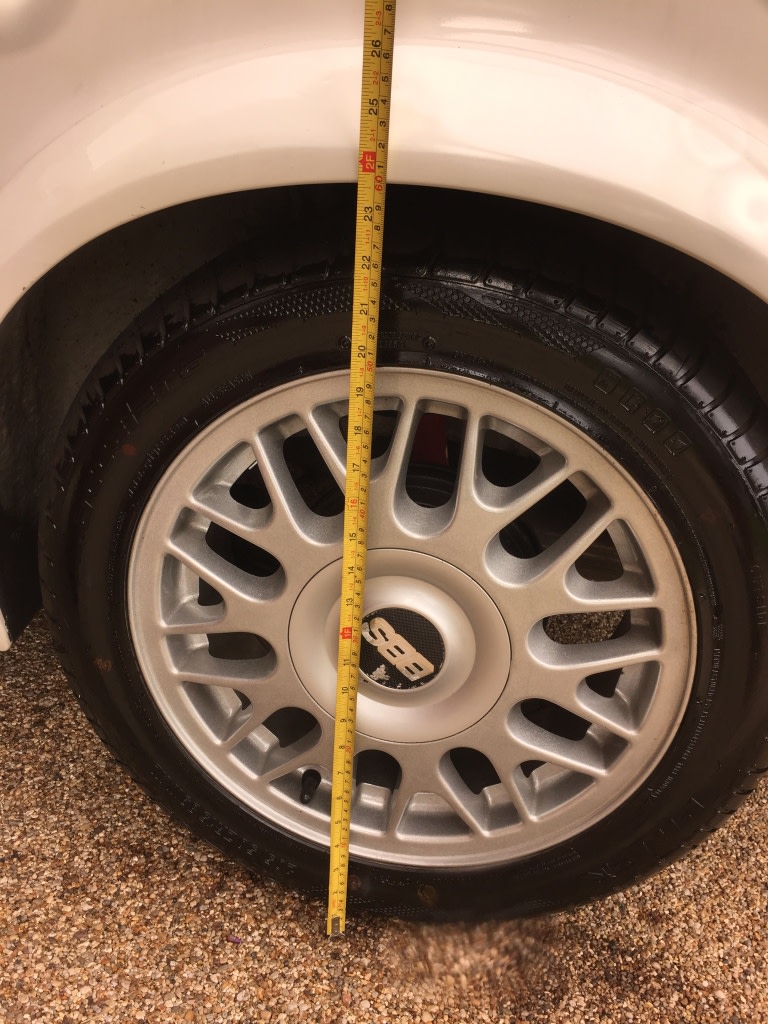

The tiny avatar pic is definitely not stock height, can you post a bigger pic? Or measure it (eg from centre of wheel to the wheelarch) for comparison.

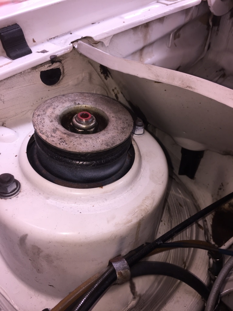

Thanks for all your help guys I really do appreciate it' I know nothing about the coilovers or suspension ride height so will shortly measure the distance from the floor to the wheel arch, is there a way to determine the ride height so I could change the front first?

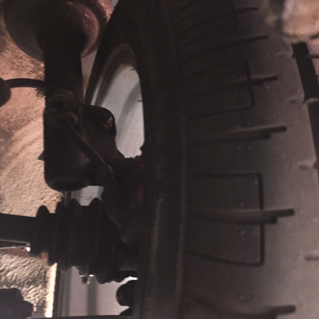

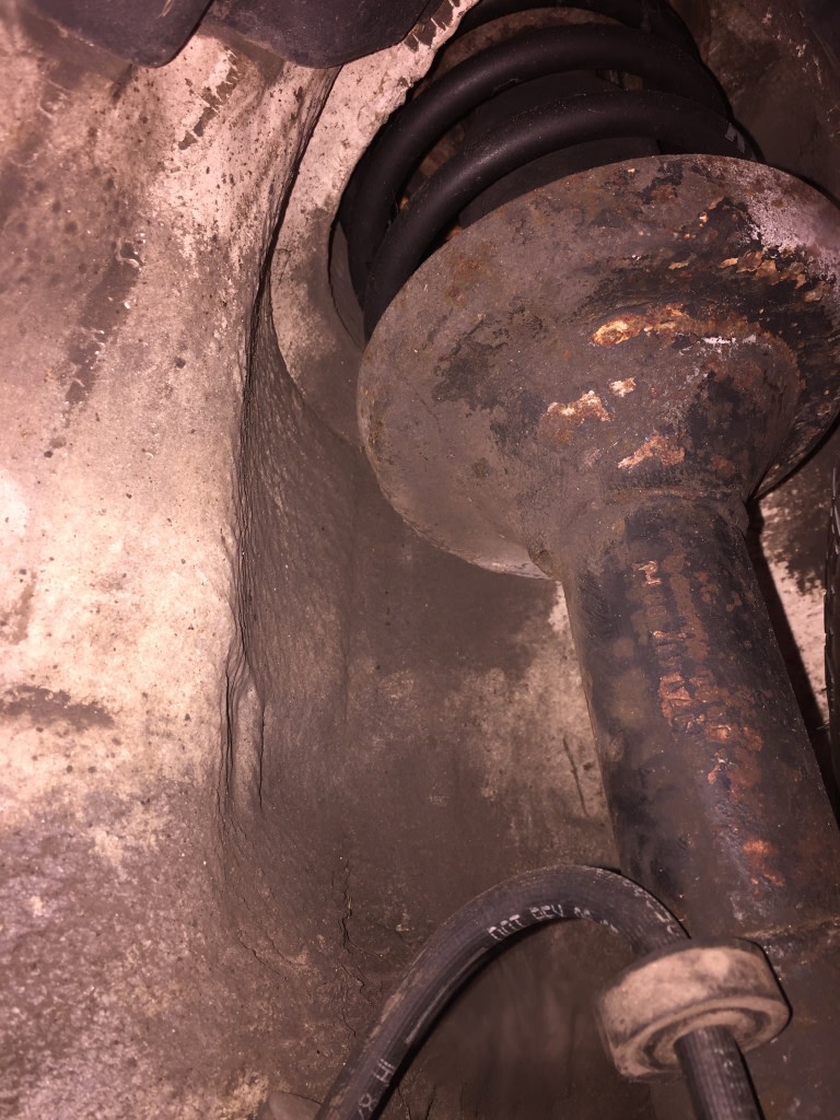

You need to also measure centre of wheel to wheel arch. Get some pics up of the suspension and someone will be able to advise if its standard or coilovers or looks totally worn out
Rears look pretty standard springs or dampers.
I'm not sure what the standard ride heighst are and haven't got easy access to my Cabrio at the moment to check mine, but don't look that lowered as prev said.
Top mounts look worn and stretched.
if I feel potholes that thud through the car will the top mounts do anything to better the ride,
as i said before pal havent got a clue how to check the springs/struts or mounts
