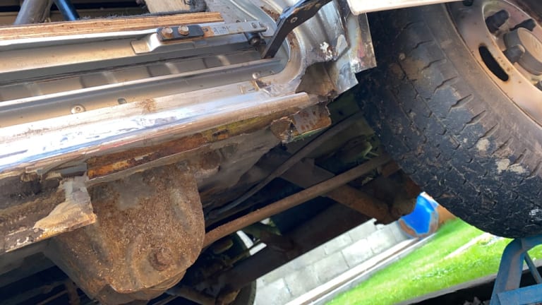

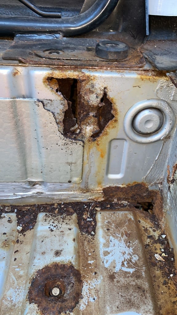

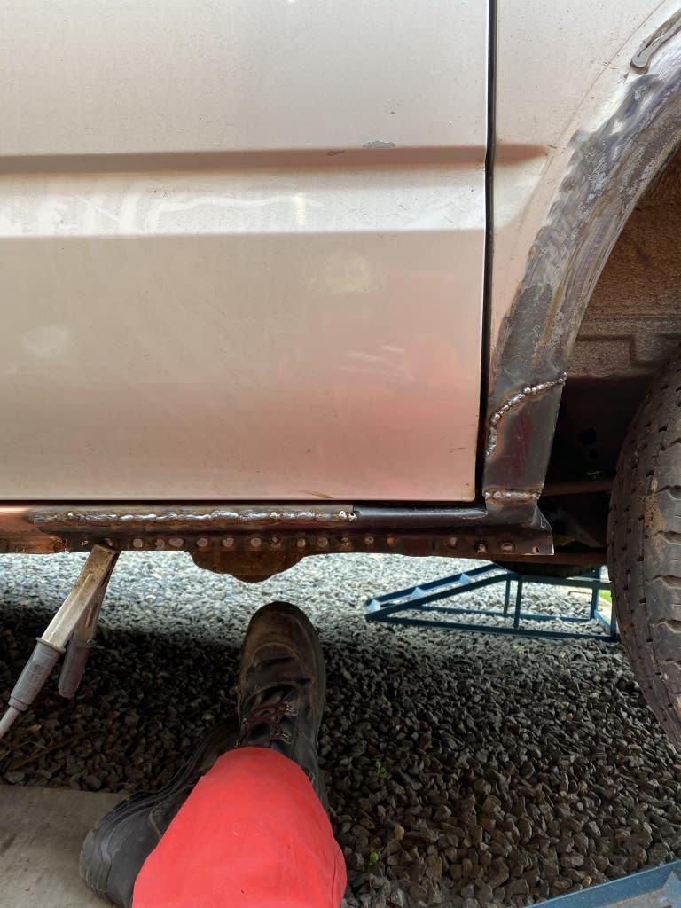

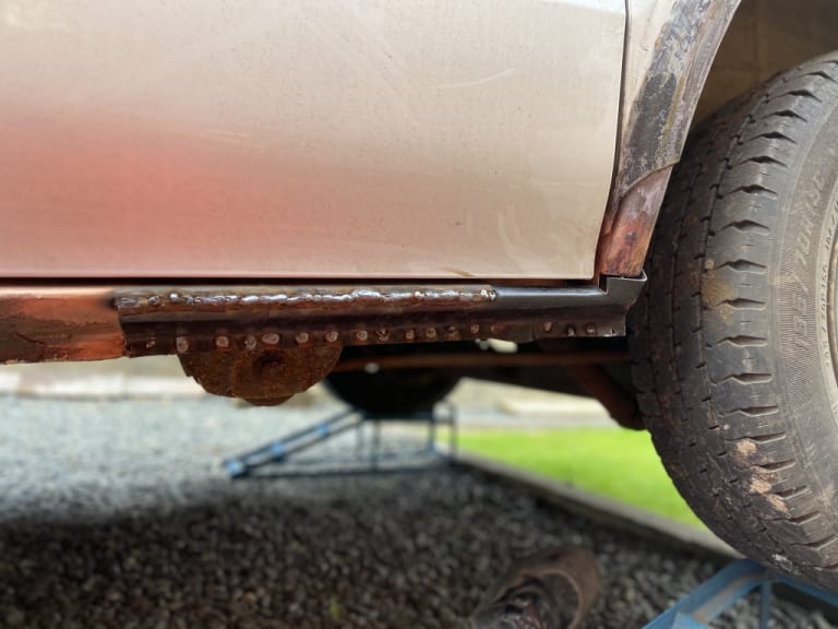

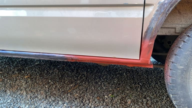

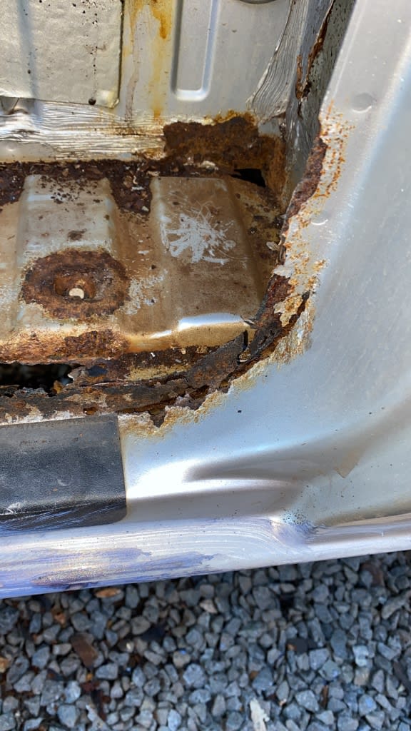

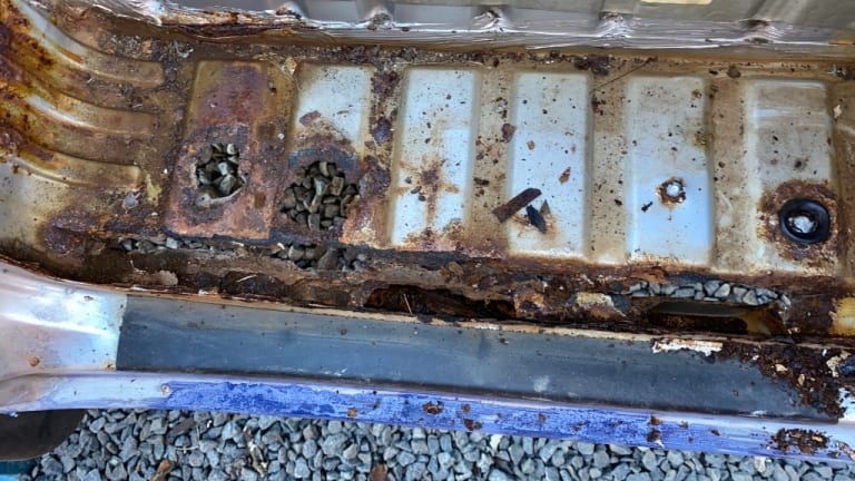

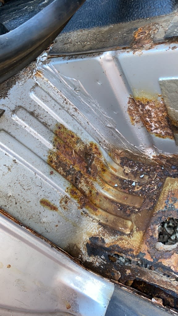

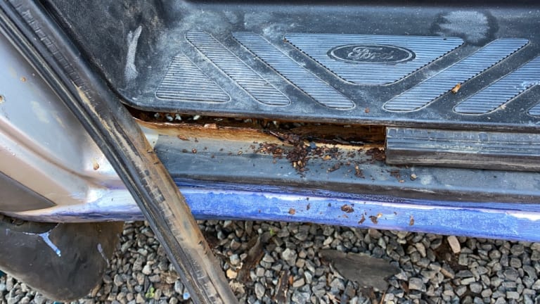

Brings me to my latest issue after 10 months of owner ship .. there was a Very small rusty hole appeared in the side loading door sill.. so I thought best tackle it while the where is still good..after cutting a heap of bad metal out and making bits for it I was happy and thought, I will clean up the whole sill and make a tidy job, get some stone chip paint on it.. well I found the side step was not intact…. got the parts ordered for this so will be the job when I get back… more reasons why the Mk1 build it slow and stop.
