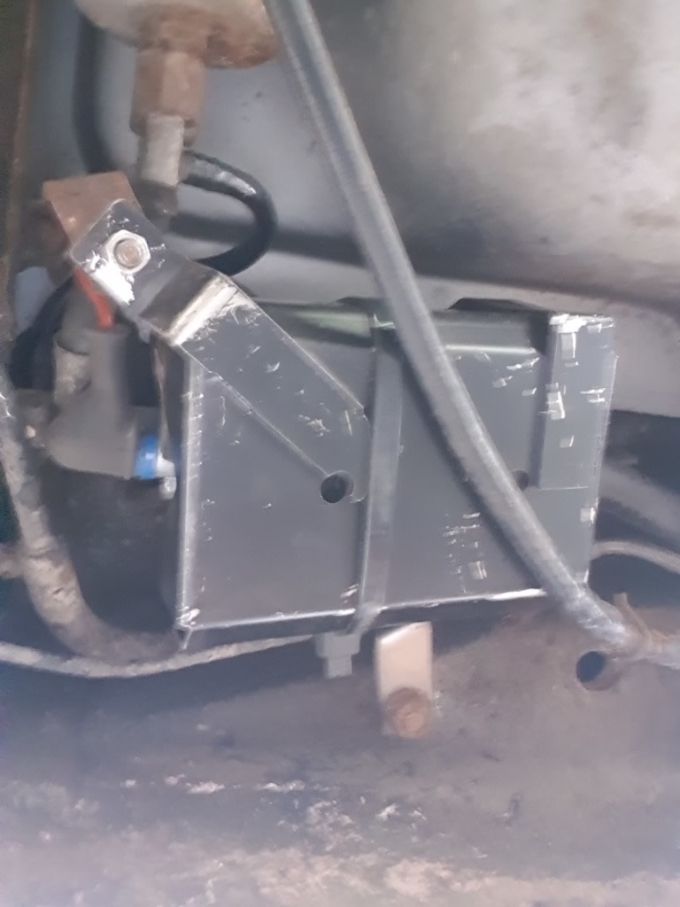

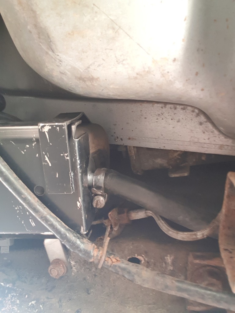

Found a couple of old pics doing a bit of a search so a little bit of a better idea but any additional help appreciated

Early-1800 said
The inlet to the pump from the tank looks a bit of a stretch and the jubilee only just hanging on?
Yes sadly since it's not a peirburg pump the inlet is slightly bigger making pipe tight to fit.. the jubilee is clamped on the raised flange..and hose is trapped. I'm more concerned with accumulator to pump pipe that sits at terrible angles but was same with original too. It's a while since changed fuel tank so cant remember if was different. Before… it's working at the moment and not whining.. have 2 rubber bushes fitted instead of 1 now.. maybe when I get chance I'll put up on ramp and align better.. but I'm not rolling around on ground pulling fuel hoses anymore.. 😗

Early-1800 said
Looking at the pics will the entire pump/housing not move back a bit?

No mate the new housing fits to the bracket close to accumulator..and then over to the bolt point near inlet ,the bolts are seized accumulator side without grinding out the bracket remains where was for last 27yrs.

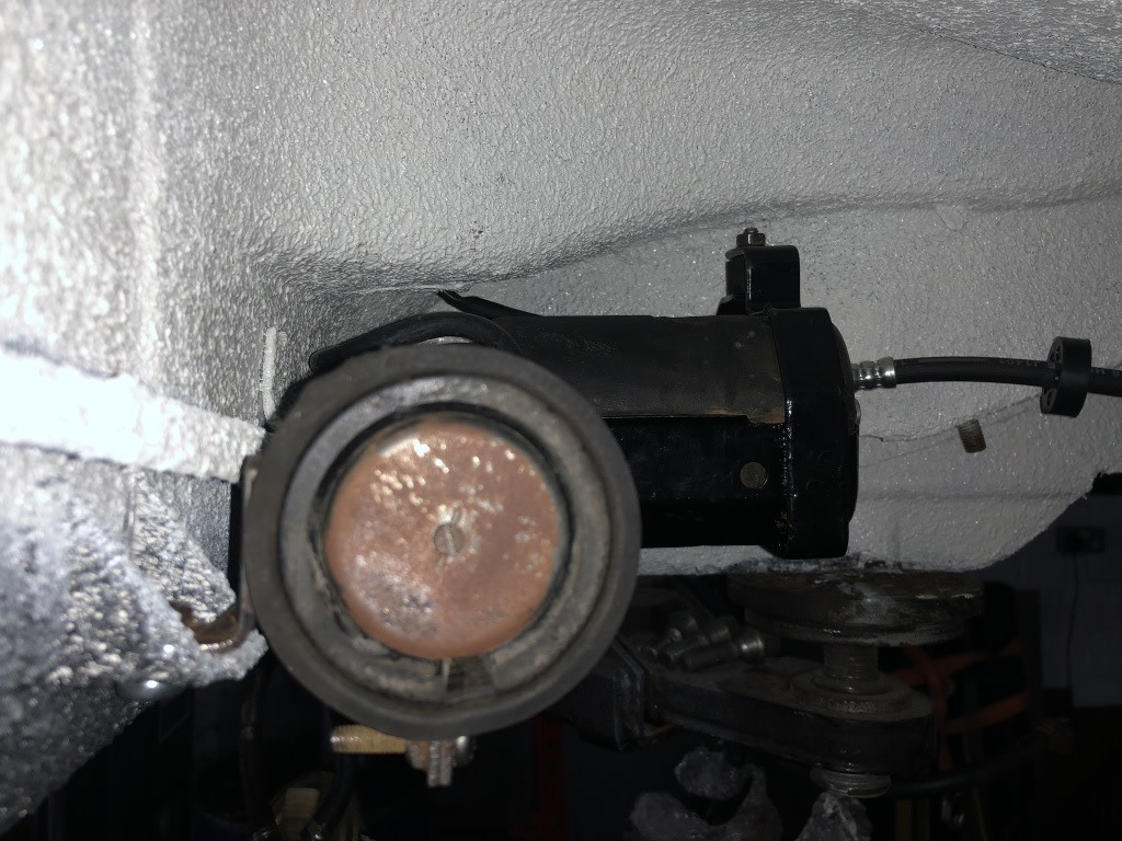

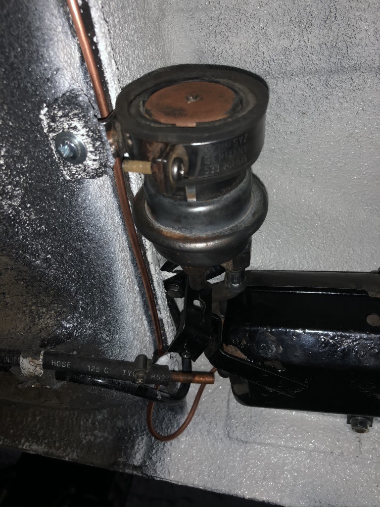

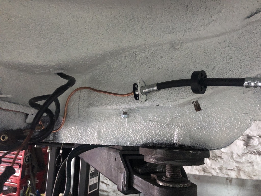

Took a bit of head scratching and re-positioning but got it back in place and ready for the fuel tank tomorrow and rear axle.
So a few pics of todays work - And a bit of brake pipe flaring for nice shiny new brakes!
I would try changing hoses too, unless you know are new fuel ready…. i'm aware mine are due to be changed.
