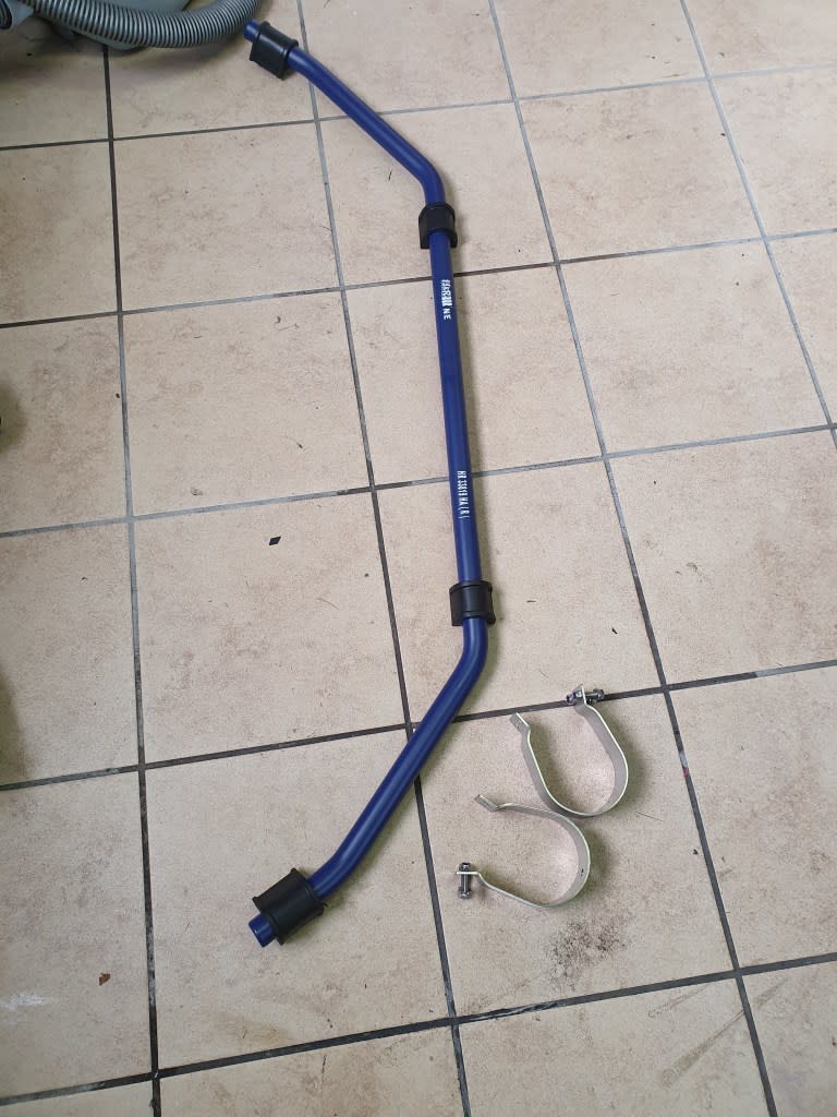

Has anyone fitted the H&R sets as looking at the images they are different in how they fix to the axle and front wishbones as it looks like they bolt on and not sit in the standard bushed clamps?
Plus is anyone running them and how good they are??
Thanks, Andy
Taking them off is one thing, getting them back on is another…. Hint they are easy off and a pain to put on….
IIRC I took the ends off first as that unloads the things, but getting them back on was a bother, but I had the tool, a 2 foot Square Steel tube, that I could slip over the end to get it into position. One side will be easy as it isn't under load, it is trying to PRY the other side in that is the usual issue I have found.
