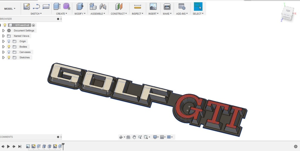

I did think of cutting some out of aluminium on my CNC, spraying black and sanding back to expose the face metal but i am not the best at cad and its a massive faf to get the speeds and feeds set up + i am having a real pain in the bum getting the draft right on the letters for the cabby badges!
