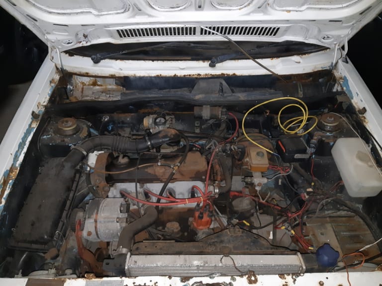

Ps your top mounts are knackered
mark1gls said
There should be a engine code on the engine block just below cylinder 3 (1 being near the alternator belt) it will start with 2 letters eg. FR……
Would this be it JB 716 172? Did a quick google search but didn't really find what I was looking for.

JB 51 70 1,50 4 10/82 - 10/83 CADDY
JB 51 70 1,50 4 08/77 - 12/83 GOLF
JB 51 70 1,50 4 08/79 - 02/84 JETTA
JB 51 70 1,50 4 08/77 - 12/82 SCIROCCOFound some info here JB 51kw 70hp 1500cc 4 cyinders and years fitted. What else did you want to know?
How can you tell from an image, please?

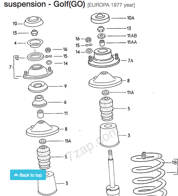

Yours in the picture above are different to Standard mounts and may the aftermarket solid version ?
I believe the mounts on the early cars are different from later cars so prob factory as the engine and VIN on strut top look like from an early car (the white one)mark1gls said

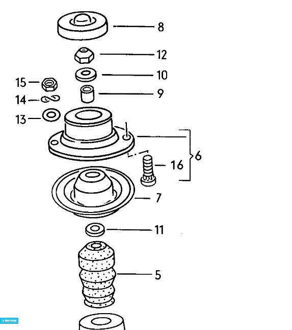

The metal plate is supposed to flush with the rubber, if you have a look at this thread you can see some worn strut mounts, if you can get your finger in between the rubber and metal it’s time for new mounts.
View topic: Front suspension top mounts - The Mk1 Golf Owners Club
1977 shows both styles.
83 and newer only one style is now showing and is more in-line as to what we see in later Cabriolets and mk1's of the 80's
