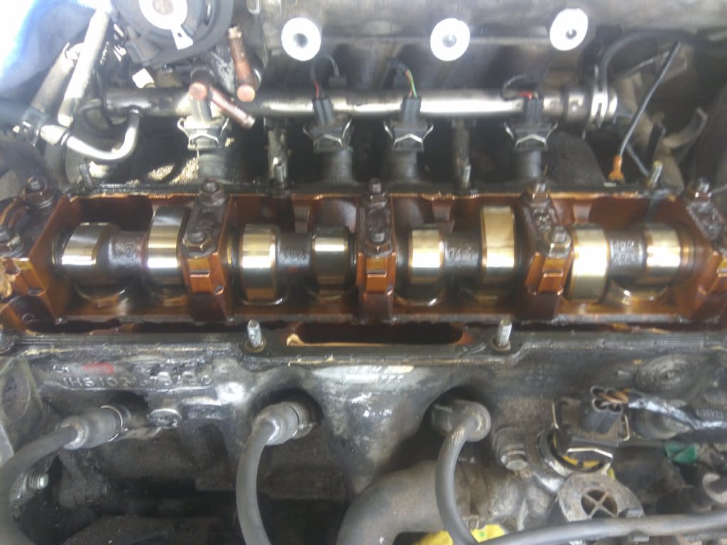

Thats what was fitted……

blans said
Pre 83 hydraulic. . Post 83 solid. :-)
is that not back to front?

Thats i a 2003 citigolf 16i ….
MOTY 2013
MK3 golf GTI heads have all 5 cam caps even with hydraulic lifters, I guess same is also possible for SA engine codes. we dont have so much experience with those over here.
