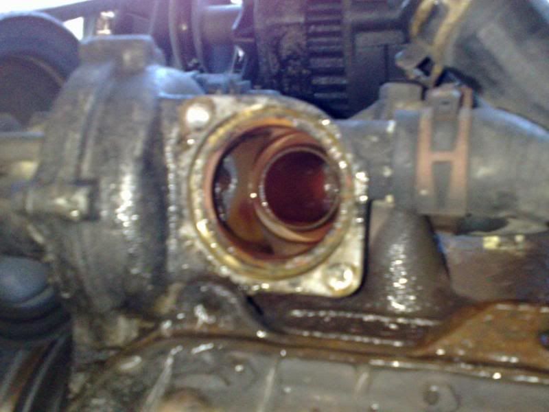

Water will pour out so beware, you have been warned. Chances are the thermostat and O ring will remain in place like this :
Again working from above use a screwdriver to remove the thermostat (the O ring will come out as well), there's a thin bar you can slot it through and lever against water pump, water hazard again :roll:

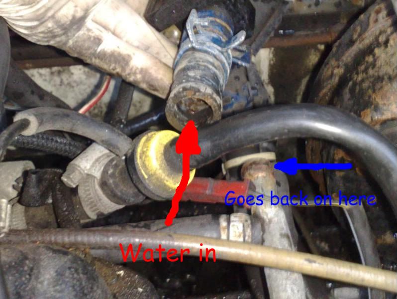

You need to undo the clip located top right nr rocker cover and slide rubber pipe off metal pipe. Make sure heater control on dash all the way over to the right (HOT). Once it's off flush through until clean water :
Water will come out from where thermostat was.
Then flush through from expansion tank until clean water
Again, water will come from where thermostat was.

Get your cardboard to lie on, then under the front you go. Locate O ring on elbow joint then sit thermostat on that (re-fit the correct way round see earlier pic), locate it back on the bottom of water pump and tighten the 10mm bolts. Nearly done
