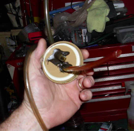

With a quart jar and a Mighty vac (I use a glass mason jar with a sealed lid, one of those Pasta Jars from the store works well too). Into the cap I have a 3 foot Vinyl tube that is about 1/2 inch above the bottom, and a 2 foot tube that is only about 1/2 to 1 inch from the bottom of the lid top. Yep a short tube and a long tube.
I suck out 3 quarts of fluid via the fill tube, Measure it.

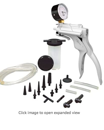

whats a mighty vac?

A mighty-vac.
Buy vinyl tubing about 6 feet that will go inside the fill tube, you have to get it to the bottom of the pan.
You make the collection jar and place the intake tube, the one that bottoms out in the collection jar into the Tranny fill tube, Where the Dip Stick is.
The last 3 quarts that you suck out, be sure that you short it by about 10oz or and add .25L of Seafoam…. drive it about a bit, then check the oil level after you get it hot…..in park with the engine running.
You attach the other end to the mighty-vac……(great tools to bleed brakes as well that is after you wrap the bleeder ports with Teflon tape as it will suck air through the threads.

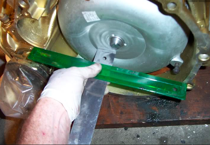

Torque convertor out of the tranny with the splined drive shaft.
Torque convertor strapped and measured ready yo go back in the car.
From the ATSG how to Siphon out the Torque convertor.
