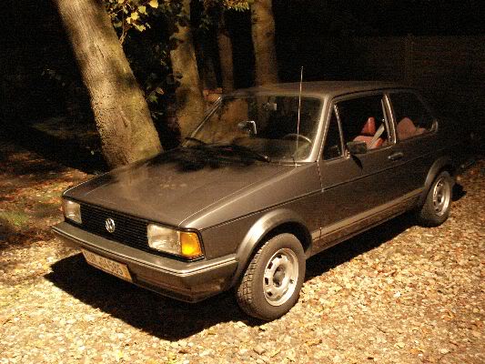

I got a lift to Newcastle airport, flew to Heathrow then onwards to Hamburg, caught the train the Emden and my pal who I'd made during my search picked me up in the car. He'd collected it for me from a couple of hundred miles south of where he lived. He even paid for it and I settled up with him on arrival. And to think my dad said… "don't trust the Germans!"
After a few days stay I then drove through to Amsterdam and caught the ferry back to Hull. It was a great road/sea and air tripWill get some pics up
It's all mine now!

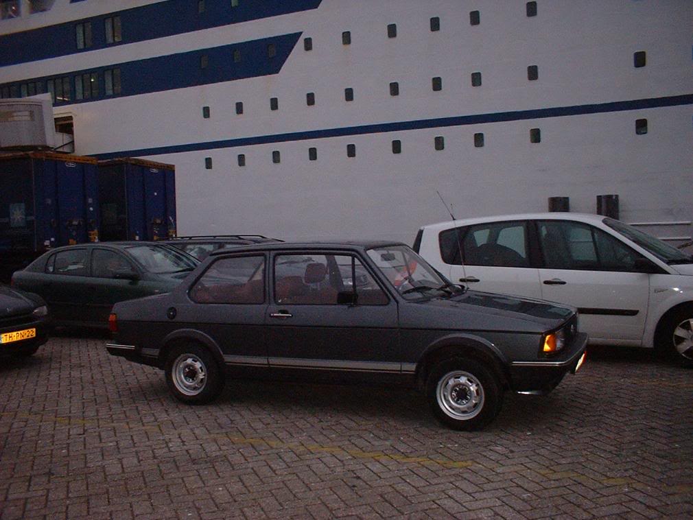

Waiting to board the ferry, slightly weighed down at the back with a set of ATS Cups & tyres!

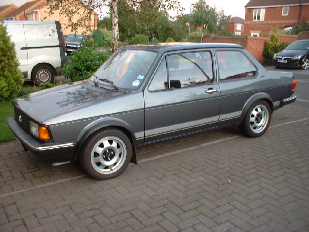

More recent pics…
Thomas is a mad, keen Mk1 Jetta enthusiast who was more than happy to help me out. We forged a great friendship and he remains a very good friend some 5+ years later. You may have seen one of his long term projects elsewhere
Aw your jetta looks amazing! And what an adventure! That's great that you stayed such good friends with Thomas. Do you have any plans to go to Worthersee 2014? Would be great to get a group of jetta going!

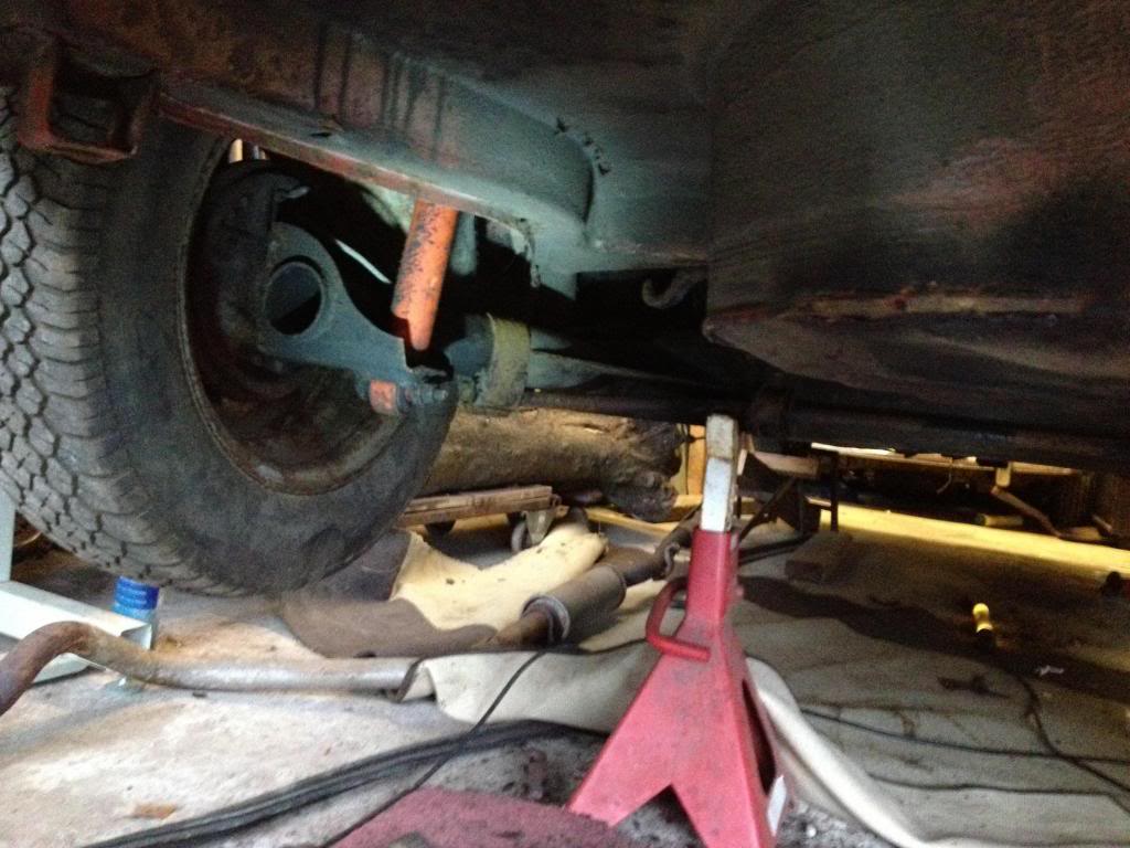

Finally got it up on axel stands during the week, in the process of taking the exhaust off atm - does anyone know if removing the central silencer box is an MOT fair? The back box is pretty wrecked as i suspected but would prefer to take out the middle box and just have stright pipe.
Loads of dirt and muck to get off before the wax oil and going to change the fuelines as well.
What you using for the fuel lines?

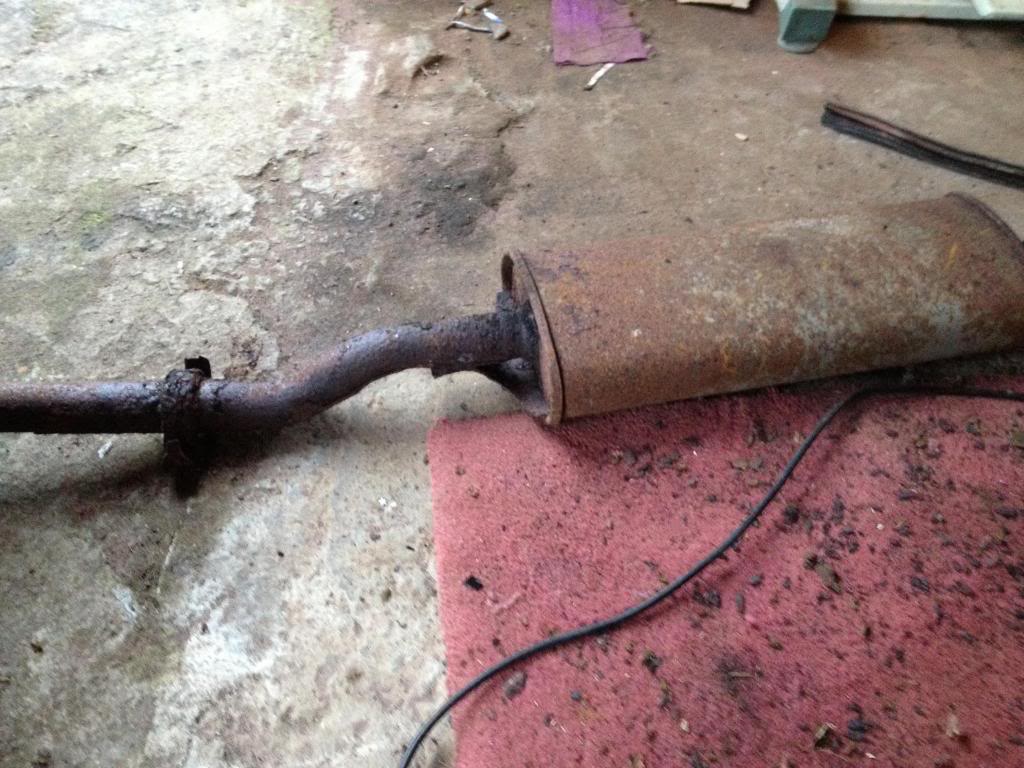

Just done under the boot/back end of the car today, got rid of the rust patches, painted it with a rust primer. Needs another coat then i'll do the rest of the underside before giving it all a coat of underseal rather than waxoil as that seams to be what was used on the car before and has done a pretty good job.
As you can see the the back box is a rust box - trying to find a good but not too pricey sports back box not not had much luck yet.

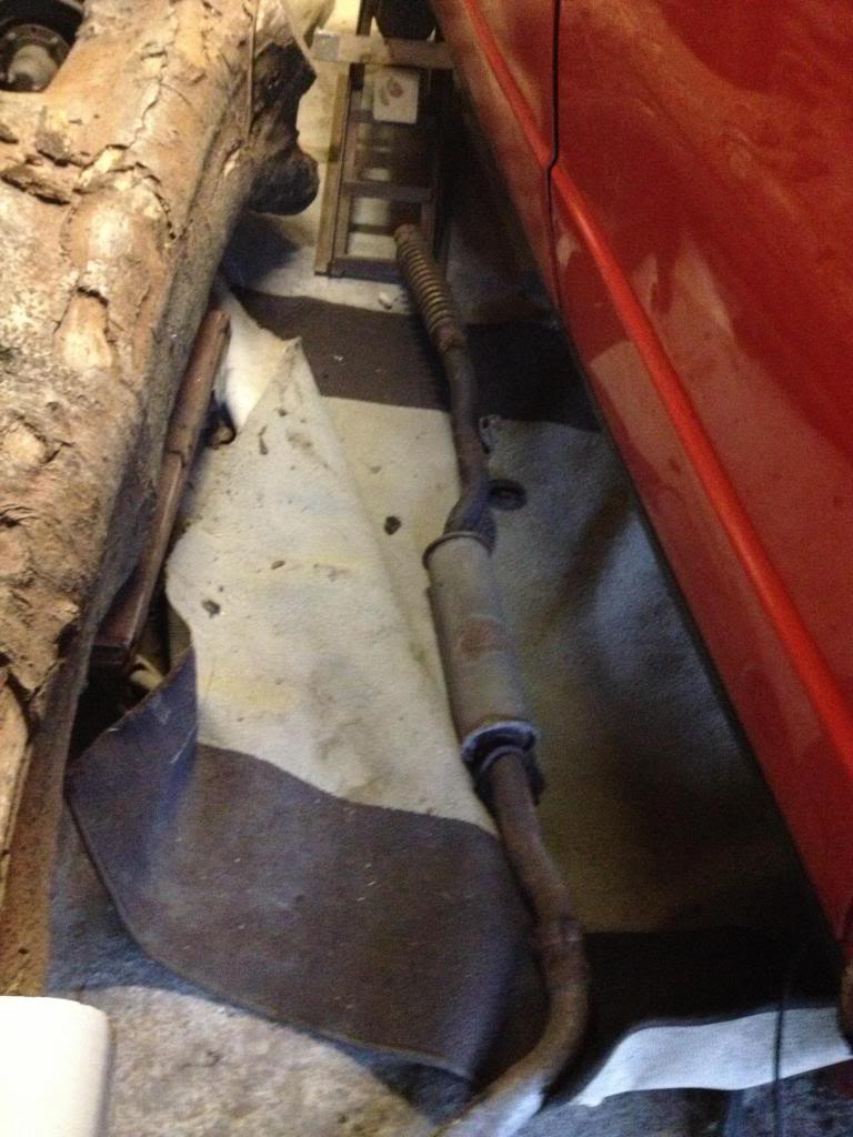

lots of space with the exhaust out the way.
The breaks are looking pretty bad - especially knowing they dont work - next task after the underside

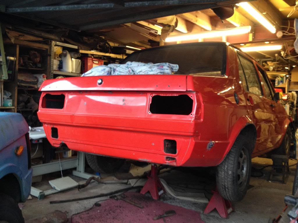

Also managed to get the badges off the boot for refurb. Started to paint one but looked pap so decided to mask them all off and going to spray them instead.
Have also got over my fear of going under a car on axel stands, lol, which is just as well cause im going to be pretty much living under there for the next couple of weeks lol.

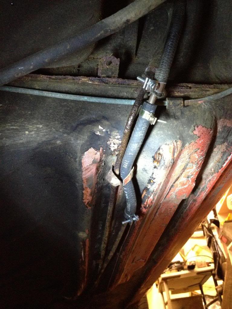

The fuel lines: well when we started it up to move it to my garage it had a wee hole in the fuel line which then snapped lol. Did a bodge repai with a rubber pipe which actually worked really well, but cant leave it. I've got a piece of copper pipe what i think will do it but keen not to take the tank off if possible.

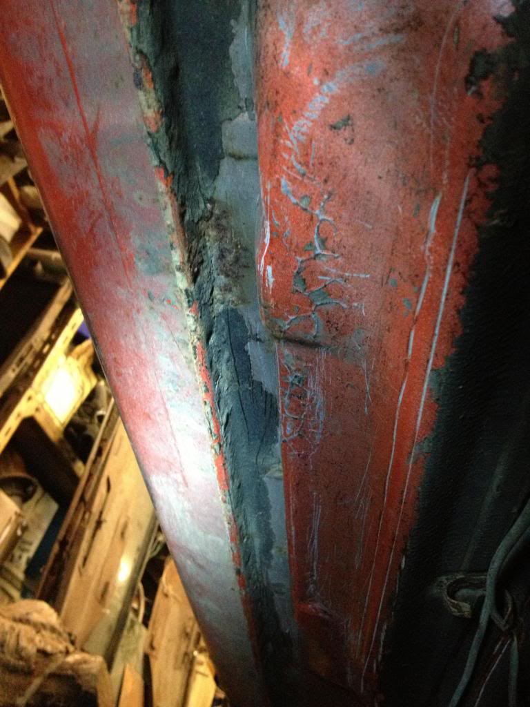

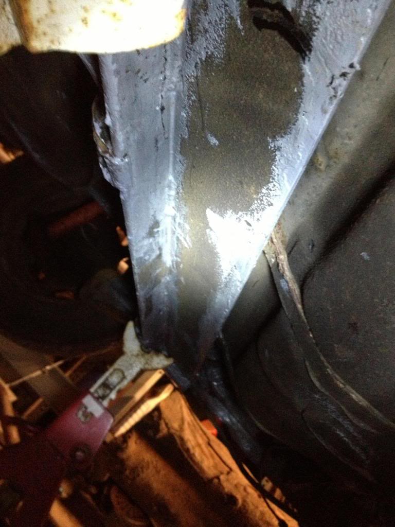

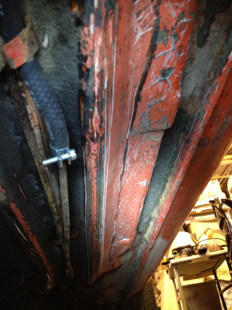

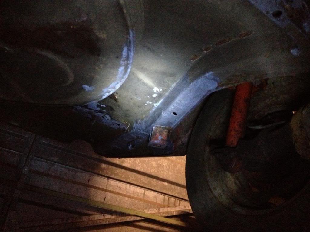

Decided i'd crack on with the rust coating and removal of any loose rush or underseal. Took alot of scraping under the cils but got all the loose bits off. Not much rust which is great, but someone has jacked it up a few times at each side and knackard the edging so need to fix that. Got a good look at the break and fuel lines. Fuel one should be fairly straight forward to replace but not sure about the breaks.

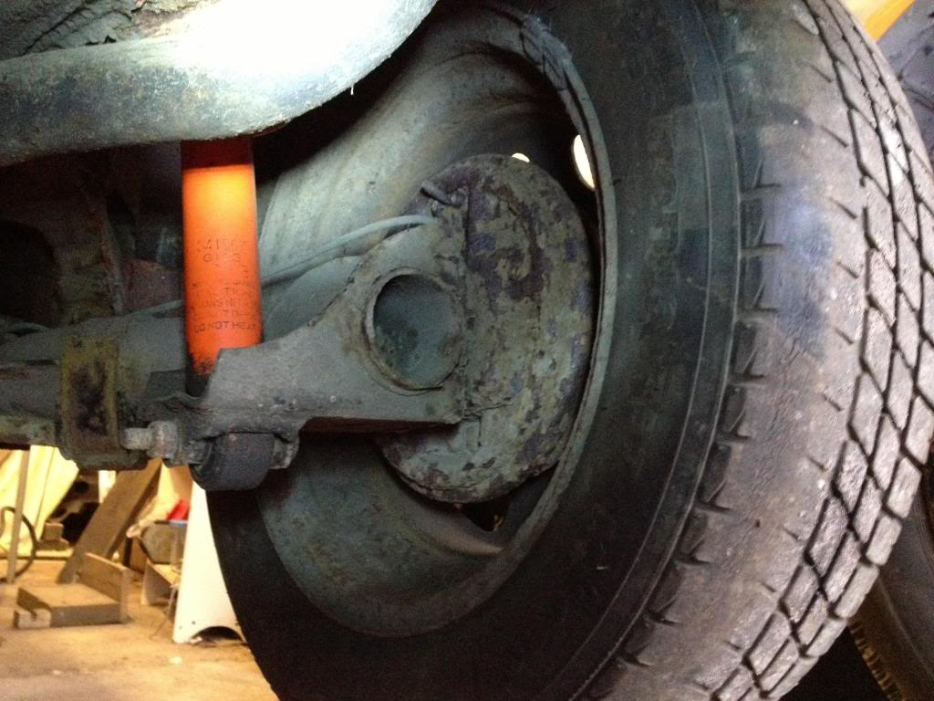

I'v rust coated all but the front underside of the car now and once thats done i'll get the rear wheels off and check the hubs out. Had see some powder coated drum cover for sale but going to have a go at it myself and see if i can get a good finish on these ones.
Both sides loose underseal scraped off.
Lots of grey rust coat patches, but over all not too bad. Not very exciting pics atm lol but i'm having so much fun doing the car already that i want to document it all. i'm already thinking about what im going to do when the jetta is finished as think i have the bug now lol
Current extra bit of fuel pipe on the fuel line.
