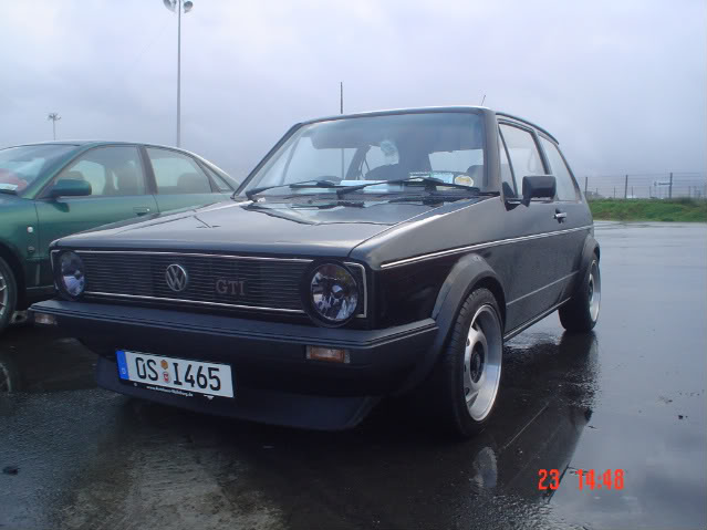

Been a member here for a while only got this
build thread together last week so here you go

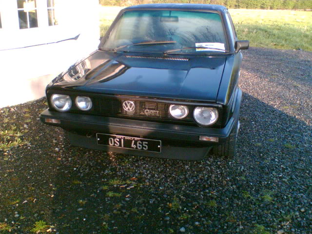

Here's my mk1
I bought it in may 2006
It's 1.8 8v
1983
When i bought it, it needed a good amount of work
( But that's where the fun is & What it's all about
the brake's were very very bad
the car could hardly move no power
the glove box was broken where it screw's to the dash,
(New dash needed)
no horn (The car :roll: ), very bad light's,No indicator's, Hard to get 5th gear
(The linkage's were worn & broke)
Window wiper's would only work on 1 speed very very very slow,
no rev counter, no dash lights etc
Body wise it was fairly straight,Paint was fair & after that everything else
could be fixed
Theese pic's were taken the morning after i got it,
the car looked a lot better after a good wash it brought the paint
right up got rid of the dirt and grime
It also came with this leather interior (now changed)
I don't like the blue but the seat's are in good condition,
i'll change the blue bit's in time, (there on the to do list)

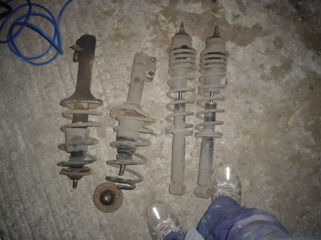

Rear Strut
The service history show's that
before i got it, it got
Bush's balljoint's & service bit's filter's,shocks etc
also
Radiator 15.12.97
Steer rack 24.01.98
Engine work 10.04.98
Clutch cable 27.07.98
Fuse box 29.08.98
4 Branch manifold down pipe 16.11.98
Expansion tank & cap 08.03.99
Speedocable 13.05.99
New exhaust box's 20.04.05
New front & back bumper 18.05.05
and it passed the nct (National car test) on 30.06.04

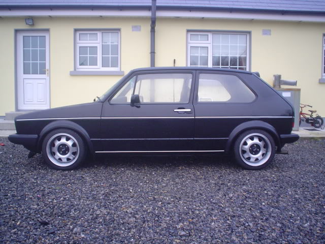

This is a picture i took of the car about a year after i got it,
Done to this point is
Full service,
Brake problem sorted out with mk2 16v servo,
G60 master cylinder,
Rear Brake Caliper's & disc's,
Braided brake hose's (goodridge)
scirocco gti hand brake cable's
No power problem sorted
incorrect distributor cap was fitted
changed for new one along
with plug lead's, New rotor and ignition timming done
few small thing's i got at inter's 07
Bonnet lifter's
number plate's, number plate surround's
tinted head light's also this de badged grill
which i hate, (really look's bad on a black car i think)
i should have left the original double headlight grill on it
but you know what it's like, you want to change the
look of a car when you 1st get it

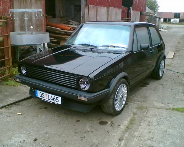

Next a set of 15" ATS Cup's
New bee sting
& chrome side trim
Only phone photo's not great quality
Just to be sure
E-BAY
Next job prepare for nct (National car test done every 2 year's) same test as your mot
Sort out the headlight's with relay's & replace / tidy up wiring,
Got a dash at inter's 2nd hand in good nick fitted that
Fit mk2 wiper motor
Fit new horn and sort out earth problem
Sparco foot pedal's
Got clock's from ebay and took bit's from it to fix
original set
& a good few other bit's & pieces
Passed test on 11.03.2008

Time to sort out the Height
went on a local club end of year car run saturday,
Only about 10 car's in total, mostly went for the reason of
bedding in the coil's
And it's nice to get out for a spin 2
Got home late had to
Get the car out of the shed this evening to give her a wash
Dirty bugger &
Take a few snap's but the weather is very dull for it
Going to let them bed in for a while before
adjusting to get a good stance but it's not to bad there now
