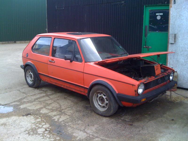

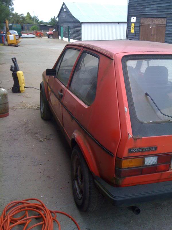

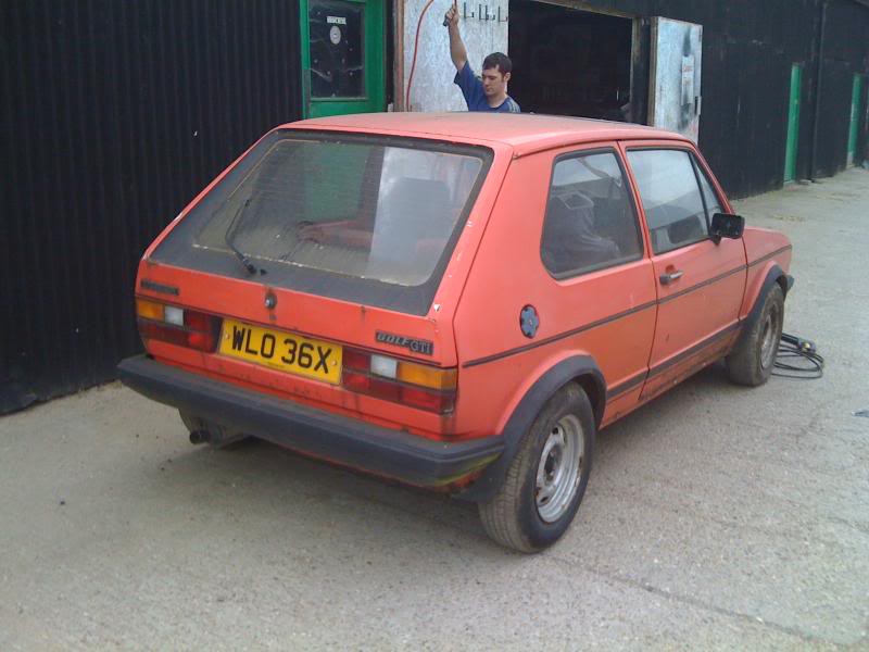

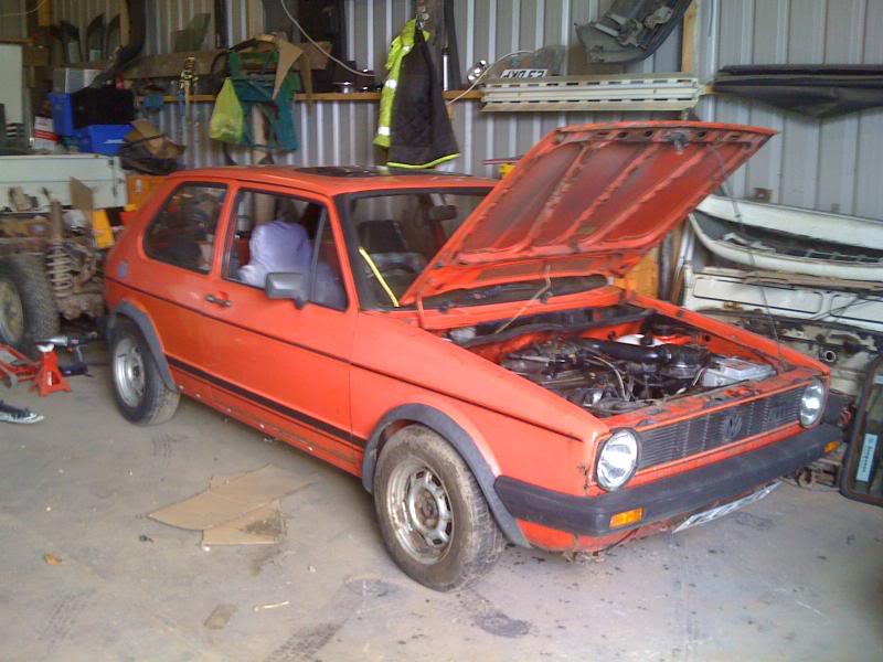

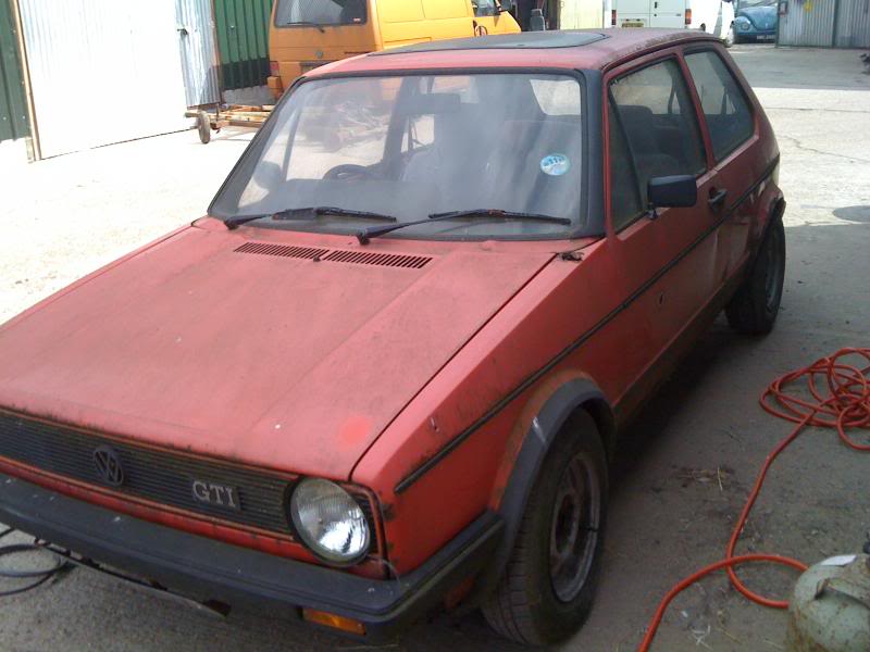

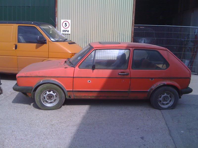

Im relatively new to the VW scene. I have an Audi as my posh car, and bought a Mk2 Caddy that im tidying up for the work commute, then i was looking for a Mk3/4 Escort to restore, but was offered this and gave up looking for the escort. So this is how it arrived after sitting in a field for 2 years:

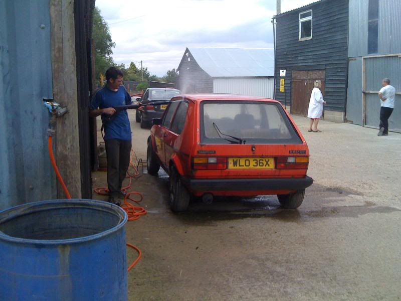

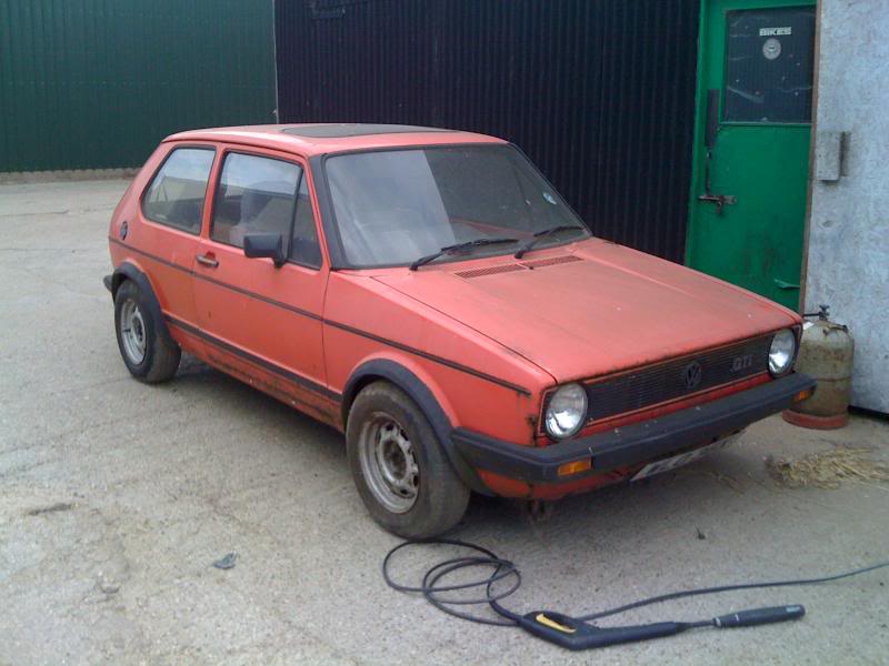

Then my mate washed it for me:

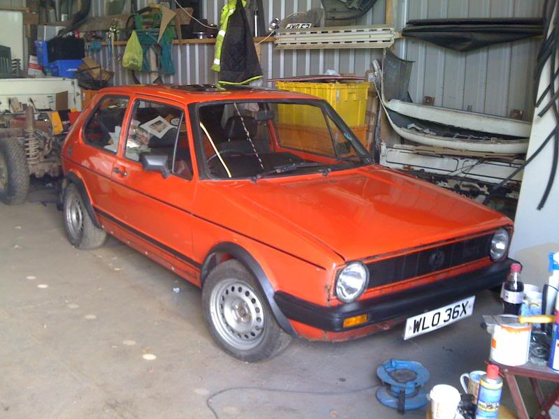

Charged the battery up:
And amazingly it started so i drove it inside:
We gunked the engine, needs a bit more yet:

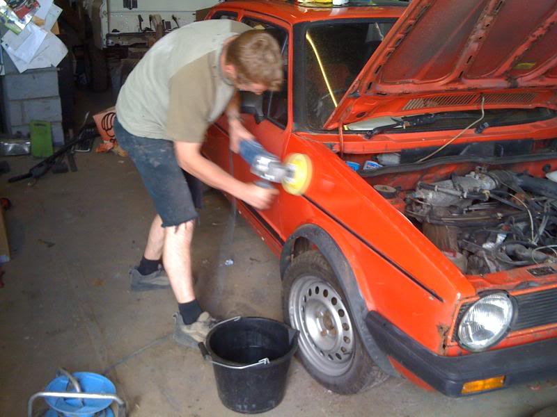

And we started T-Cutting it:
Its lowered, polybushed, braced and other than a bit of panel Rot, is pretty spotless. Underneath suprisingly so on first inspection although after seeing Jellys i may look more closely. It has some new panels with it including wings and arches and a few other bits and bobs. Now i need to decide whether to have it instead of the Mk3/4 Escort i was going to get. Either way this or the escort will be put in the corner till the Land Rovers further progressed, as a sort of investment thing, as both cars values are rising at the mo.

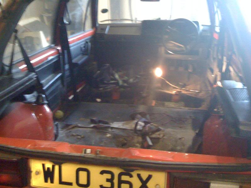

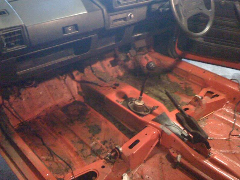

Nigel starts emptying the inside and binning all the rubbish from inside the footwells and boot:

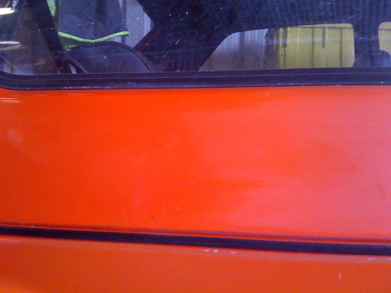

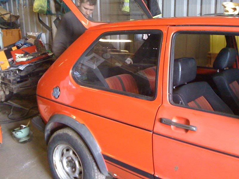

Then we both got T Cutting and polishing:
See the difference:
Emo had a go with a mop:

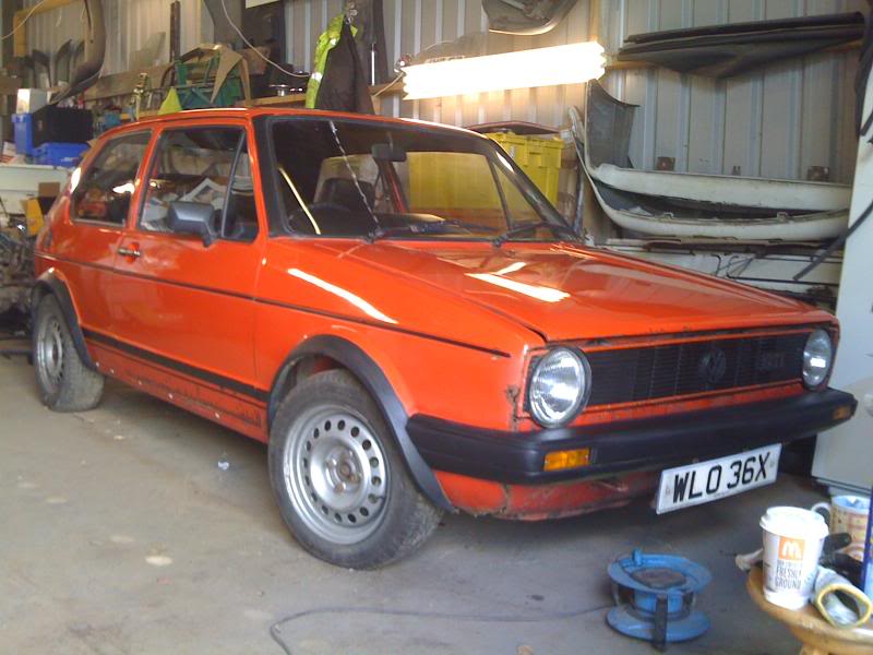

And i fitted some Mk2 GTi steelies:

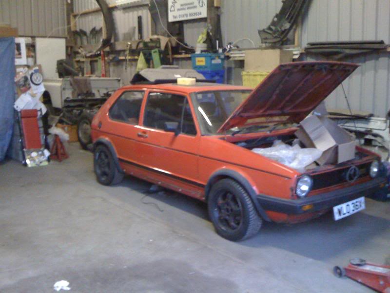

So here it is before:
and after:
Mega improvement. She initially said no, but she walked past it a few times so i think i may be allowed it now lmao

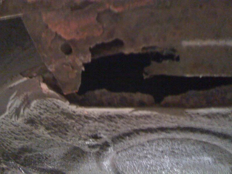

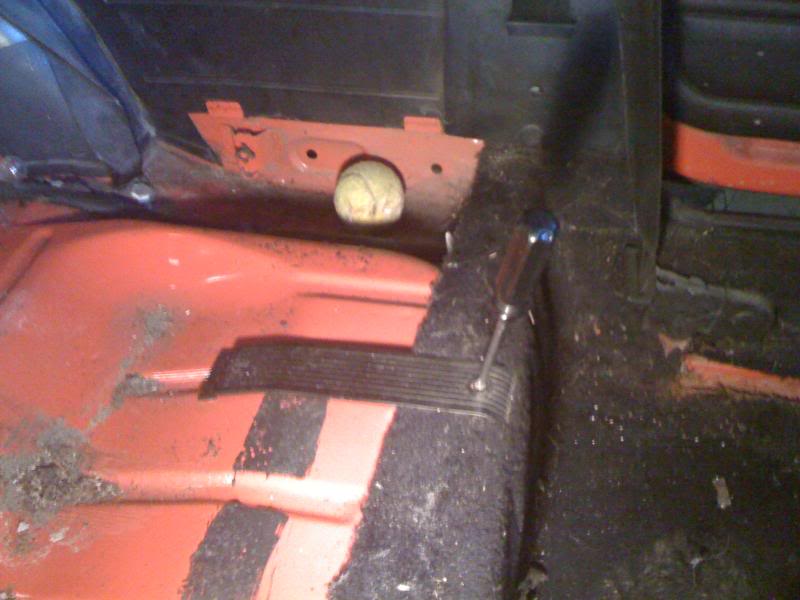

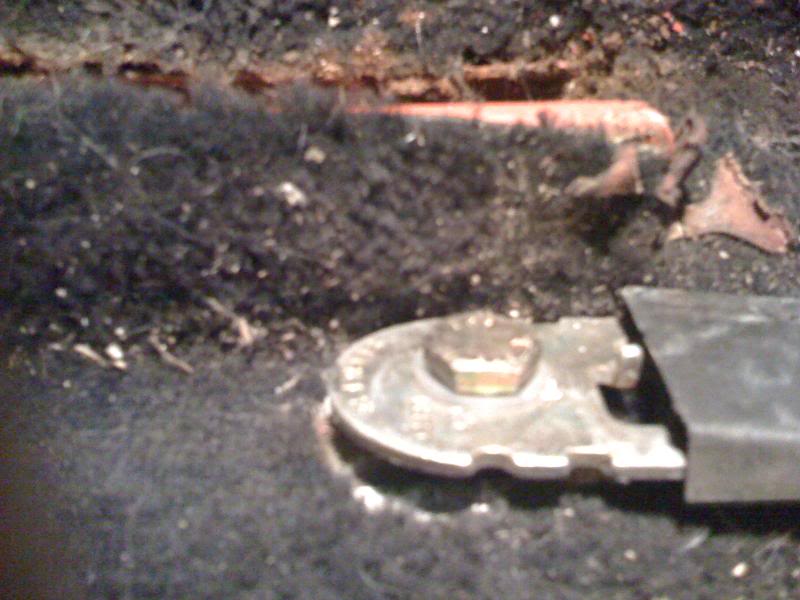

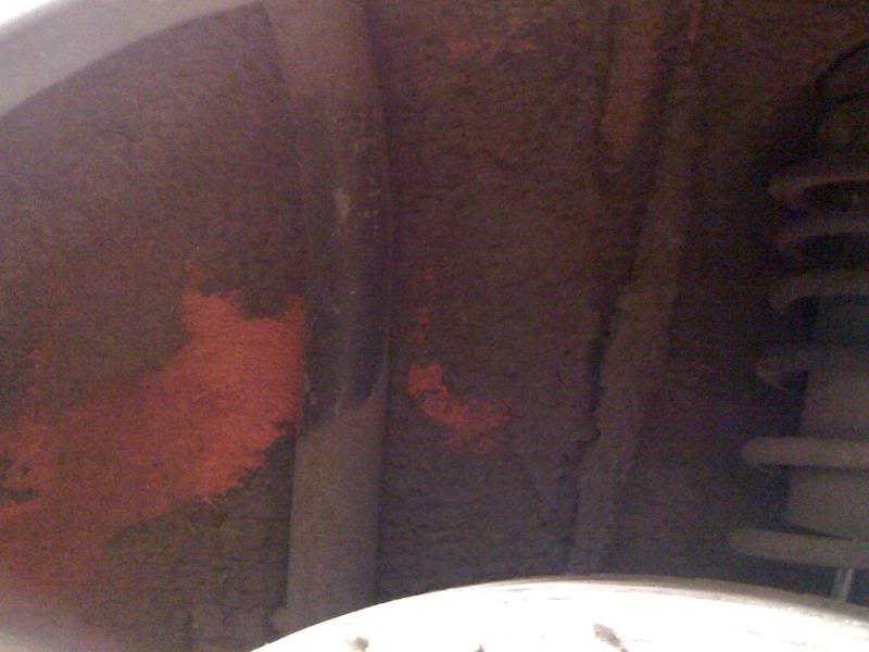

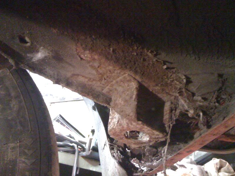

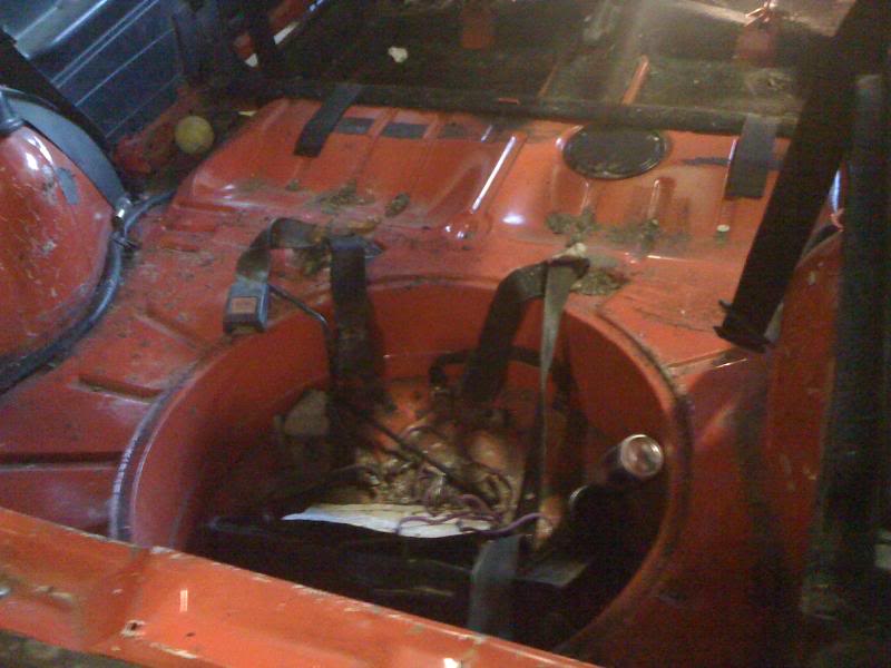

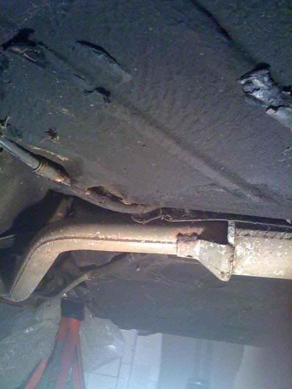

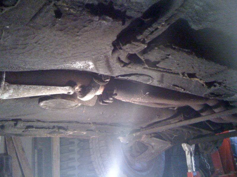

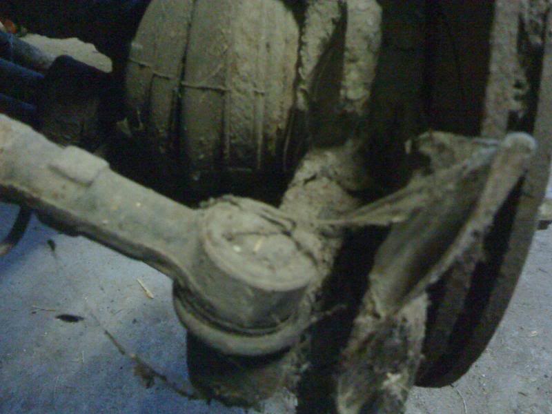

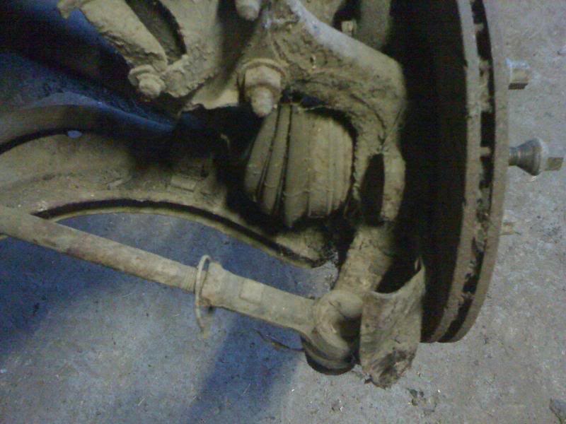

Well today i got the Mk1 on axle stands after reading the MK1 owners club forum and seeing a couple that had rotted bad underneath, and got al worried. So rolled under with a screwdriver and although the pics dont show a lot, it was pretty clean :)

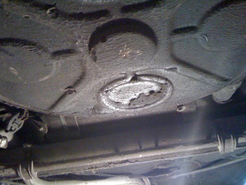

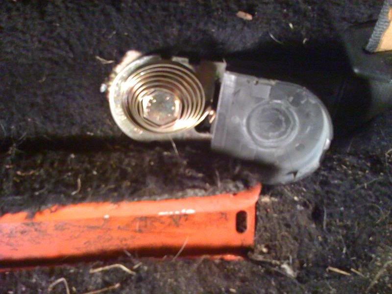

Back of spare wheel well has a hole:
But the inner arches were clean:

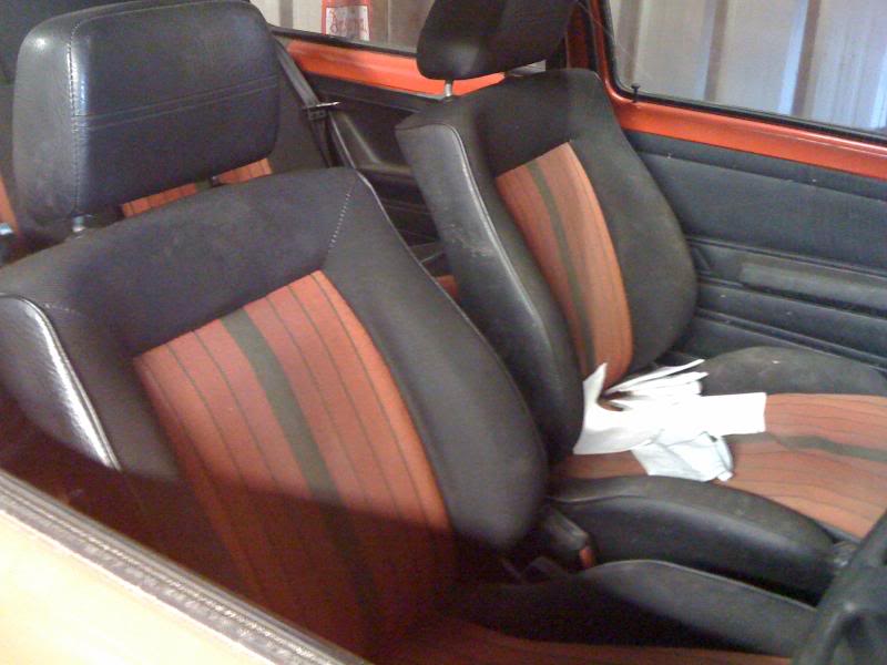

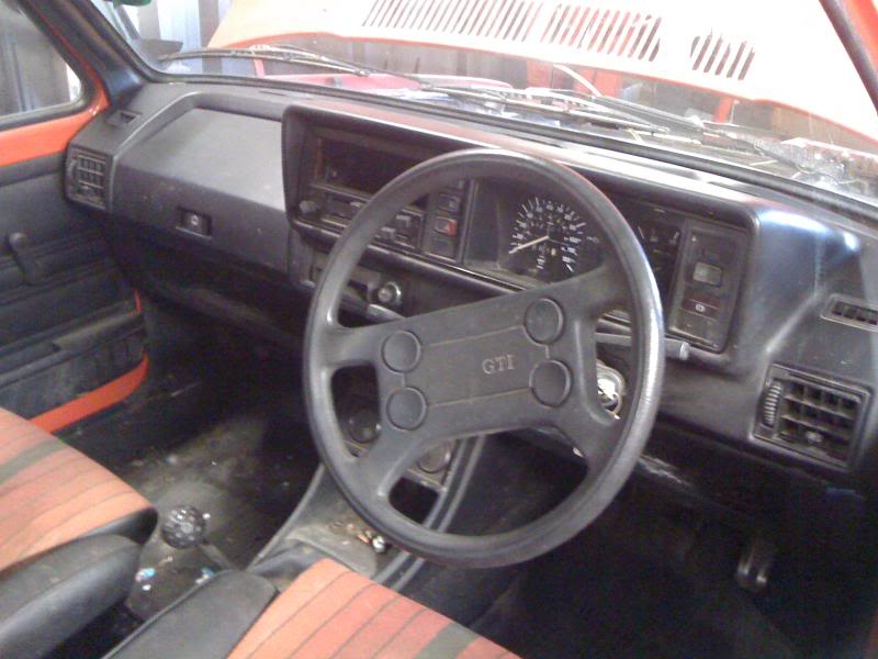

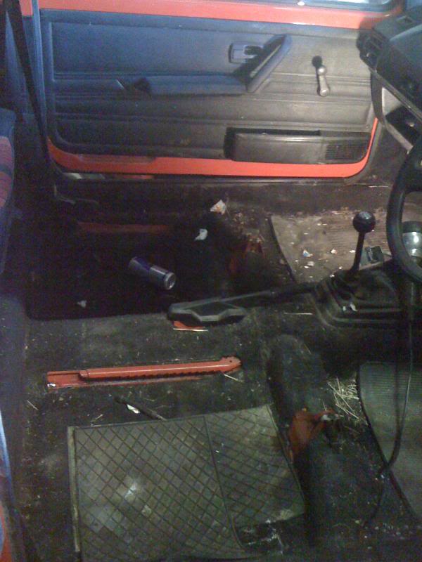

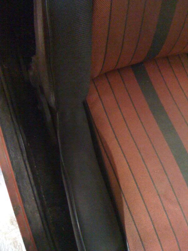

Just to show, although dirty, the interior is tidy!
youve got yourself a good deal, an interior like that and what seems to be a more solid than most golf is worth a good few hundred quid mate.

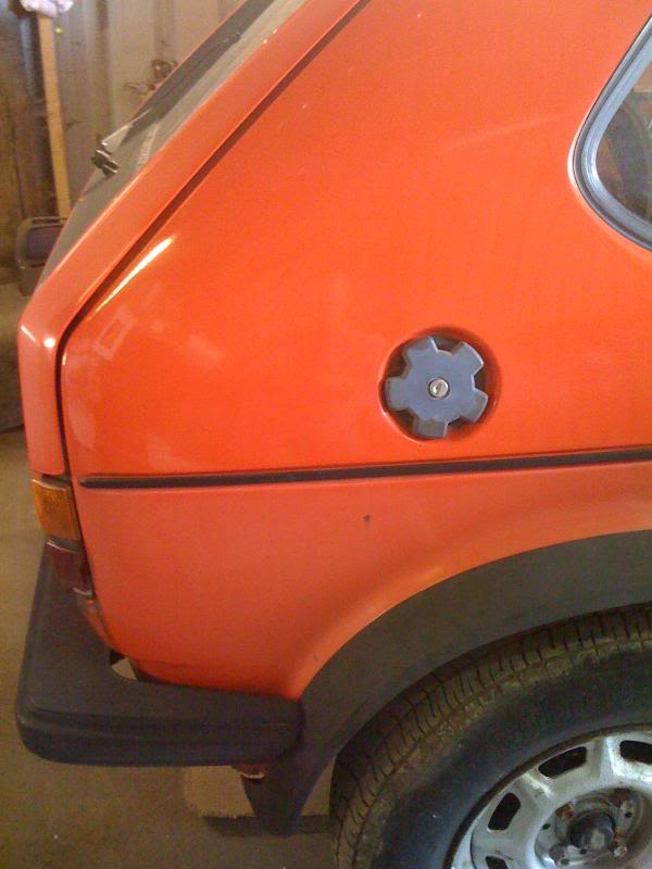

check the filler neck/rear upper drivers arch, where the sills meet the arches, front sills/floorpan for jackign accidents and inner wings where they meet the front panel. also where the axle mounts. they are the worst areas on a mk1
Rear axle mounts appear fine. Inner arches appear fine. where sills meet the arches have gone but if thats all i need to worry about im chuffed :)

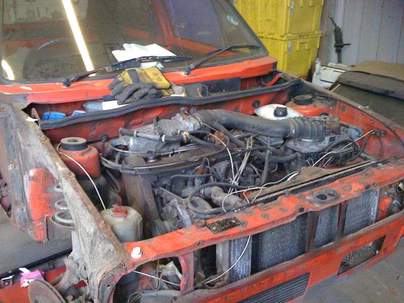

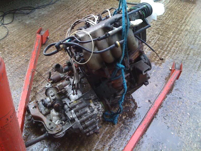

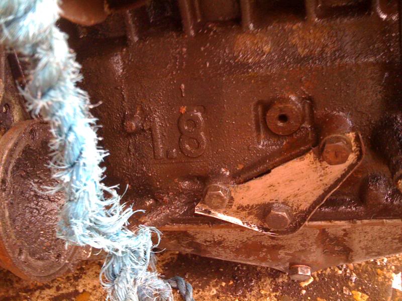

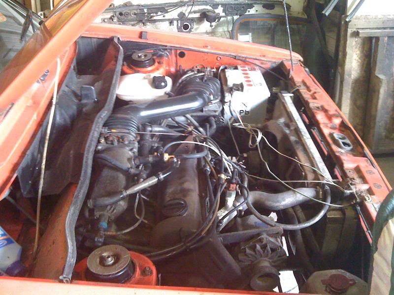

I started de-greasing my new engine for the GTi. A bored out 1.8 thats now a cammed up 1.9. Apparantly a TSR developed engine, whoever they are. Its not spotless yet but got a lot of the crap off. Its been sat for a year so needs dismantling to be checked over:

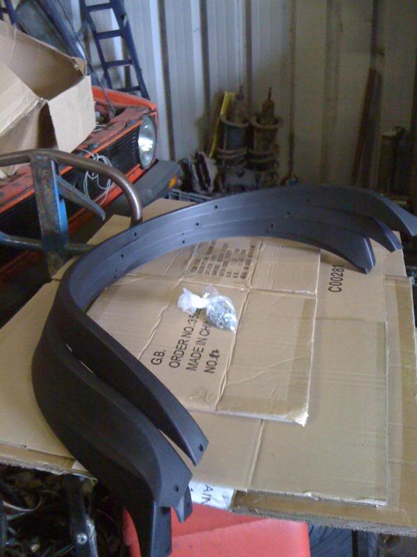

Got some brand new arch trims for the GTi, with new fixings:

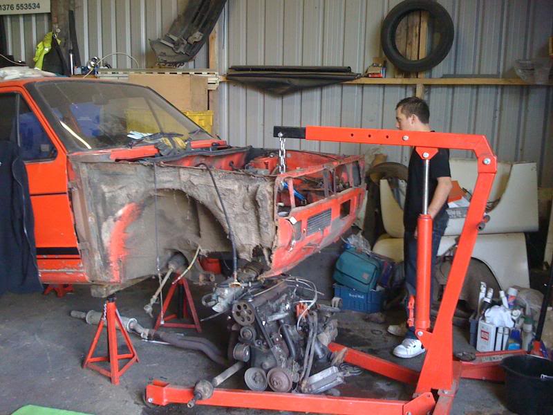

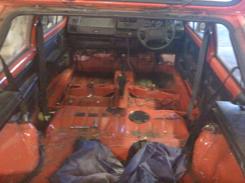

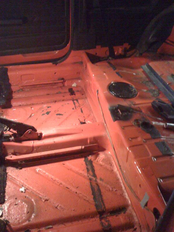

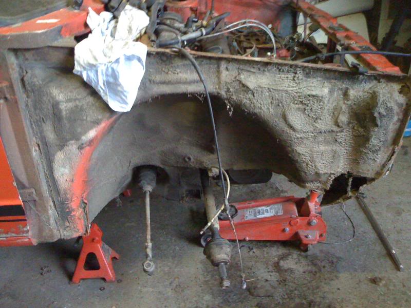

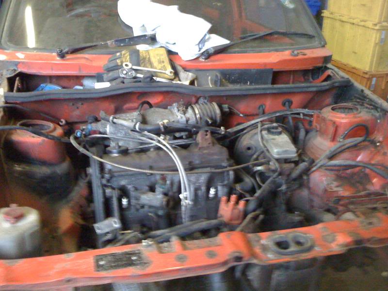

Then began the strip down:
Started stripping the Mk1 (some pics are for my reference hence the randomness lmao):

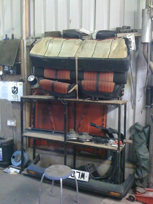

And got my GTi rack ready. Strapped the seats up so they dont fall off. Got some covers to go over them too:

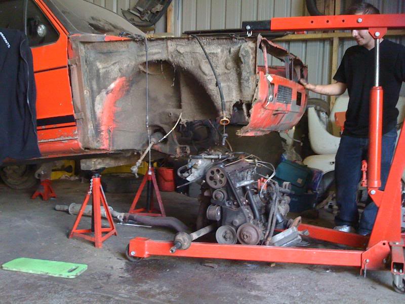

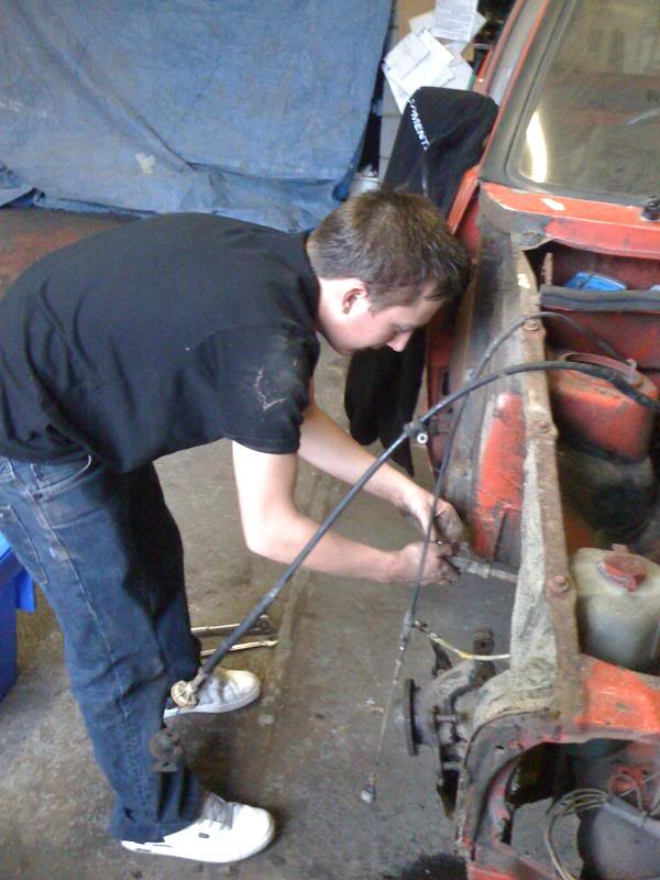

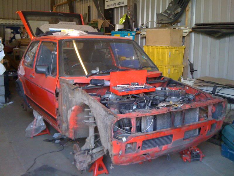

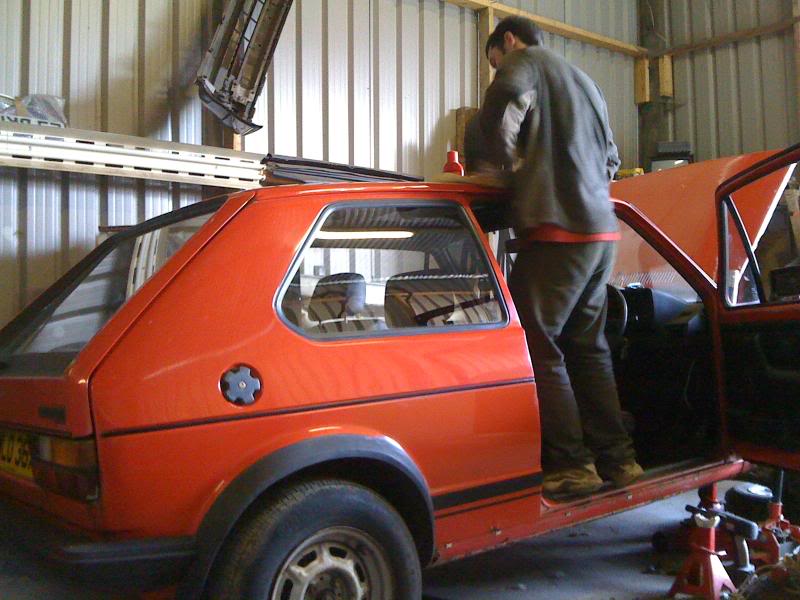

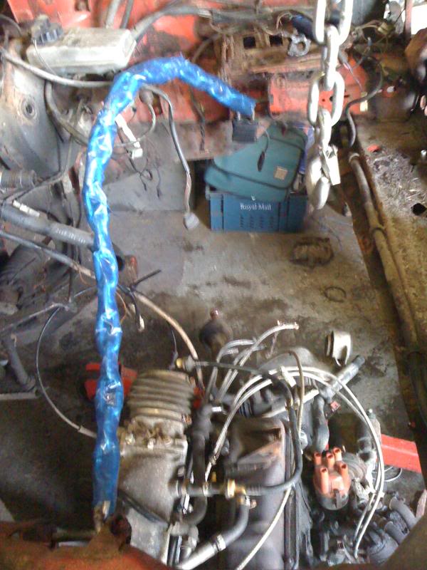

Today was mainly Golf day. Cracked on on my own until Alex turned up and lent me a hand. How it started:
During:
And Alex getting it done:

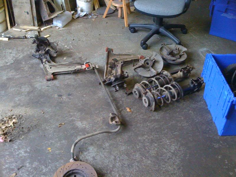

Parts piling up including my Mk1 Hubs. Means i can flog on the Mk2 Stub axles and calipers now:
Suspension off:
And how it is now:
