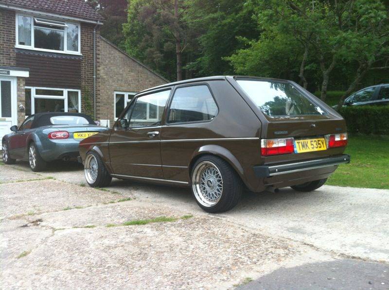

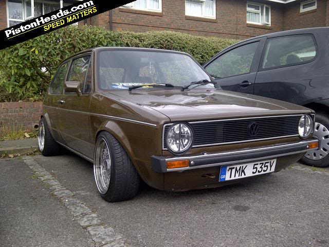

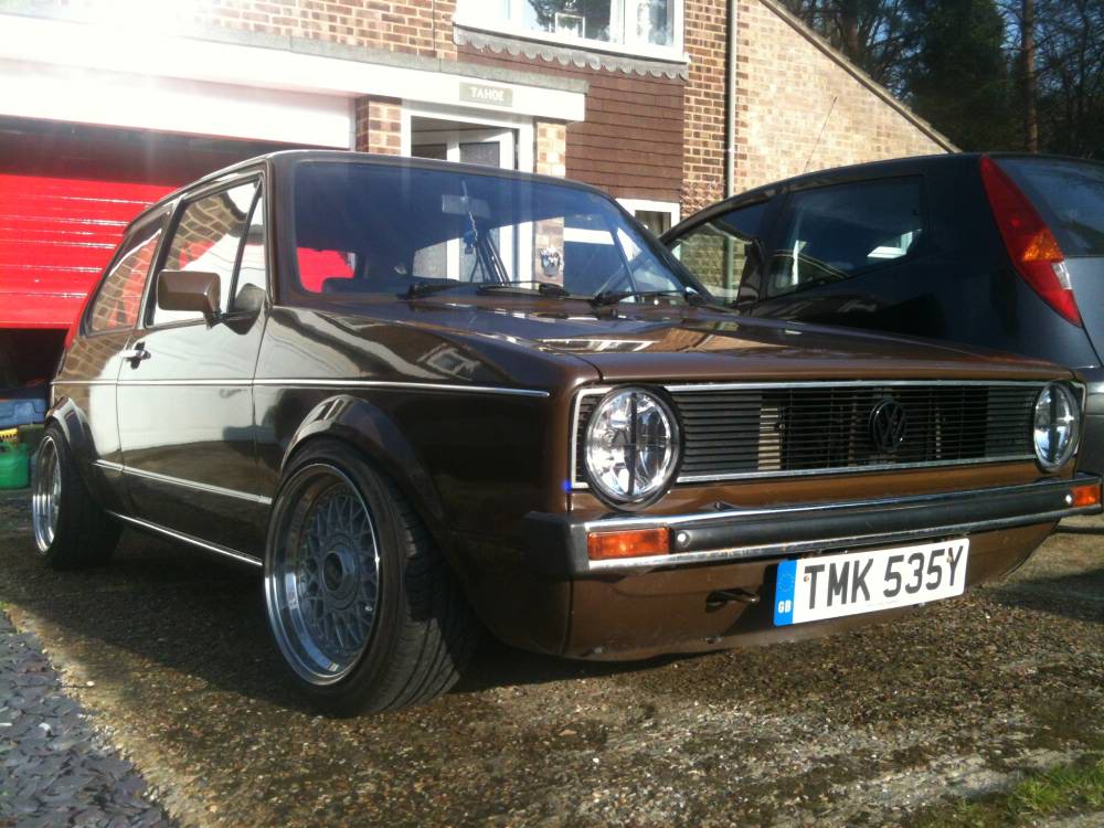

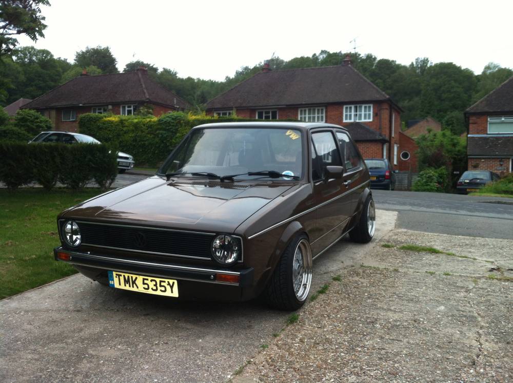

So here she is, my first Mk1 golf, she's a 1983 1.3 Driver. She's only done 87000!
I'd been after a Mk1 for a while, and after looking around for many months, finally a local(ish) good condition came up!
It had pretty much everything i could ask for from a Mk1: Three door, slammed, tidy rims, single light grill, chrome trim, rolled arches. What more could i ask for, ey!?
I brought her a few months ago, and am about to under go some moderate modifications, but first here are the photos from the add:
It may look like she's pretty much sorted, but don't worry there'll be a lot modifications and bits and bobs to be done, so stay tuned!

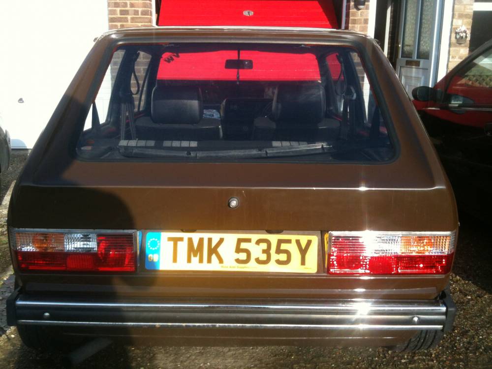

As you can see, the exterior is mint. I believe it was resprayed around 2 years ago in an unusual brown (I like it! let me know your thoughts on the colour). There's little sign of her age on the interior as well, despite a small rip in the driver side seat. She's on 15" BBS RM's which have a good amount of dish and are pretty much immaculate. Also as you've probably noticed she's very low indeed!

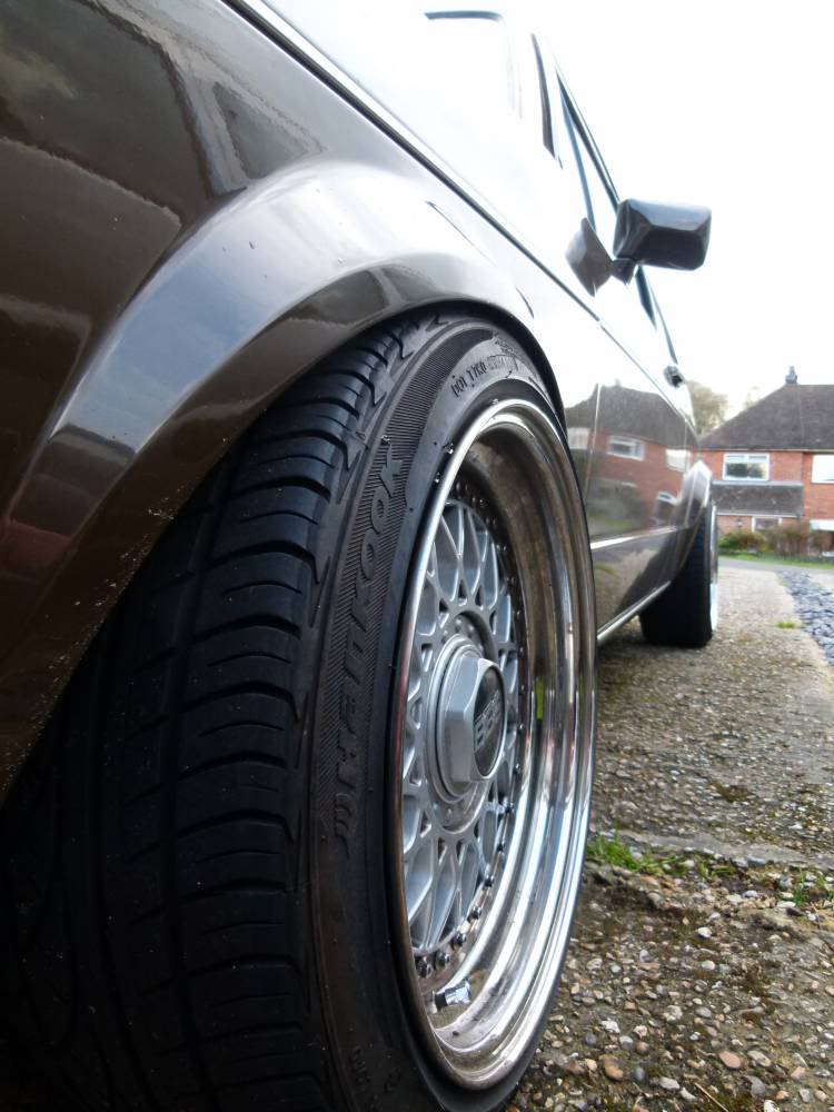

The tyres are also slightly stretched, i know it's not to everyones taste but i'm a fan of a little stretch, to much can look abit silly. Although it makes any curbage incidents much worse :? So i've got my passenger side mirror set up on my rim aha. Take a look at the stretch and also how low she rides:
With the ride this stiff she does corner a beaut, there's virtual no body roll at all! Don't get me wrong, i'm no boy racer who rags it everywhere, i'm a firm believer in low and slow!

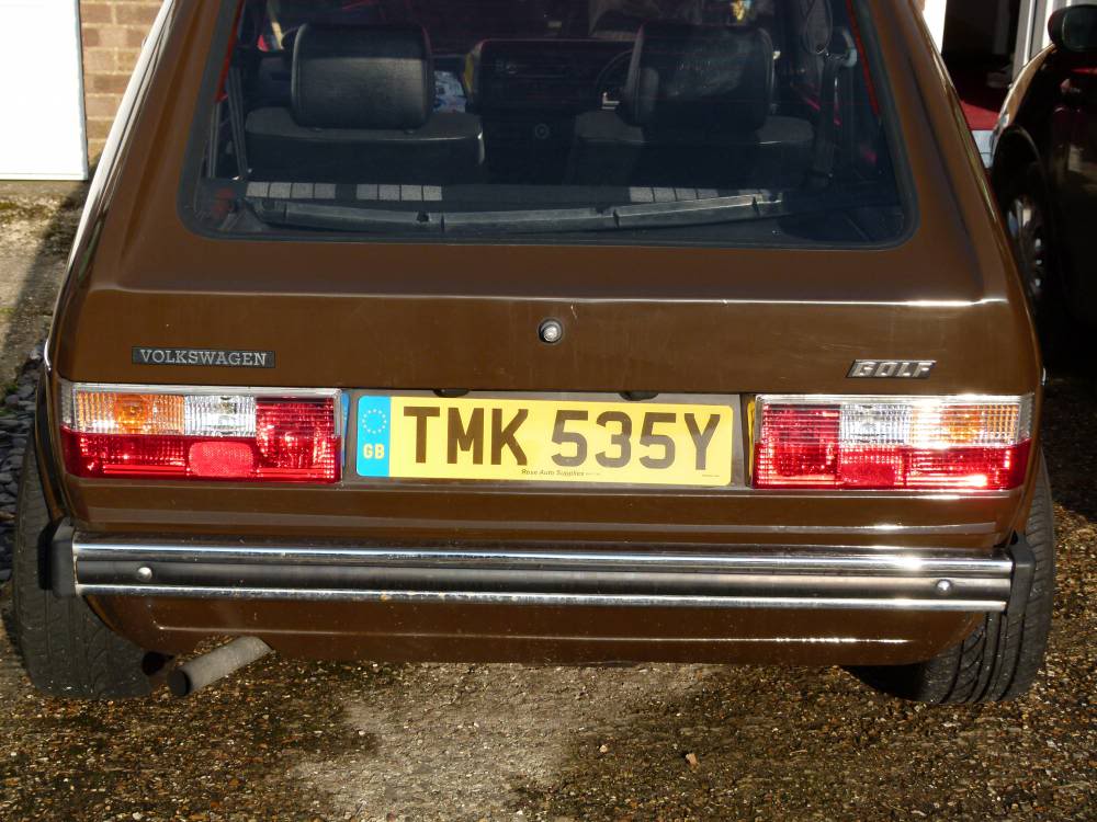

First thing i did was to add a "Volkswagen" and "Golf". Here's a photo of the Boot before and after the badges, I much prefer it with the badges:
Badgeless:
With badges:

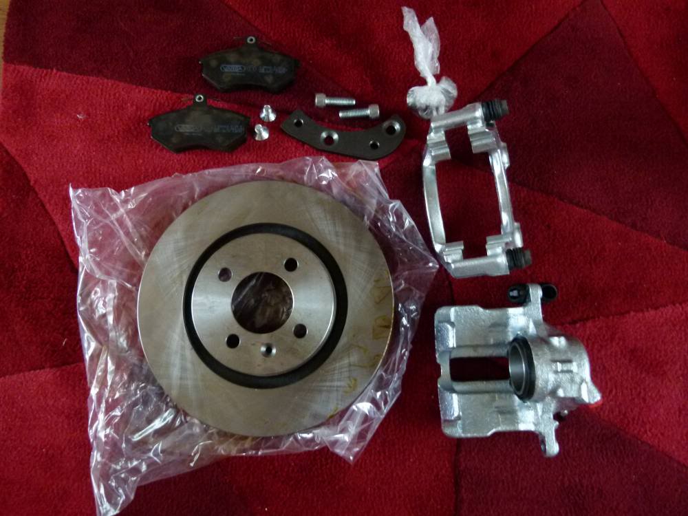

Finally i have everything I need to upgrade to the G60 280mm brake conversion! Check 'em out:
I know what your thinking: "G60 brake upgrade, on a 1.3?". That may seem a bit ambitious, however as you know Mk1 brakes work as well as potatoes and i'd hate to end up rear ending someone because of this. Secondly I would very much like to do an engine conversion (although this won't be anytime soon!).
Also the rear bearings have arrived, which means i now also have everything i need to do a complete rear drum refurb. This job has pretty high priority, as on one of the threads on the drive side rear hub is threaded, meaning my rear wheel is only being held on by 3 botls, which is a scary thought!:
I'm keen to do these ASAP, the brakes do work, although i've defecated in pants in the process of stopping! I hoping that with the complete brake overhaul i will save myself some clean underwear in the future.

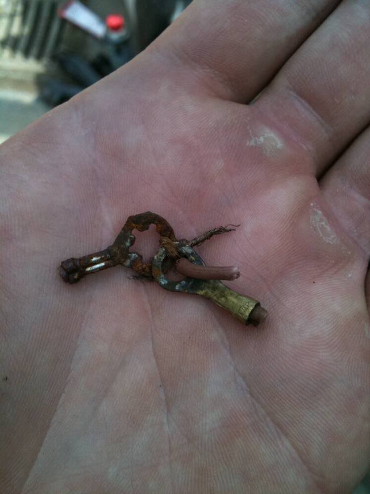

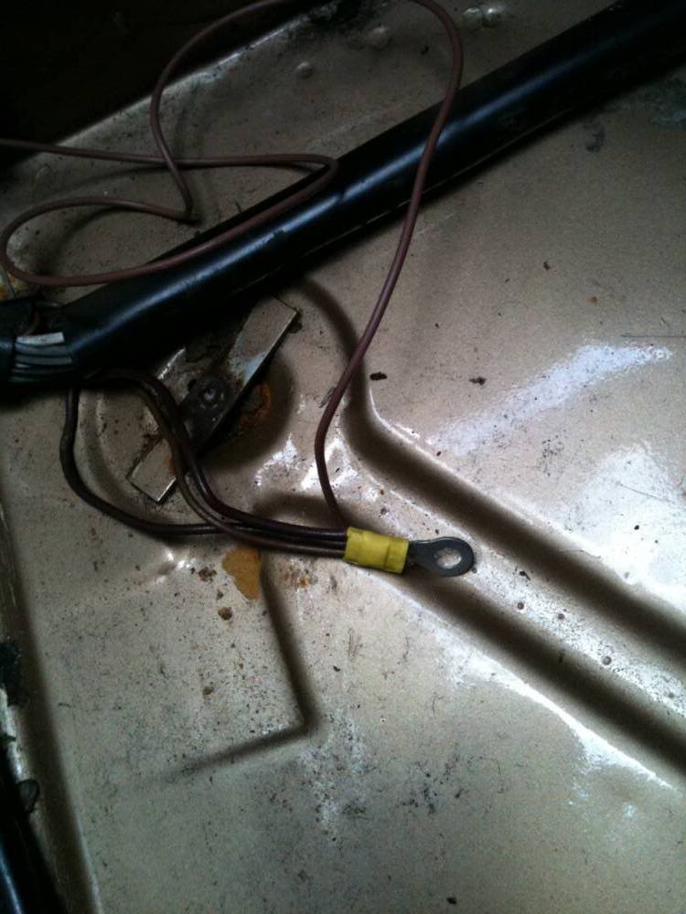

One of the problems i've noticed is my driver side rear light is pretty dim compared to the far side lights. So i went to see the person who knows many a things about electronic fiddly bits, my old man. When we started looking at the wires and the light itself, first thing we did was to tidy everything up.
The connections were looking pretty sketch and here's a photo of the previous wires looking tired:
You can also see the original colour of the car in the above photo, which i'm not a big fan off!
Grubby!:
So we tidied and crimped it all up hoping it would make a difference:
Unfortunately there was no improvement. The earth seemed fine, everything seemed to be in order. Par whipped his voltmeter out and started poking and prodding this and that muttering things. So he came to the conclusion that the dim light simply wasn't getting all 12 volts, it was only getting around 7.5ish. This stumped the man that has been with BT for 30+ years, so the chance of me solving the issue was looking slim!
So I guess this is not only an update on the thread but also a cry for help! If anyone has any suggestions or tips they'd be greatly appreciated. As it's pretty sketchy driving around with dim break and indicator lights, especially in the day!
You could help save my par losing what little hair he has left, we're stumped!

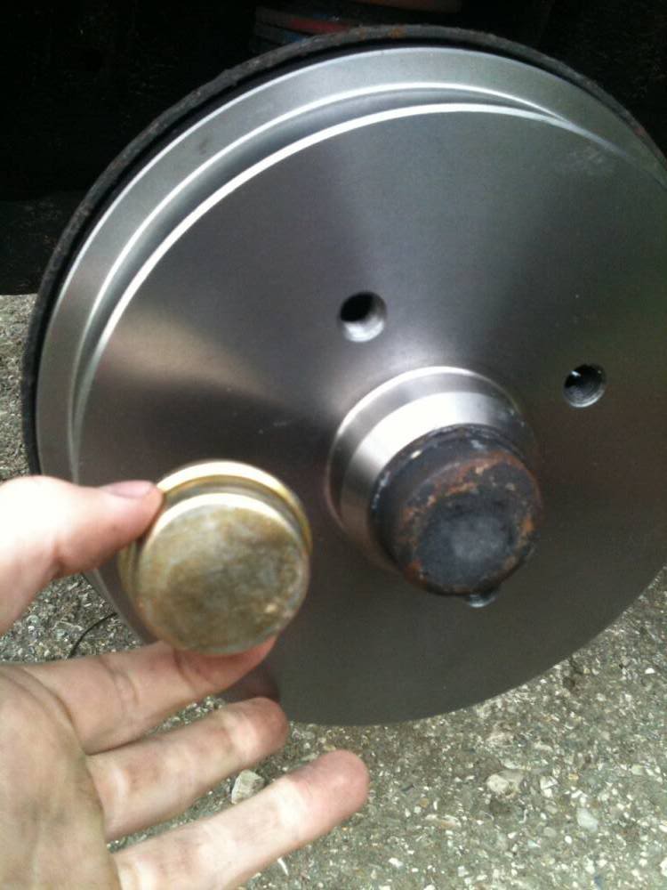

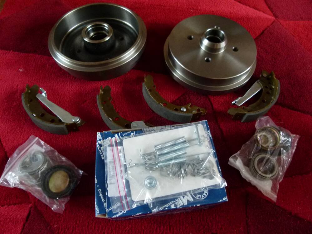

The weather was nice today, (by nice i mean not raining aha) so I figured i do the back brake refurb. This was an important job to get done as if you remember earlier on in the thread i mentioned that my driver side rear hub had a threaded hole for one of the wheel bolts. So my wheel was only being held on by 3 bolts, which had been on the back of my mind while driving most of the time.
Over all it was a pretty straight forward job, heres the photos of what happened:

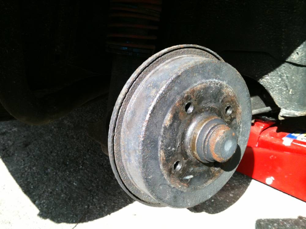

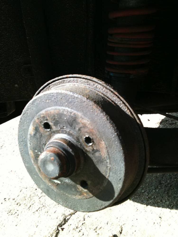

Started with the dodgy hub, as you can see she was looking tired. I had no idea if these had ever been looked at. So was keen to do so as these could be untouched in 29 years:
You can see a trolly jack in the background which I'm borrowing of a friendly neighbour. Which is a lot less kurfuffle than using a fiddley little jack you find in the boot of your car.
I got all the stuff from VW Heritage, they've proved to be pretty good with all the stuff i've got from them so far. Although there was a little glitch, of which you'll see later on.

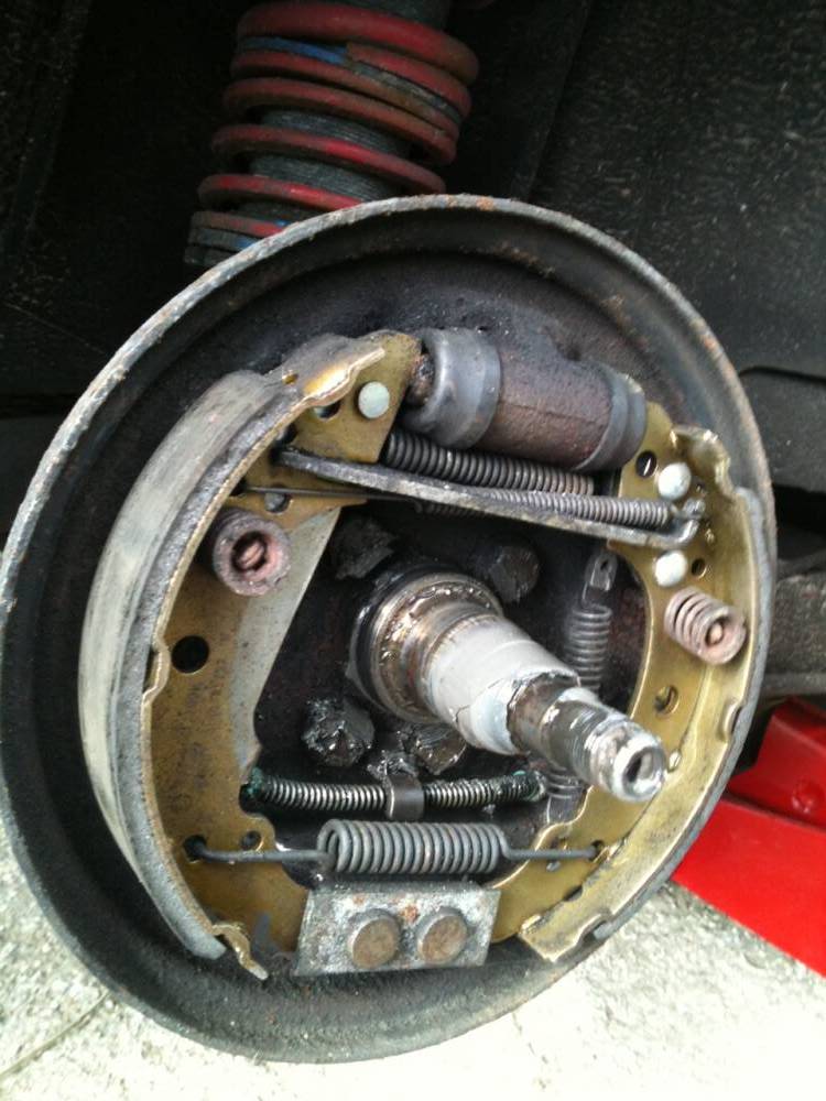

I was pleasantly surprised when I got the hub off, everything looked in all good working order:

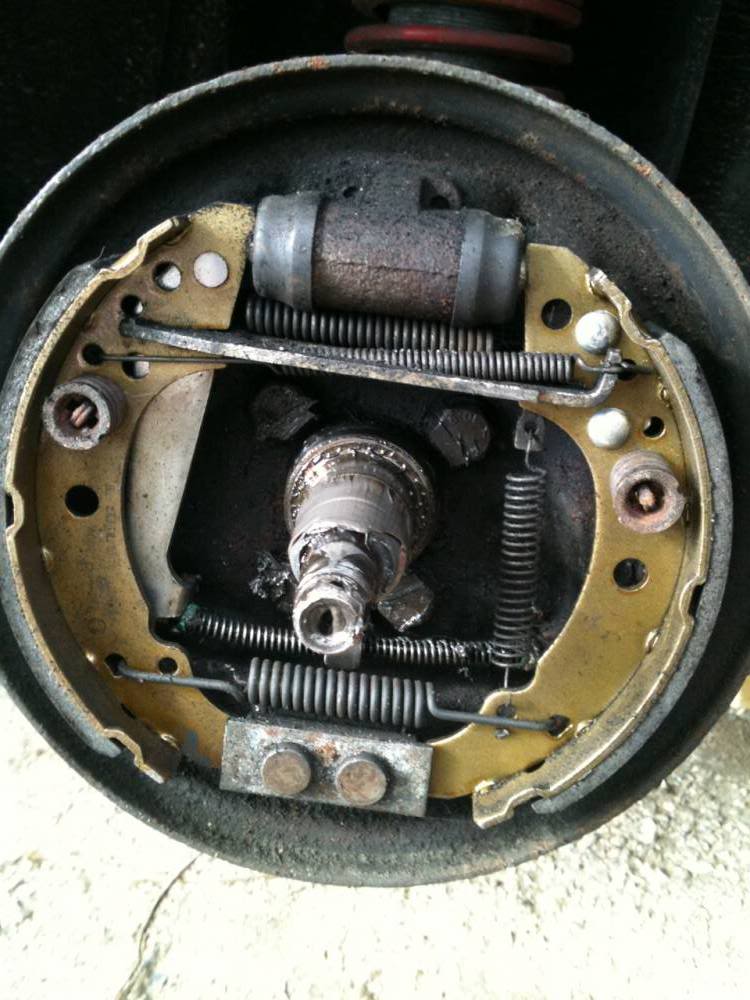

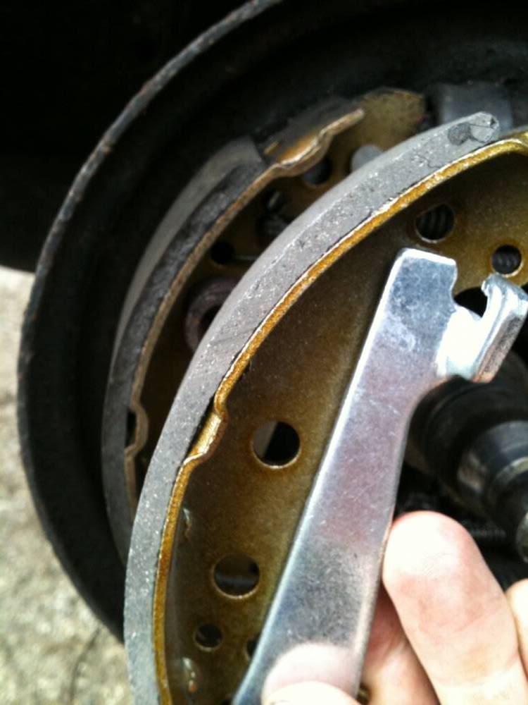

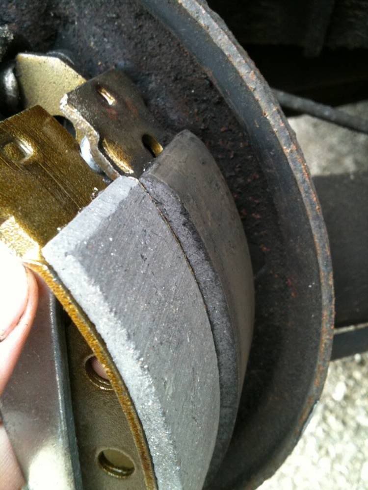

I'm pretty sure the brake shoes have been replaced not to long ago, i was expecting them to be worn to bits. Here's a photo comparing the brake shoes i brought, up against the shoes already in the hub, as you'll see there's still a lot of use to be had out of the original shoes:
I decided to not replace any of the shoes or springs. VW Heritage do a tidy little refurb kit which includes all the springs required to overhaul two pairs of hubs. So i stuck these back in the garage to be used when they're really needed. So i'd be changing over the hubs and bearings, i thought if i was changing one side i might as well keep it even and do the other side while i'm at it.
Greasing up the new bearings wasn't a nice thing to do aha, however discovered some of my old mans grease which he'd has since the 70's which he used on his 3.0 Ford Capri, it's even older than the car it was about to go on aha!:

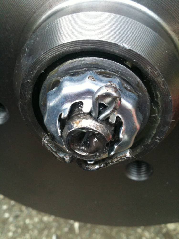

The new spilt pin also came in the VW Heritage kit:
Here's the finished article, looks a lot better if i may say. The only fault i could find with the Refurb kit was that the dust cap just wouldn't fit! I got the rubber mallet on and it still wouldn't go in. So unfortunately i had to use the original, but i guess that doesn't really matter, just me being picky about my car! aha:
The job didn't take long, and it's put my mind at ease that my wheel is not being held on by 3 bolts anymore aha. Thats all for now, thanks for reading! Will be back soon with possibly G60 front brake assembly and/or electronic ignition.

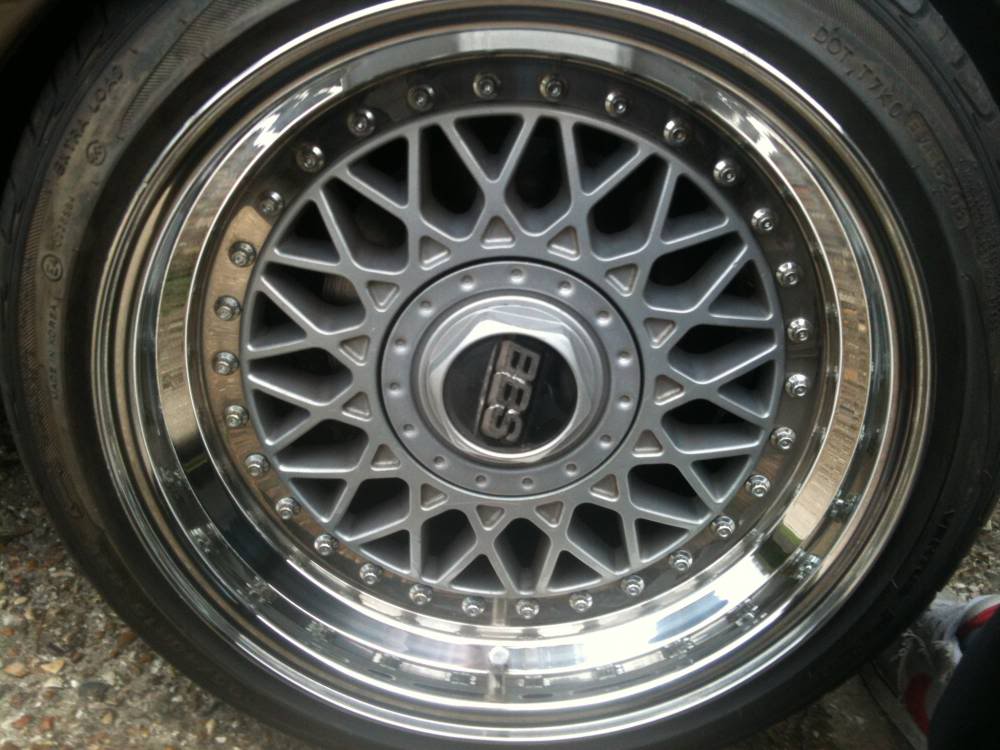

My RM's are 15's, centres are BBS silver with a 2"inch chrome lip on them. They're pretty perfectly proportioned in my eyes aha.

The rear lights, check the bulb holders, unplug them and get a wire brush on them on every metal bit you see, where the bulbs sit in and where the connector sits on, be very meticulous. Afterwards give it a coat of silicone greese. Clean the terminals inside the connector block, check the wires as they go into the terminals on the connector block. If your earths are good then I'd be stumped too, I did this job a couple of months ago and it was the bulb holder/light board was lightly corroded.
