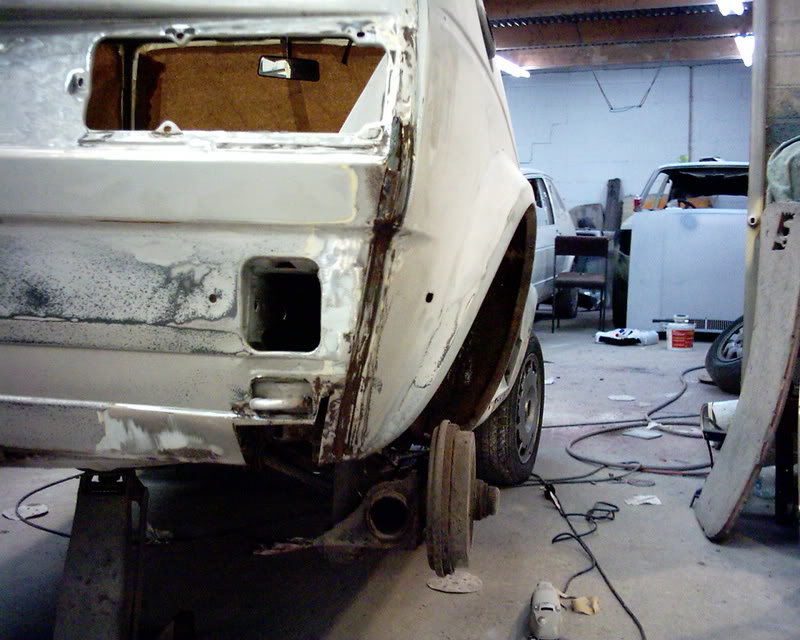

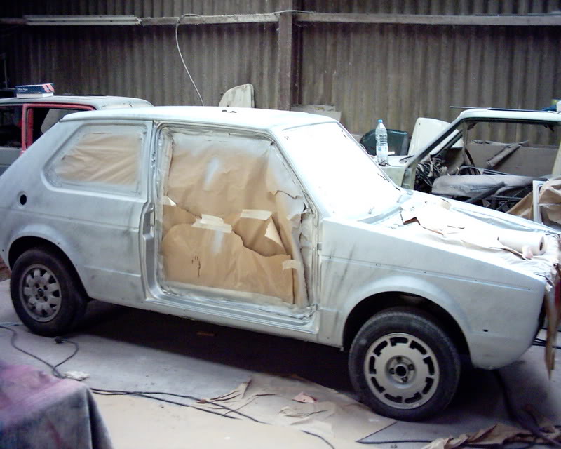

We welded in some new steel then gave it a quick skim of filler ….
Once rubbed down and smoothed i sprayed the first few coats of primer and let it go off..
After the paint had gone off for a couple of days i check for any imperfectiions,small dents,rippled panels etc,once this is done,i nibb off the primer withe a 500gritt dry disk then apply the final heavy coats of primer..

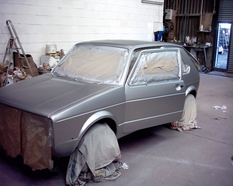

Mettalic all done!
Now with a touch of laquer…
