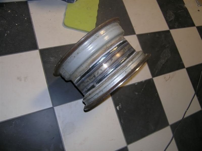

Before;
2 inch band to make 7 inch
3 inch's added to make 8!
Still in Holland at the moment but should get them by the end of febuary. Still need to buy tyres and a suspension kit first!
