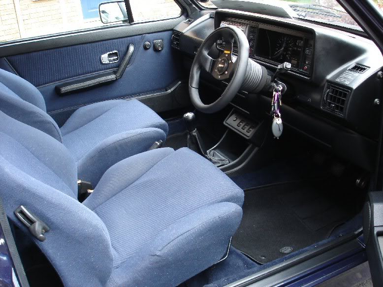

At e38 '06
Humble but tidy rivage cloth interior.

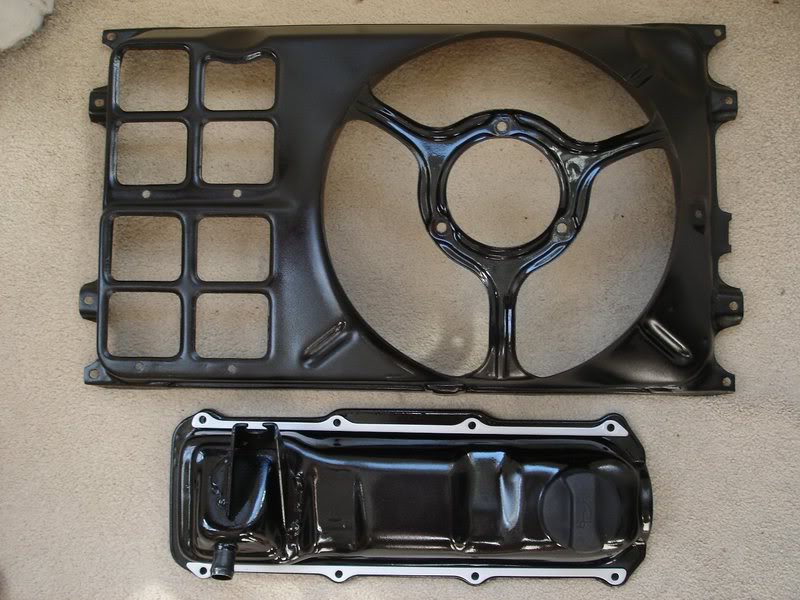

Spent three full days degreasing and cleaning the engine bay, this is as good as its gonna get. Old steel 4 branch to come out.
Black and silver/polished theme throughout the engine, so it retains its original asthetics. Again all sprayed using 'Hammerite'
