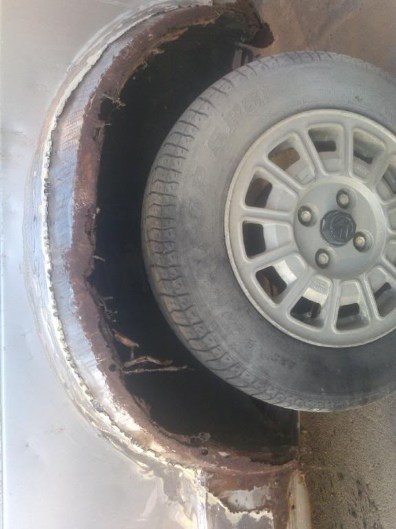

decided to see what was under the repaired arch and sill…couldn't belive how or why someone would go to these lenths to do a bodge job, the sill is o.k upto about 4 inches from the rear arch, then it gets scary…
trying to remove this bodge proves to be hard graft
and here's my reward for the 2 hours chiseling and grinding…a rusy arch..woo hoo. cant wait to see what treasures tomorrow holds.

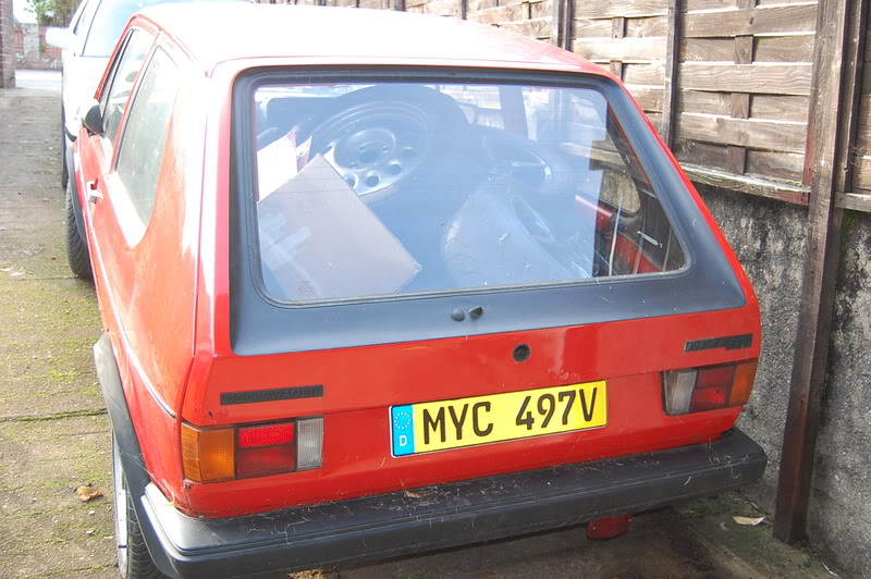

i know where your coming from, that pic i posted of the red one is a pic the previous owner sent me, its already been stripped of everything worthwhile. the front is rotten, even though its been replaced at some point, the sills have been badly repaired, the doors aren't brilliant and even the rear panel is going to need work before its fitted to the silver one, there has also been rollcage points welded in other dodgy repairs. the silver shell is defo the better of the 2 but only just.benandemu said

And i'm not killing 2 cars, i planing to bring 1 back to life. i would be willing to swap the red shell for a good rear panel if any one has 1 and wishes to swap it for an early shell…just to keep all happy…but remember saving 1 is better than scrapping 2, which is what i'm sure would of happend if i hadn't picked them up.. :dontknow:

small rear light model
stripped inside.
shell has rotted in most of the normal spots, has had rear arches welded in and front end, sill repairs and a bit on the passenger foot well.
if any one's intreasted then let me know..
