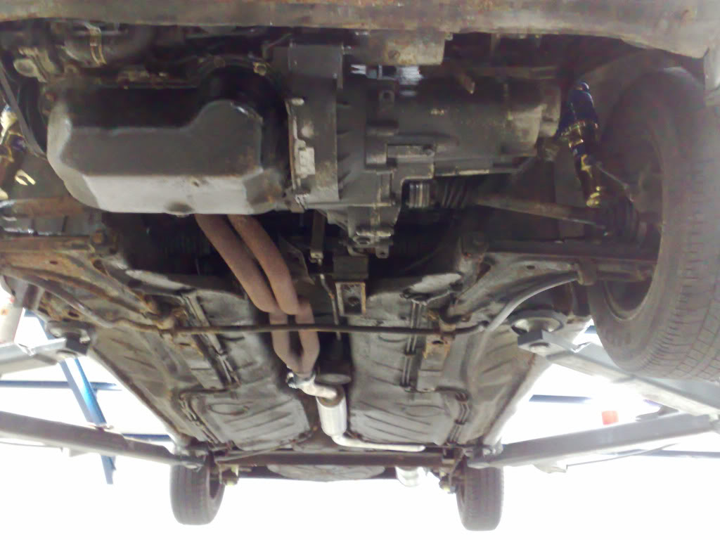

these are sum piks of her up on a ramp for 1st inspection and to fit sum nice shiney new fk sport edition pro coilies with adjustable bump and rbound settings.
rusty sills are never a good sign.

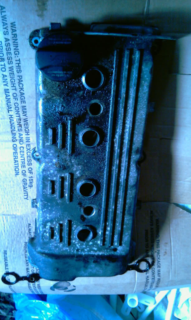

heres my rocker cover when i got it.yuk
back from sand blasting and a lik o zinc primer paint

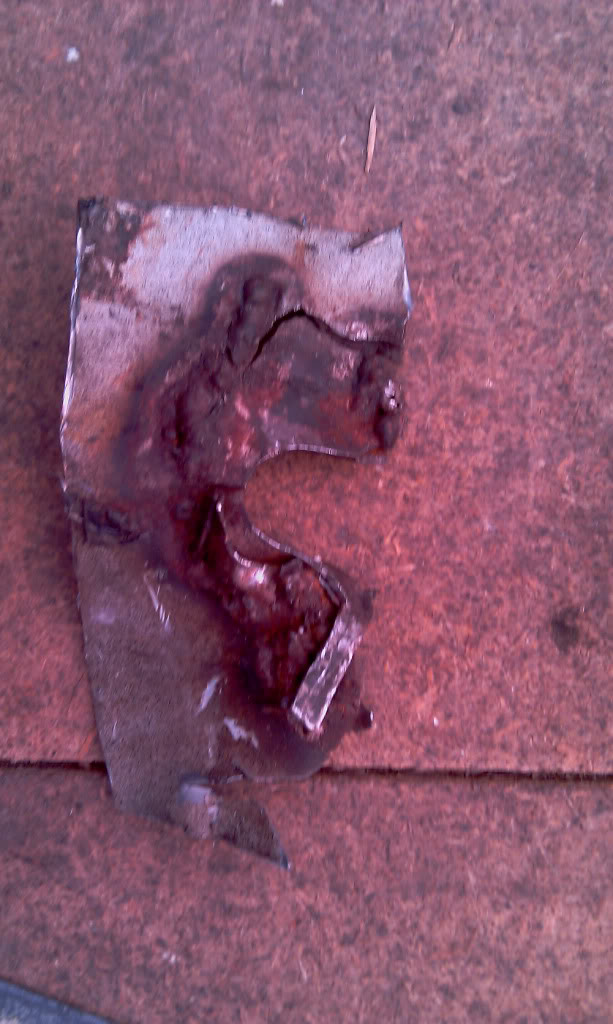

been workin on the bit i cut out aswell. need to relocate the chassis number that is printed on there, havent quite decided where its guna go just yet but woti did know is that it needed to be a different shap to what it was. if you guys know where its located then ull know that it is just above a nice bend in the panel.great place to put it. so i set about cutting out what i needed.gave my self enough room round the edge to work with and stripped all the paint off. i then spent the whole hour of my lunchbreack hammering it flat tryin not to damge the lettering.came out pretty well.needs a couple more taps here and there though but will do for now until i know where im puttin it!

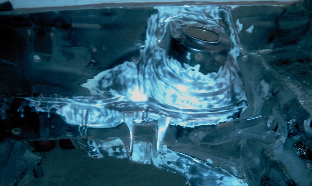

removed a couple of brackets from the bay and the remnants of my scuttle panel. had a go at the battery tray butt didnt get it all out. does any one know if its spot welded in or wot or do i have to just cut it out as i dnt wana damage the mount or chassis.
removed the bonnet catch and gave it a wizz with the wire brush and found a couple of holes. it rusted where the front panel middle support bits are.worse than the pik looks too! doh! if i find much more rust on the front panel then i have already im contemplating replacing the whole thing. nite end up quicker than repairing loads of small bits!
the o/s bay so far
