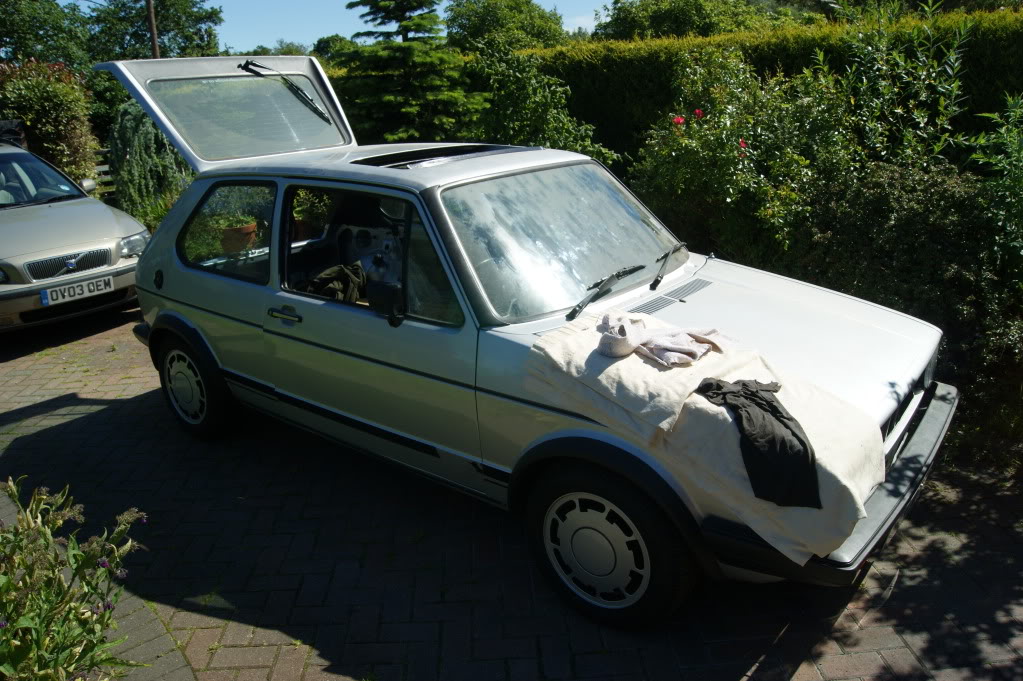

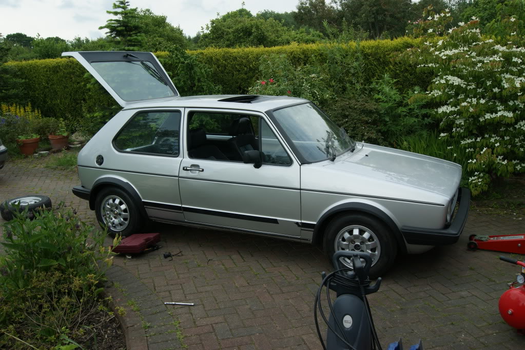

How it looked when i roled it out yesterday morning:
Pslots replaced with Tarantulas
Seats, carpets and belts back in
Grill that I reconditioned at some point in 2008 back on the car this morning and with batery charged it started first time having not run for well over 12 months. Engine is hunting a fair bit, I'll drain the tank and stick some fresh fuel in it next time it's out before looking for another cause for that.

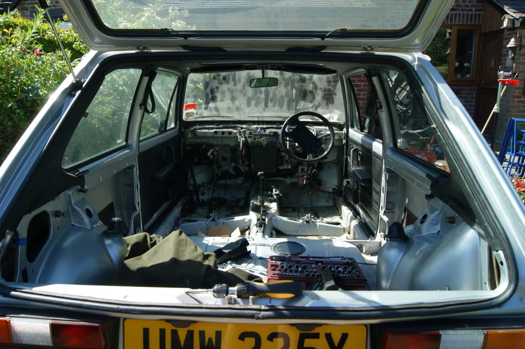

Dashboard is back together and it actually feels like a car to sit in again. It hasn't run since 2011 and that was for 5 mins, previous to that was 2006/7ish I think so I'll be draining the fuel tank and sticking some oil down the cylinders before giving it a go. That's the plan for this or next weekend.

A few more bits of the interior successfully back in which is taking a while due to having put all of the fixings that I took out of the car in a single container with no labels.

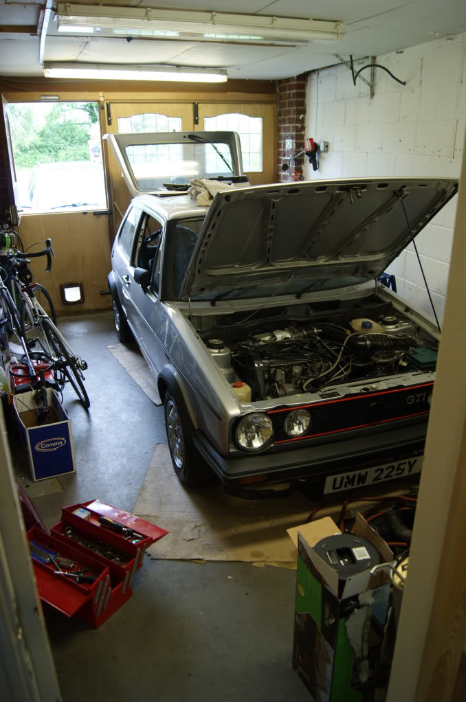

Used a 53 relay to prime the fuel circuit rather than having to do that on turnover, that worked really well and the golf spluttered into life once it was all back together. Only on 3 cylinders to start with and with fuel leaking from both accumulator hose and from the union on the end of the fuel pump but a good clean of HT lead connections, plugs and distributor connections got it back running on all four, Horray!!! Decided to leave sorting the leaks for Sunday.
Proof:
Driving car back into the garage under its own power was absolutely brilliant and meant I could get much better position so today's weather hasn't been a problem as I've been working in the garage.
Couple of new hose clips sorted the leak at the accumulator and did try some new compression washers on the fuel pump. Couldn't get hold of copper at the local motor factors and the result was a huge puddle of petrol in the garage (wife not happy with the smell!!!) Eventually I tried to re-anneal the washers to see whether that would make a difference. All back together and and it runs without leaks.
Only downside was putting my screwdriver through a patch of rust on the drivers sill. Will need to add a bit of bodywork patching to the list of pre-MOT work. Couple of steps forward and one backwards.
