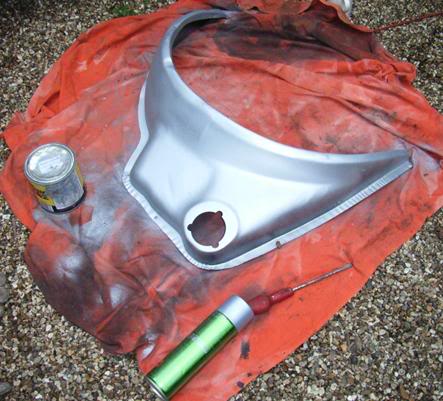

New inner arch panel.

Anton - think filler panel is 91-22-538 - receipt not totaly clear. The Hadrian panel website doesn't list all the panels they can supply. If you find a dealer they should have a catalogue which shows many other mk1 panels available.

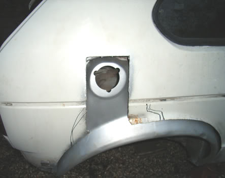

Strating to see the end in sight. Got to fit the fthe outer rach and a bit of patching, then can start refittig car up to get back on teh troad - been a long time.
Panel cut for filler panel
Panel being tacked into place
Welding completed and ground back
Panel with a bit of filler and paint for protection.

Crazyquiff - not really any probelms with distrortion. Just a case of slowly tacking around the panel and gradually filling in with weld ensuring there is not to much heat build up. Had more problems shaping the replacement panel to follow the body line.

ha yess right and as you surely know it`s no easy too use grinder there.Unfortunely i didn`t found any repair panels for this section so i used old one from other body i had before but it isn`t imposible to do it yourself only you need to be patient in forming
greetings and all the best in restoration!! :y:
