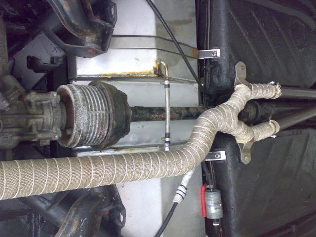

Running Rallye 4wd system with modified prop/driveshafts

Some pictures of the 4wd system

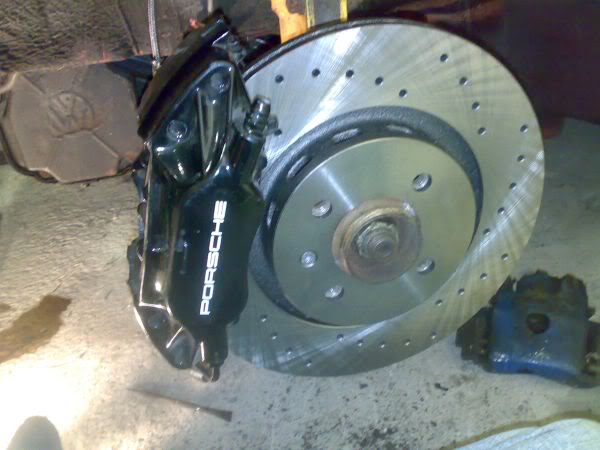

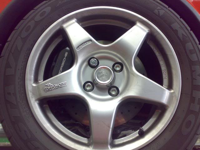

After the wiring was sorted I decided to get the brakes done so went down the Porsche route (996 rears). The car has done away with the servo and bar and runs a pedal box with independant master cylinders. I have tweeked these and fitted a Wilwood rear bias valve and the brakes are a lot better now!!! This caused a major headache of trying to find 15" wheels that would fit over them, but got some compomotives that JUST clear!!
Really wanted to keep the stealth look, and make it look innocent so a set of 16"s were out of the equation!

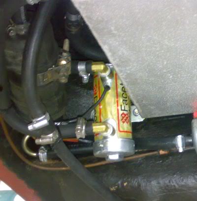

After eventually getting the car done and running, I noticed some starvation/hesitation and realised that the custom tank had no lift pump/internal swirl pot. The next job was to fit a Facet Red Top, and a swirl pot, and since then the fueling has been spot on even on low fuel loads (like 2 litres when sprinting at Inters!)
