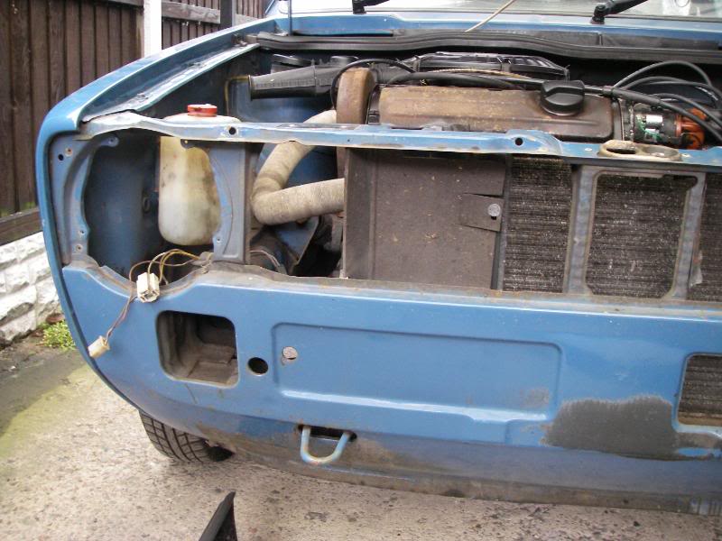

I took the bumper grille and lights off to start as figured this would be easy. it was didnt even need and wd40.
despite being 33 and having owned quite a list of cars ive never really done anything too any of them. I acquired this car for a very very small amount of money (keeping it secret so i dont get linched!!) so im going to tackle the whole project!!
In that light expect a LOT of questions, i know the dub scene is full of lovely helpful people. please point me to threads for questions that have been asked before.
so question 1! how many bolts should i be looking for holding on the front wings? i have taken out 7 so far and think they may be 3 more hidden under mountains of sealant on the inside, is this correct?
will post pics of all the rusty bits tomorrow and what ive yanked off so far!!
This is of course on top of the ones on top of the wing in the engine bay and I think one at bottom front bolting it to front panel.
Hope that's right - don't tug too hard in case I'm wrong!

as you can see i have some work ahead of me mainly complete rear quaters on both sides one new wing (the other one might be reacently new as there was no sealant at all!)
Some of the bodywork is in really good nick for its age. I think it has been used mainly as a farm run around and then sat stationary in a damp barn for the last 4 years. yes its and actual barn find!
I was toying with a complete colour change but as some of the paint is still pretty good i think i will stick with the blue, especially as im planning on doing everything myself, its going to be a steep an probably slow learning curve but im having a blast so far.
where is the best place to get repair panels and wings from? And what do people use for sanding back the body work, I dont want to be pouring chemicals all over the place if i can help it.
