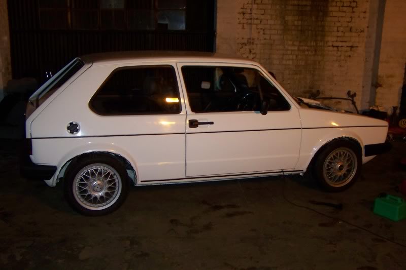

I bought the car as a project, non runner so was a bit of a gamble but after looking at the body and extras it came with i though, what the heck, i'm gonna buy this and have some fun!!
Spec:-
1983 Y reg golf driver
1.8 kr 16v engine
twin 40 webers
Alpha mangement
lowered (unknown height or springs/shocks)
Alloys (fake splits
Interior is part stripped, fully carpeted but only two seats
plans are to try have it running by this weekend 12/13th september and have it mot'd, taxed and insured by next weekend!!
Current state, engine all striped, just drive shafts and engine mounts to come out, cleaned the bay a little but will wait till i build a new engine for it before stripping it right back and doing it properly!!
Need a few things, posted in the wanted section if anyone could help…
heres the good bit, pictures… (how i bought it, looks the same but with no engine lol)
i will put up updated pics as soon as i get my camera back off my girlfriend…
cheers and hope you all like
stewart

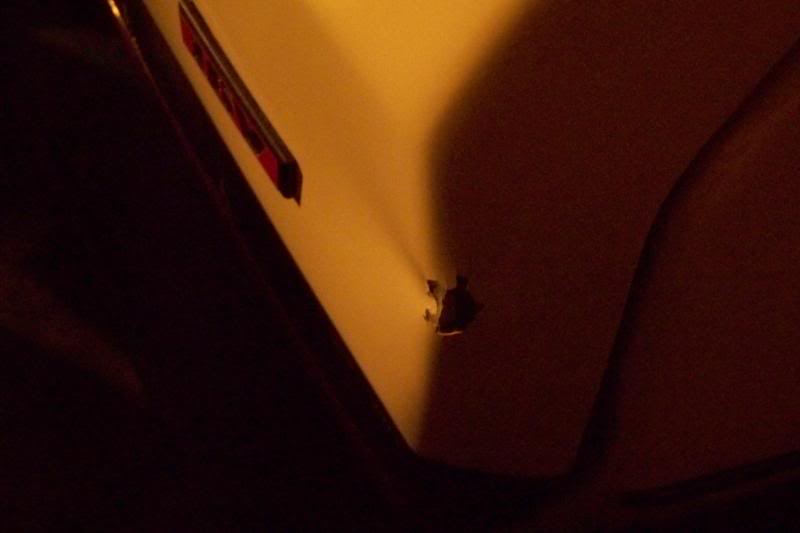

Bad points are that i took off those plastic arches and there are little rust bubbles (nothing major) but the worst bit is, whoever stuck them on used mastic, raging as wanted to take them off and put on the little spats…
how easy is it to scrape it off, mask up the are and then try spray, blend it in, will it look gash, the car will probably be getting sprayed next summer anyway

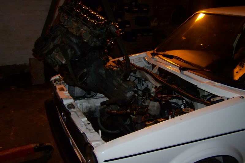

finally got the engine out of the car too, manage to get the engine crane and get it out myself, which was a little tricky getting it past the brake pipes, but heres the pictures to show the progress
Engine coming out,

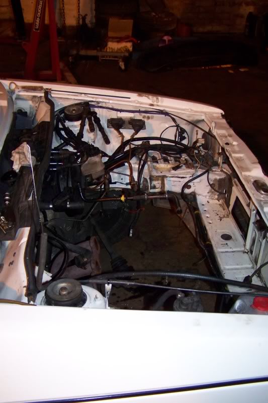

Bay as it is now,

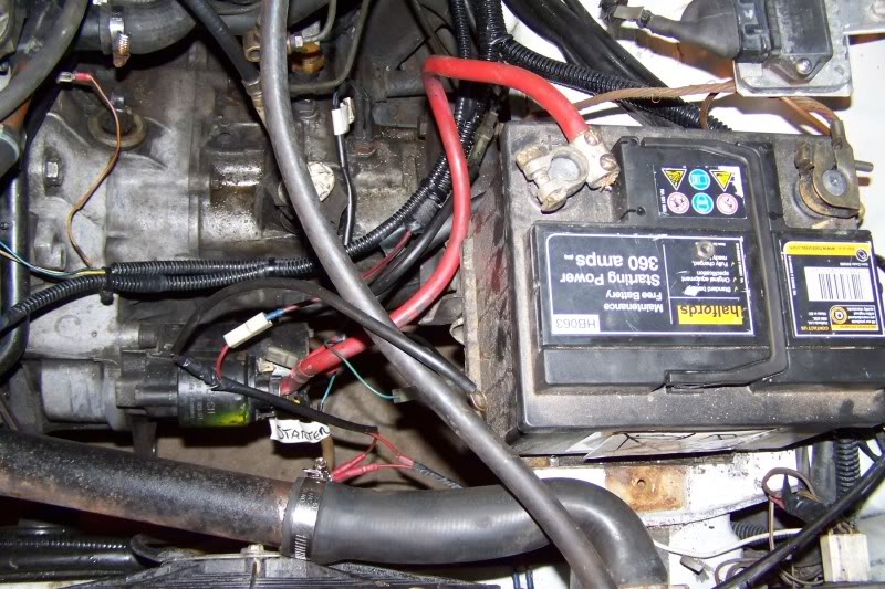

Bolted up the exhaust manifold, filled with new oil and filter, put old fan belt on which will have to do for now, found out the air filter is totally beyond it, its cooked at some point and has gone brittle, no wonder i got the car with a fooked engine!! Bolted rad to body and then connected battery, found out that the starter has a constant feed and wont stop trying to start the darned thing, so for the mean time disconnected the solenoid thingy (technical here)..
Then checked all the lights and horn and surprisingly, it all worked, but when i stuck the ignition on, what's that i hear, splish splosh splash, more liquid coming out from the engine bay, but this time it turned out to be fuel from a knackered o ring on the carbs!! But mate coming to the rescue tomorrow with o rings and a gaiter for the cv, so there we go, almost started, here's some pics of my work so far…
Cheers to dubhighland for the windscreen
And i know the wiring is a mess but just want to get the thing running and then sort out all the niggles, hope you all like!!

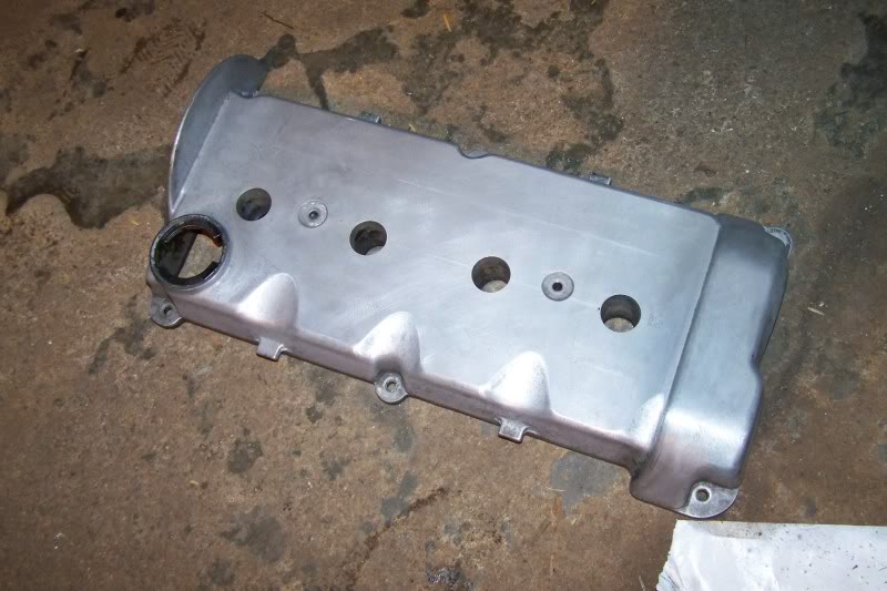

Niggle 1, put a new rocker cover on it and when i came back i noticed blue smoke under bonnet, opened bonnet to find oil all over timing cover, worst thoughts crossed my mind but in the end it turns out i rushed the rocker cover and the rubber gasket didn't seal right, sorted!!

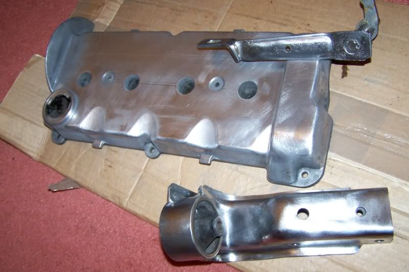

First is of some polishing i had been doing waiting on parts to arrive, this was only a quarter of the way into it, still not finished them all but they're all on the car now, will finish the rocker cover soon, it does look awesome just now though i have to admit (not from this photo as i spent another 5 hrs on it after this), for a first go at polishing and 6 hrs of hard graft…

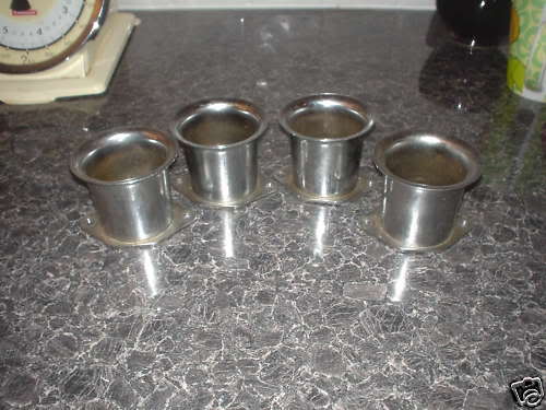

These are the ram pipes i got to replace the K&N filter which didn't fit, the old single filter fitted because it was almost oval, the K&N being square… I still have to buy some socks for them though and fit them, hopefull my mate will have the small bolts to attatch them on when i get back, after all he'd have had over two weeks to get them!!

Not touched the rocker cover since i did in December or probably even November lol, i haven't seen the car much either, looked/fiddled with it two days in the last two months.

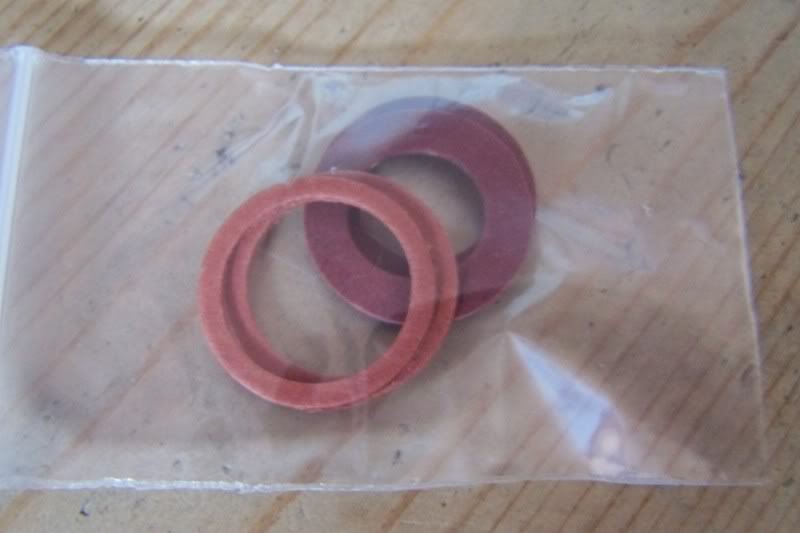

Then a wee while ago when i was putting the carbs back on i noticed an un healthy washer, it was a paper type one and no one i knew has one so i stuck the thing back on without one and it worked ok, but looked them up on ebay and came across these which are the ones i needed, so £3.60 later they arrived today which ain't bad considering i ordered them at 1.30am Friday morning…

Then it was onto getting things looking nice, the polished rocker had gone all poopy due to lack of attention, looked like it did before i started it lol, but few mins later, it looked good again.

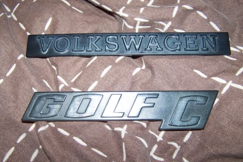

I have also been buying a few badges, got a 'volkswagen' one as a previous owner had painted the background silver and letters black, looked horrible… The car right now has a '16v' badge on the back, i am either going to replace that with what was originally there, a 'golf c' badge or the 'rabbit' badge i have, although i think the rabbit badge would just get nicked…
any ideas of the easiest way to get the lettering on the badges silver again, if i go near it with a brush i'll wreck 'em…

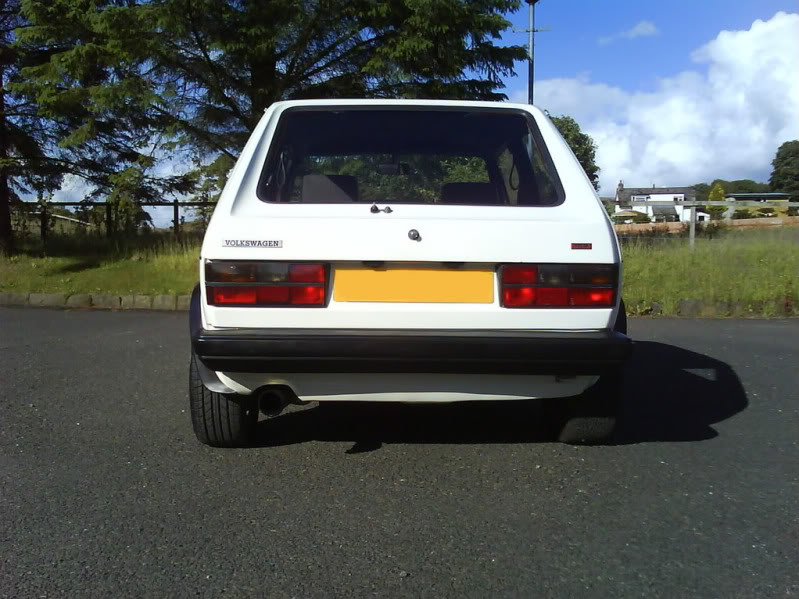

Bad news, she failed her MOT yesterday… the not so bad news it's all pretty easy fixes, i hope!!
1: Very small split in the sill within 300mm of suspension mounting point, in this case on the sill where some c0ck has previously jacked it up, so have to do a small weld there, and the suspension point being the ARB!!
2: Directional tyre on wrong way, oops lol
3: headlight on passenger side not forming a bean pattern, hopefully it's just the bulb not seated correctly…
4: Rear wheel bearing needs tightened.
5: emissions..
6: cant remember!!
So today's list, sort out parts needed, i've ordered a sytec fuel pressure regulator as the MOT testing guy says it's well over fuelling which is what i suspected, ordered it special delivery so it arrive tomorrow, hopefully that will sort emissions, if not he's going to manually turn down the fuel on the carbs so it passes!!
Find someone to weld the sill, i welded the exhaust myself but that's easily replaces, sills are a little more tricky!!
All the other stuff should take a few mins each…
But what a journey getting to the MOT station, first off i ran out of fuel which i was kind of expecting to happen and being no petrol station where the car was, well i had to chance it, so a mile down the road (MOT 10 miles away) it happened, luckily my mate was travelling behind should it of happened, then get to Gartocharn petrol station where i decided to put in super (at 1.26 per litre)!! and started to fill up, half way through filling the station runs out of fuel, typical!!
Get it going again and proceeded on on journey, filled up with £20 in Balloch and carried on, heard a slight knocking noise so pulled over, got out to find my wheel nuts loose on front nearside, oops!!
But apart from that, it ran sweet, a little bit stuttery at lower revs due to over-fuelling, but no oil/water leaks, temps were all good, so once the regulator is on, it'll be ready to fly!!
Was so good driving a mk1 again!! GF doesn't like it, but its not hers so screw her lol!!
Thats all for now, hopefully post back up on Monday with a fresh MOT

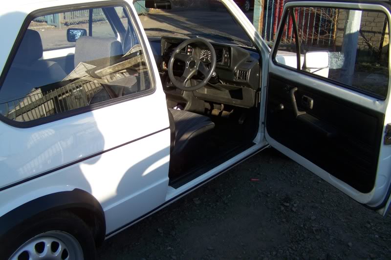

just a wee one of interior and door…
