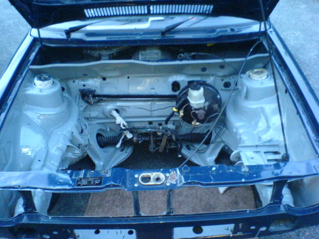

I steam cleaned the engine bay and the wiped it overwith petrol too remove any wax and grime. I then went over the whole of the bay with a whire brush on a drill to remove the shiny surface.
I then had to fill a few places and tried too smooth off a weld done by the previous owner on the right of the engine bay. I put two coats of galvafroid on it and then painted over with International Danbolie Marine paint wich gives a nice shiny surface.

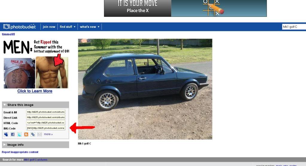

Do u know how too get the pics to show instintly and not have to go on the link??
anyhelp would be good
The more you earn the more you spend on the car - problem is both you and the car always seem to be broke!
To put an image up you need to put image tags around the URL of the picture, i.e. [ img ] http://examplepic.com/piccie.jpg [ /img ] but without the spaces.
Photobucket does this for you when you upload pics, so you just need to copy the right code from the box and paste it into the forum without changing anything. It's this one vvv

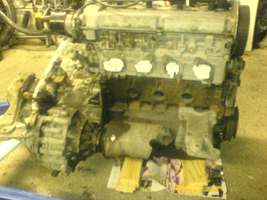

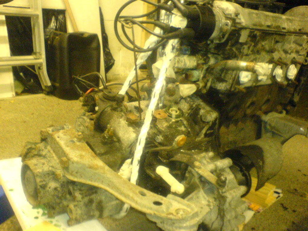

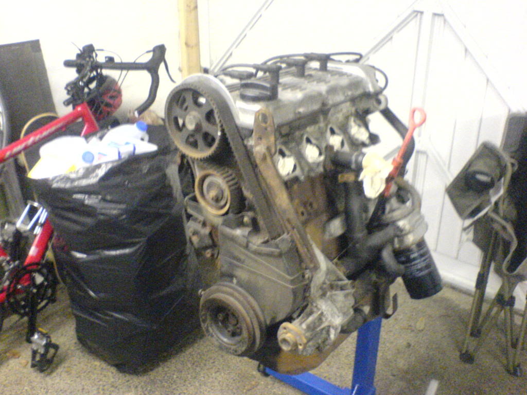

thats the engine just after getting out of the old mk2
another of the engine after getting it out
engine on the stand after splitting off the gearbox

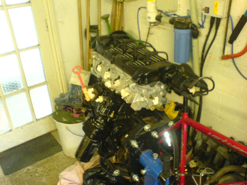

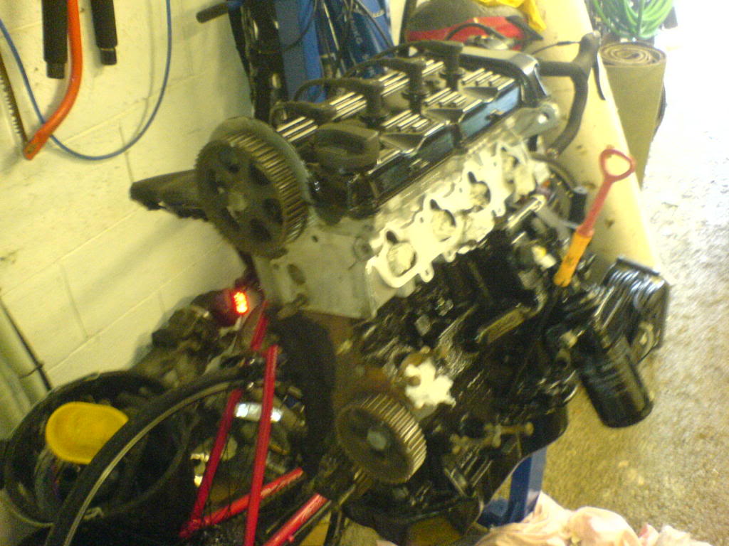

Here is a few of the engine after the painting and a lot of cleaning
engine painted black and the head silver
just a bit to do on the pulley end of the engine

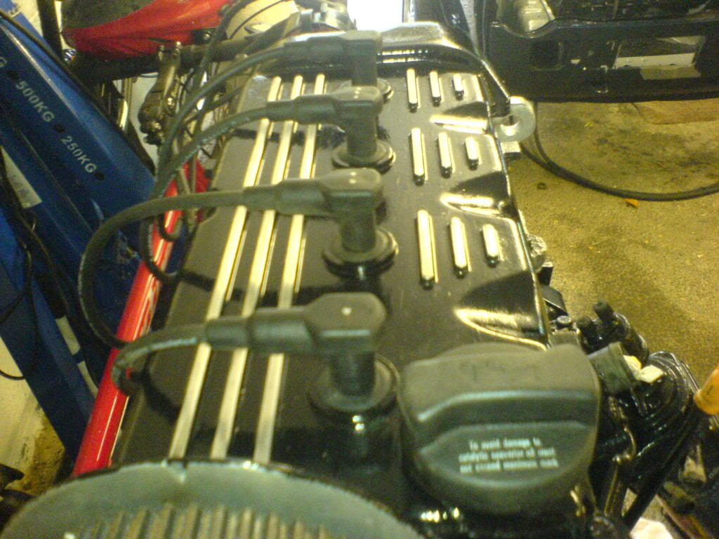

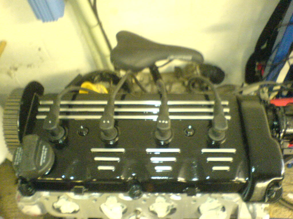

rocker cover painted black then sanded the strips down, looks great in my opinion…well worth the effort!!!
another of the rockercover!!
I think overall the engine looks quite good…we need to split the head off the engine before putting it in to fit more parts that are below.

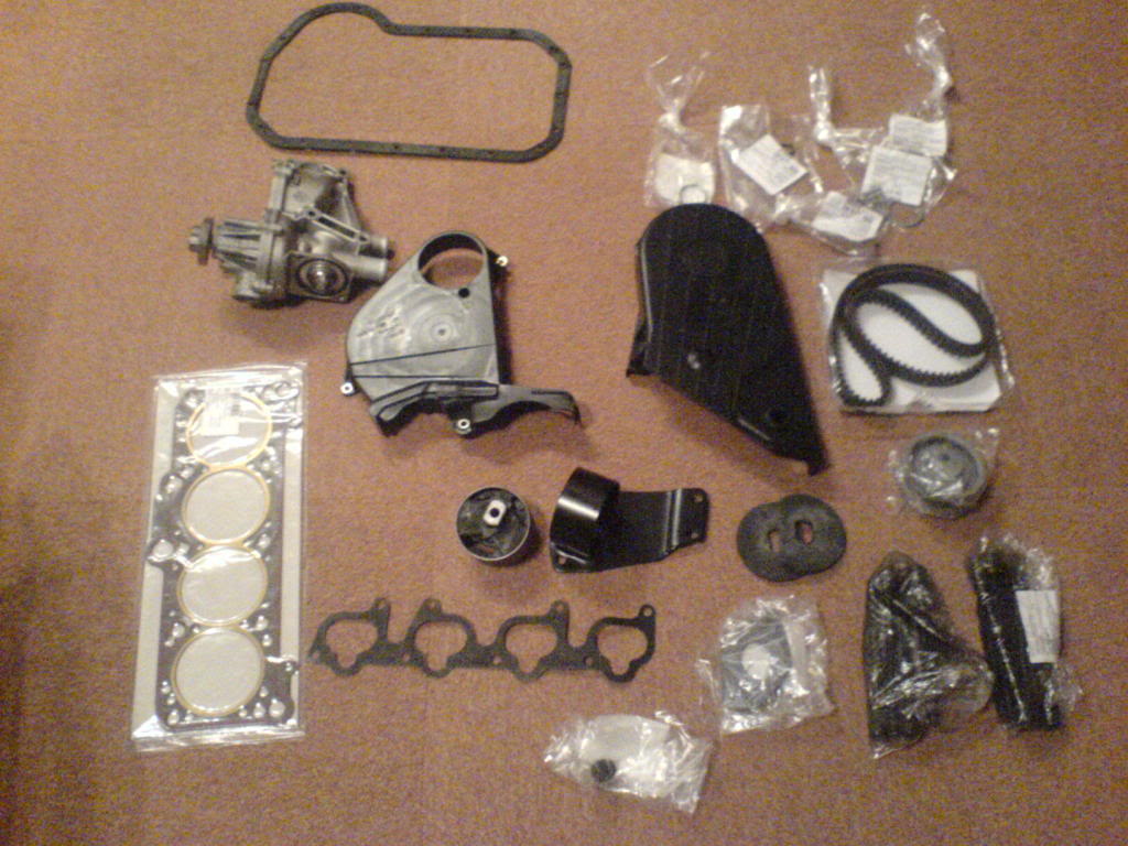

Heres a pic of the newly arrived parts all genuine VW stuff!! :)
Parts are:
exchange water pump
thermostat
Head gasket
Head bolts
sumpgasket
cam chain
rockercover gasket
cambelt
tensioner
new engine mount with rubber and outer plates
Pulley covers
and a load of small gaskets and bolts

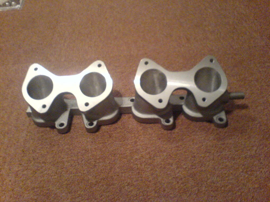

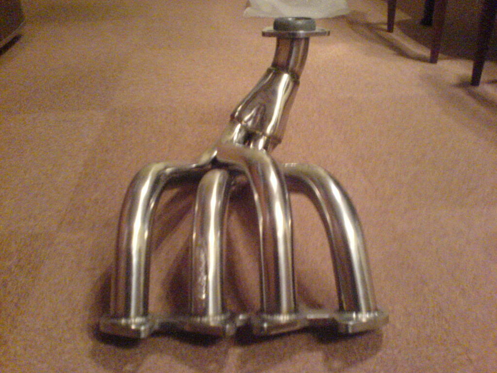

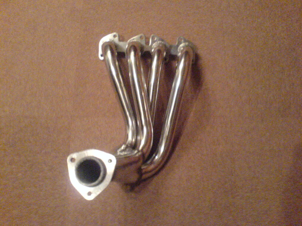

I have also got a Mangolesti manifold to mount the carbs on  from Demon Tweeks
Weve also bought a DubSport 16v conversion manifold which looks great!!! :)

thats the engine bay painted up looks quite good for brush on job!!
Painted the brake servo and mastercylinder as well know. Try and get a pic up soon.

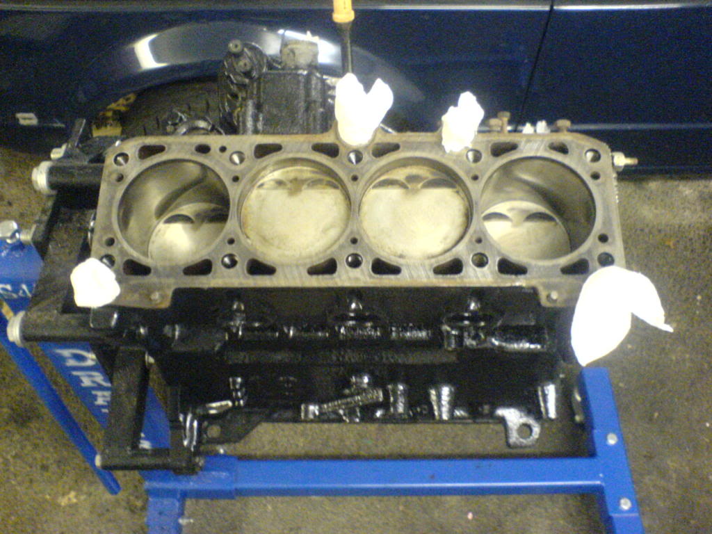

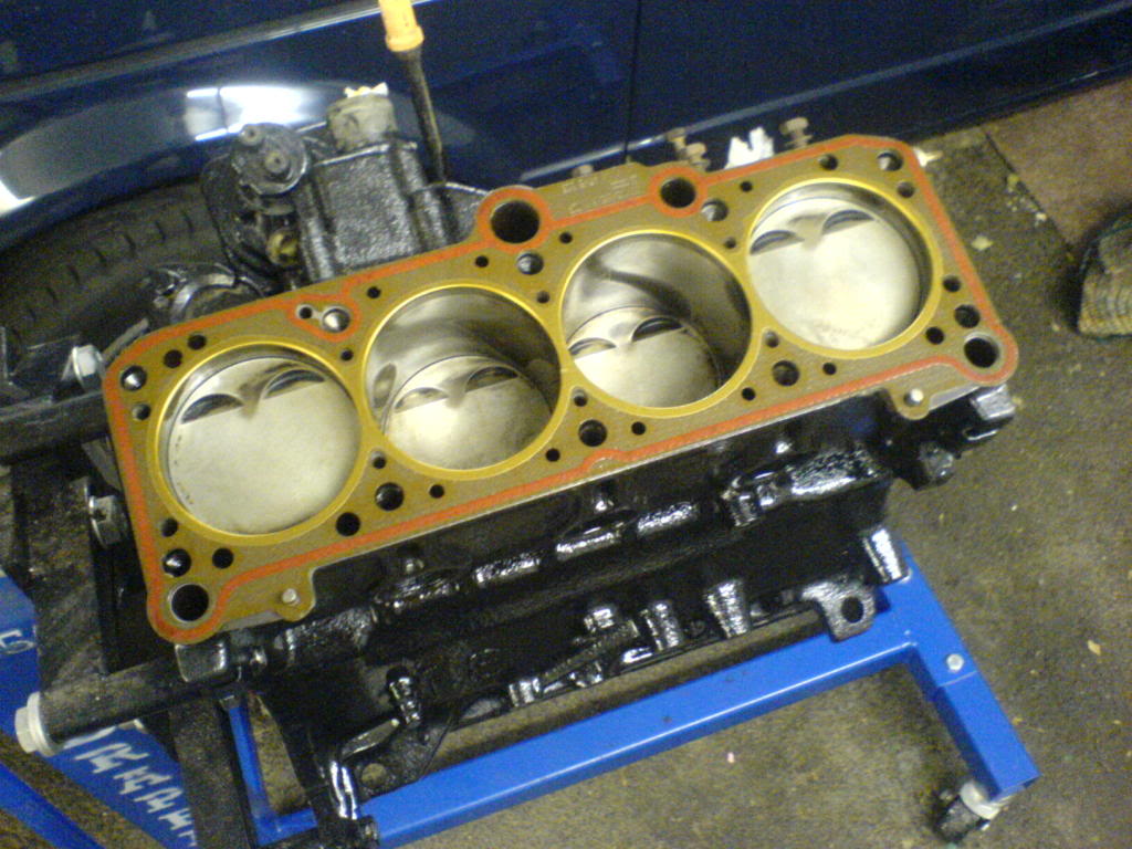

Right….Ive got some pics of the engine rebuild which we did over the past three days.

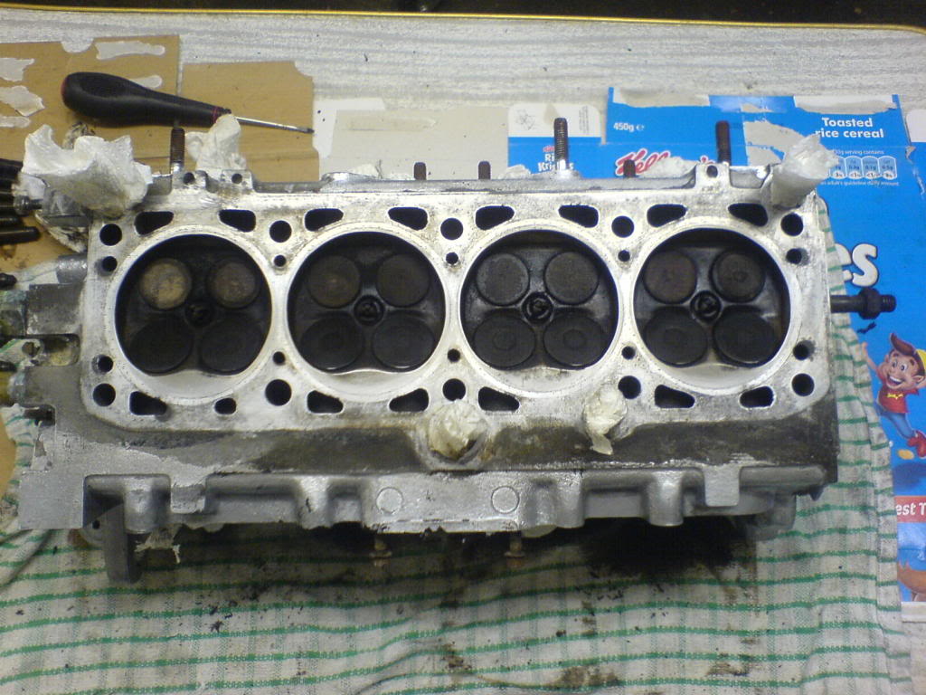

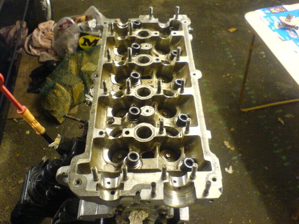

Cleaned up the surface for the new head gasket and checked the valves.
Cleaned up the top of the block and  cleaned and checked the pistons
Fitted new genuine head gasket
Re-fitted the head on the block with new head bolts
Re-fitted and checked the tappets
So we are hopefully going to re-fit the cams and the new chain again after a little problem the first time!! :) And also the new timing belt. After that engine blocks basically finished, Need to service and rebuild the carbs and get some new jets.

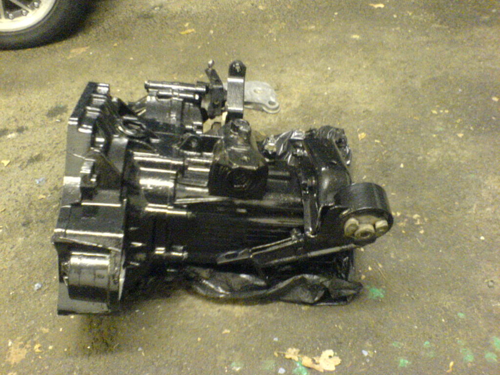

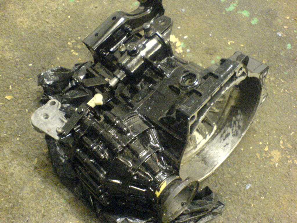

Also cleaned and painted the gearbox up…think it looks quite good (pics a bit hopeless but there we go)
Needs a wipe over (looks a lot better in person)
Also need to grind off the MK2 rear mount and fit the mk1 mount
So as i said next job is to finish off the engine bay and get some gromets for some holes here and there. Then service the carbs and drop the engine and gearbox in :)
