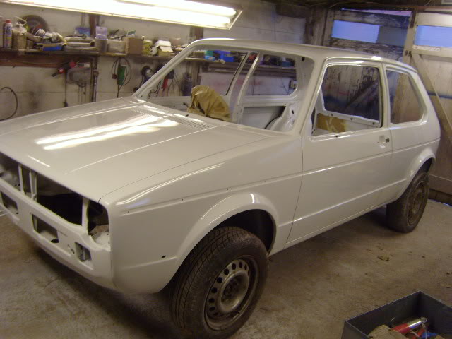

Getting started on the body.
Then abit of colour, i went with mk5 golf candy white.
Windows in, new front screen.
Then home, and a quick fit of the wheels, 13x8s.
