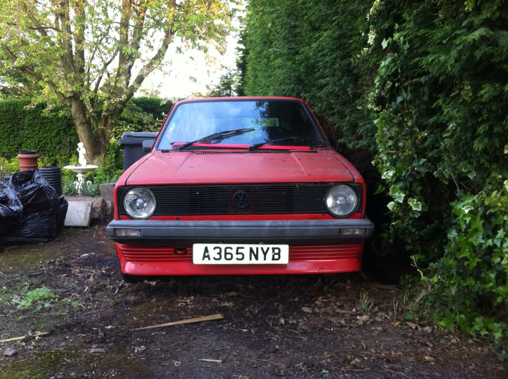

It came with the bbs kit with both boot spoilers not sure if there bbs or not but I dont like any of it so I've removed it all I didn't like doing it because I was scared what to find but I'm very happy with the condition for the price
My plans are to weld by chopping and replacing with fresh sheets or replacment panels, filling as many dents, painting it myself mars red this might change, coilovers, and bbs Rs 15x7 wheels
I will be doing the work myself
The interior is all mouldy and it smells alot inside but all there apart from parcel shelf and fog light switch
When I had a look at it from what I seen its pretty solid the o/s inner sill has some corrosion and outer sill same side has been replaced but seems to be over the old one gutted about that but can't see any other bodges, after removing the kit I inspected the rear arches and the n/s arch the seam has rust inbitween both skins the o/s arch is abit worse only seems to outer arch it's gone through in a couple of places till I start cutting the bad parts in not going to know
After that I removed the front plastic inner trims and lets just say I'm very happy with the inner arches will remove the wings soon to check better, the front valance is very good with only surface rust and the rear valance is even better
The boot needs a few holes welding and the windscreen theres two rust patches but not too bad

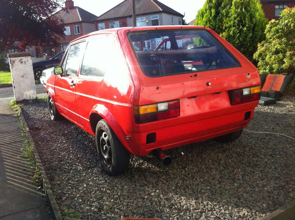

Also managed to fit the other front coilover there on there bumpstops thought they would go lower and I don't think my alloys will fit because of there offset will try tomorrow
Heres the pictures from today
You need to clear the scuttle drain holes at either end and get a scuttle cover tray, it covers the plastic motor blower cage in the scuttle tray, the water will be getting in there for sure.
Check the door drain holes at the bottom and also the windscreen seal at the corners etc all common leak points.
An aqua Vac to shampoo the seats, door cards and vynil a wipe down with dilute bleach to kill the mould spores too. Don't get it on the fabric as it will ruin it lol.
Paint work came up lovely really, good luck with the project.

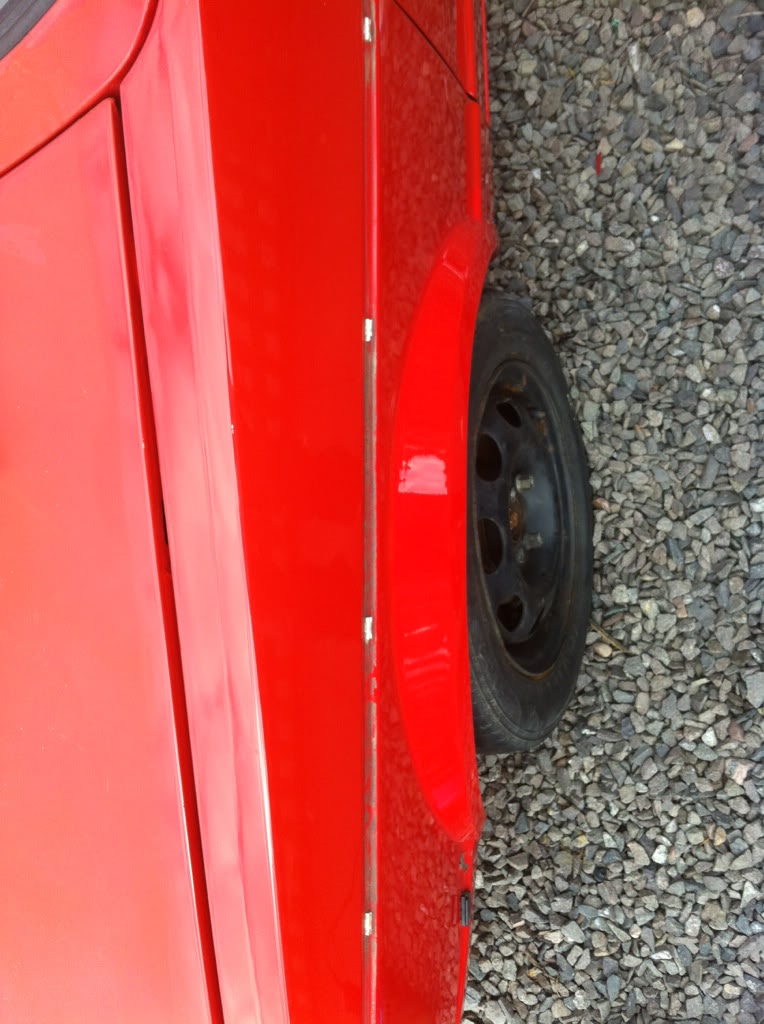

The paint looks good on the pictures but I'm not happy with it I was hoping to polish and blend the repaired areas into the old but where the old bbs kit was its alot lighter

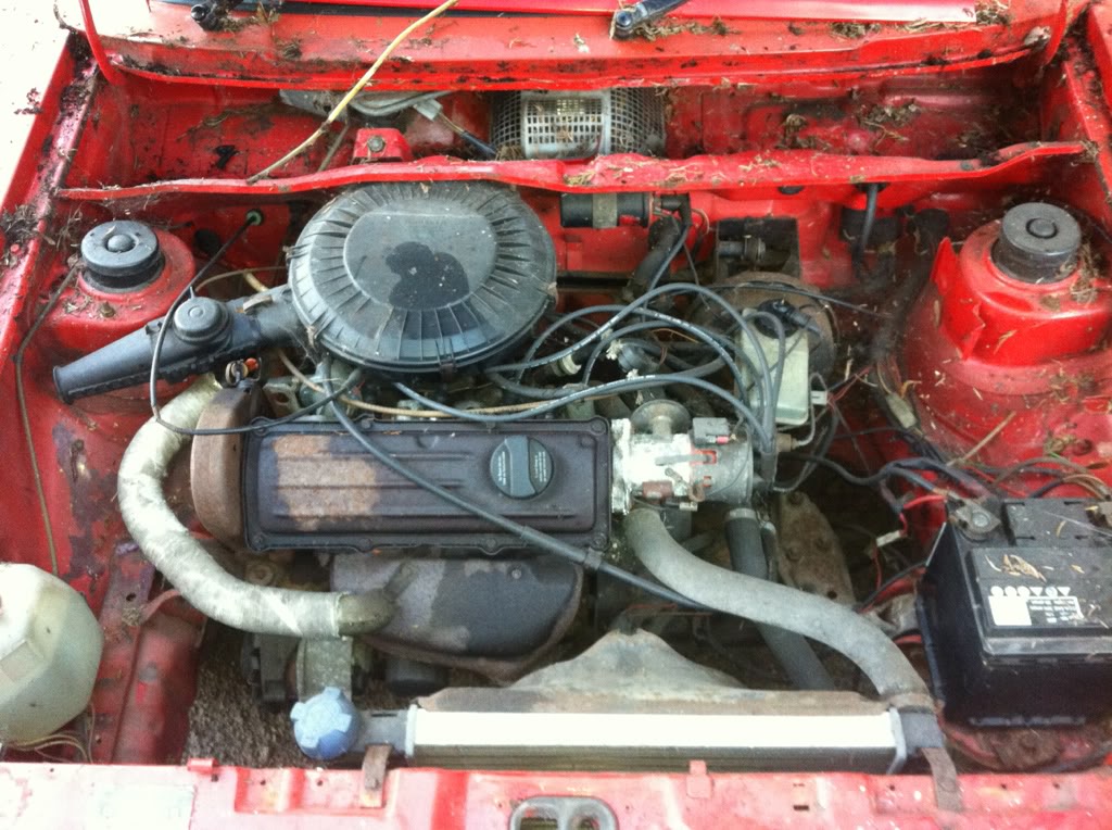

My plans are to make the shell as best looking as I can might smooth the scuttle tray and heaters and no engine coversion just rebuild and clean with bike carbs or a polo gt lump on carbs unsure what is a direct fit
If you look down the back of the engine, just above the steering rack is a little gutter spanning the width of the car. At either end where it meets the wheelarches/chassis legs there are holes usually sealed with fabric tape and covered in seam sealer. If the tape has split or come unstuck then water will pour through these holes as its right in the middle of a drainage channel.
You an drain it partially by removing the rubber grommet just behind the steering rack above where the gear linkage runs, the rest you'll have to get out another way
Good luck with the project!
You can see the channel running along the back of the bay above the rack, and in the corners at either end are the holes covered in seam sealer and tape. This will most definitely be where the water is coming in :wink:

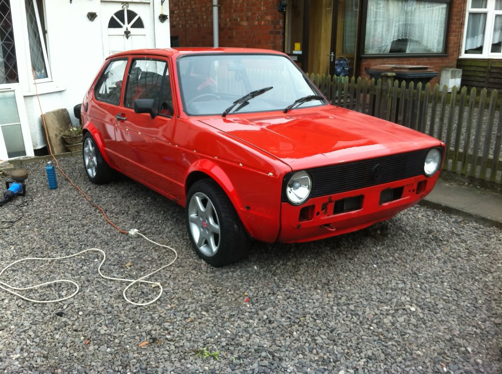

Got the pictures of the drivers side bulkhead theres something under there I don't want to uncover but it's got to be done someone loved seam sealer :s on the pillar I noticed its out of shape plus the door is dented around the area tomorrow we will find out aswel as the inner arches I will remove the wings and start grinding them back after I've swapped the shocks over from the polo and test the wheels I think the front will hit the coilover
Also in the engine bay under the mars red the original paint is a completely different red is the normal or has the hole front end been changed?
Today's other work is learning how to colour sand to remove orange peel to get ready for when it's painted, I used 2000g with soapy water and there's only slightly wavey but I'm happy with the finish
