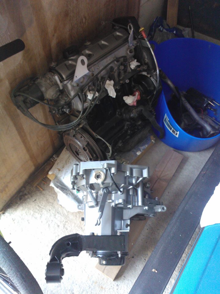

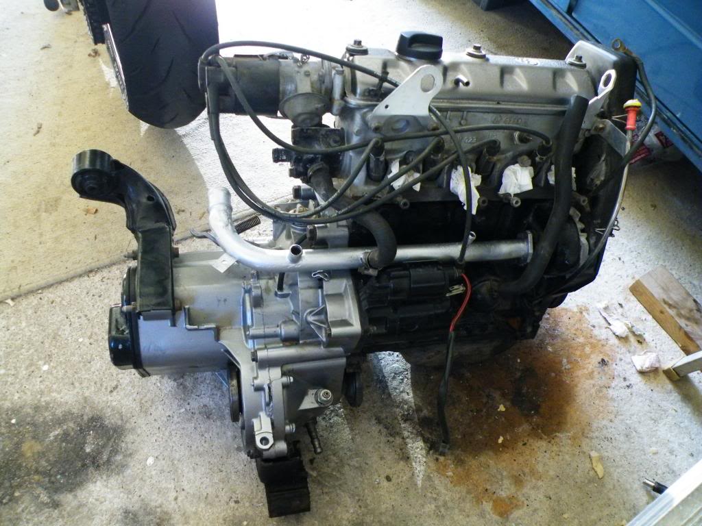

anyway onto the important stuff, picked up the engine gear box, mounts, drive shafts, gear linkage, gear stick, wiring loom etc everything i need to do the swap.
![](https://vwgolfmk1.org.uk/uploads/pbextract/1308298/mk1golf15_zps9e0c99a2.jpg)
really looking forward to getting stuck into this. its the first time i have ever done anything like this and i cant
wait to start it

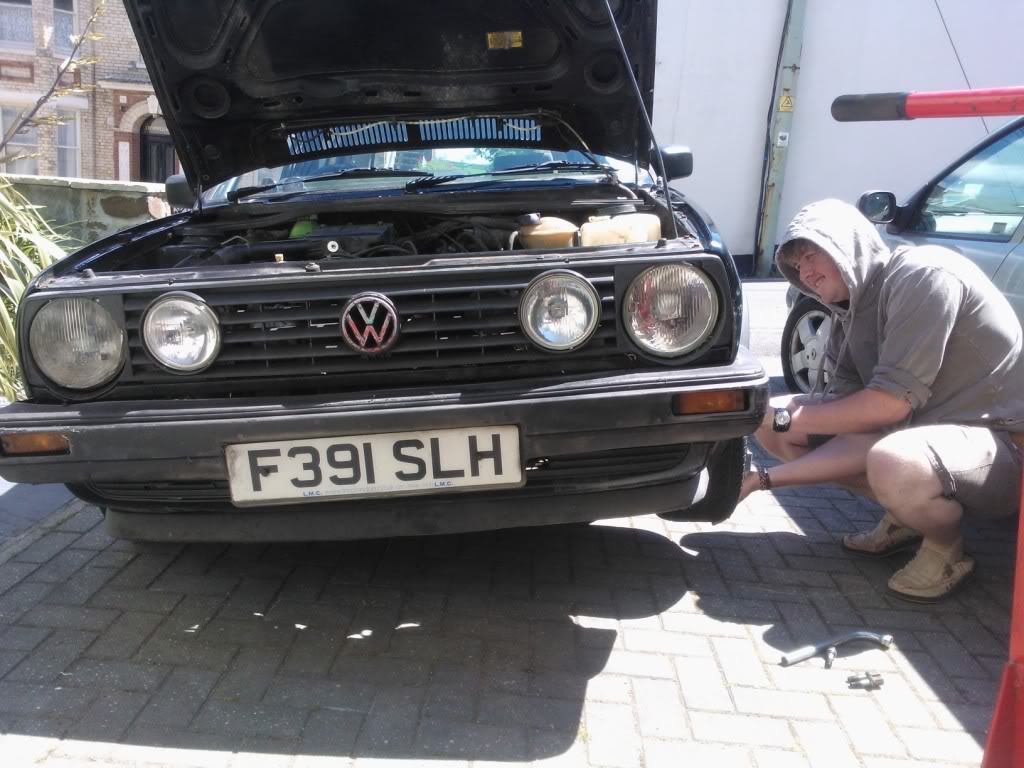

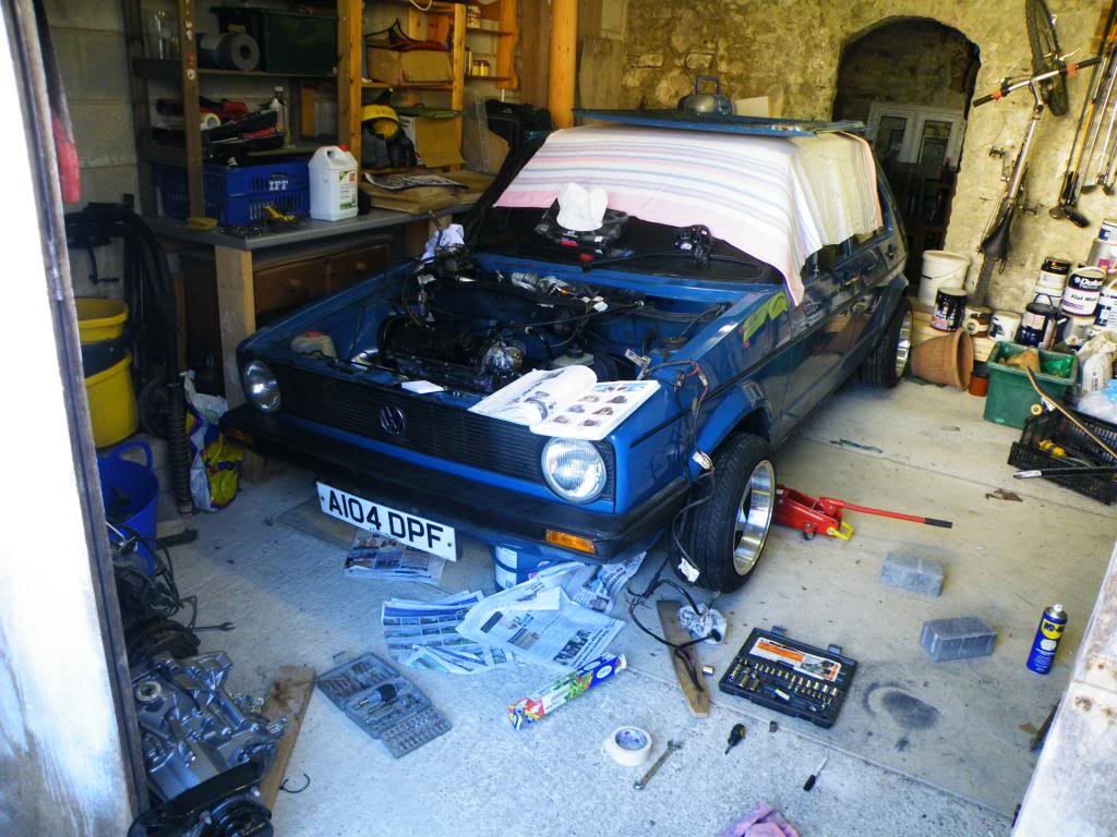

right so i went into barnstaple to pick up the tools i needed. could of borrowed them but it is nicer to know i have them now if i ever do something like this again.
while there i met my friend jack who came to give me a hand. unfortunately his mk2 golf decided to spit out its track rod so we spent the first few hours working out what was wrong and fixing that!
![:P](https://vwgolfmk1.org.uk/themes/default/images/ocf_emoticons/cheeky.png)

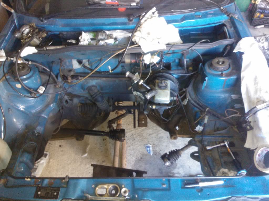

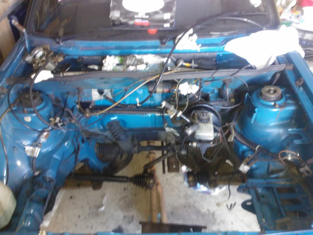

empty bay!
![](https://vwgolfmk1.org.uk/uploads/pbextract/1309269/WP_000877_zps51f27fc8.jpg)
gave it a quick clean as best i could
![](https://vwgolfmk1.org.uk/uploads/pbextract/1309269/WP_000880_zps05bd19a0.jpg)

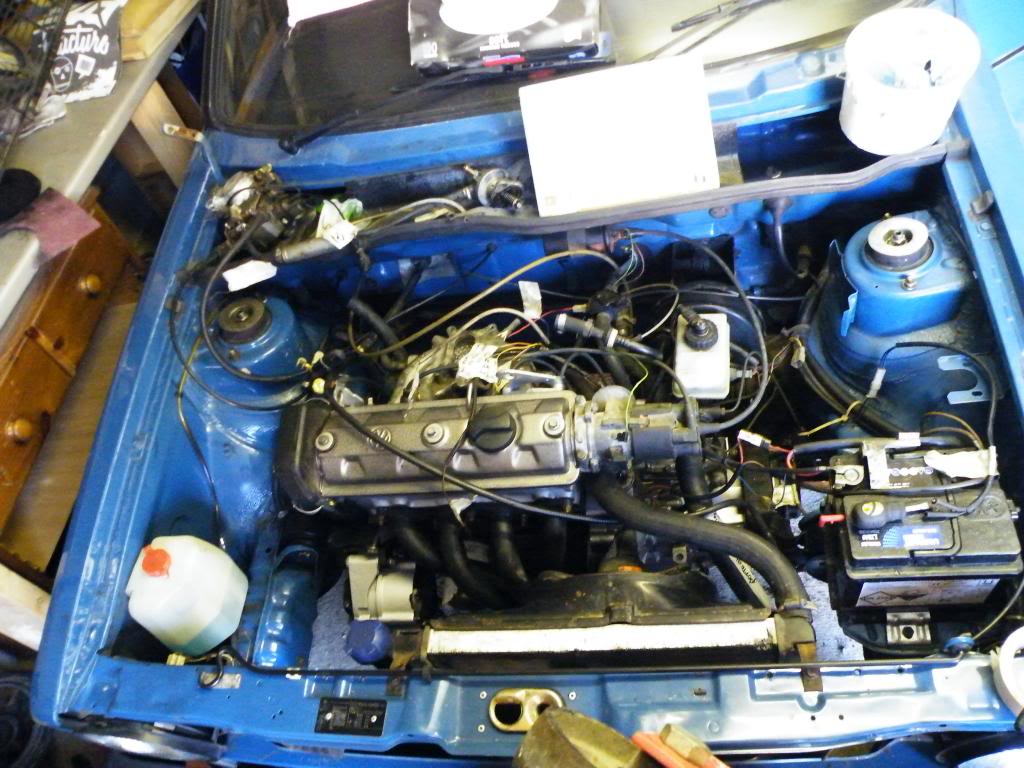

we started changing some of the bits from 1 engine to the other. had to modify the gear box mount to fit the bigger box but nothing a drill, a hacksaw and some swearing can't sort
![:D](https://vwgolfmk1.org.uk/themes/default/images/ocf_emoticons/grin.png)
i will continue cleaning the bay tomorrow and i will swap any part over that need swapping and that i can do on my own. might have the new engine in sometime this week if not it will be at the weekend hopefully

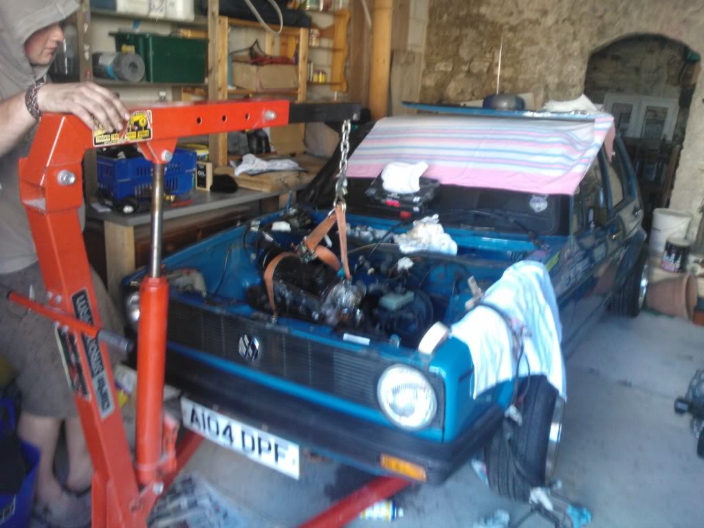

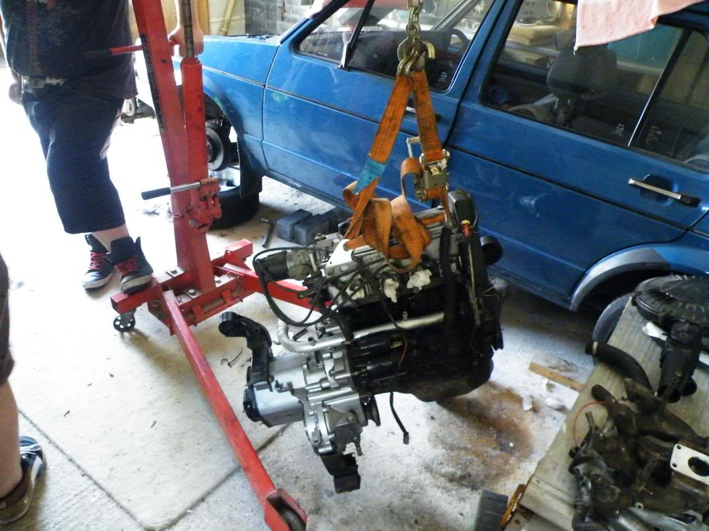

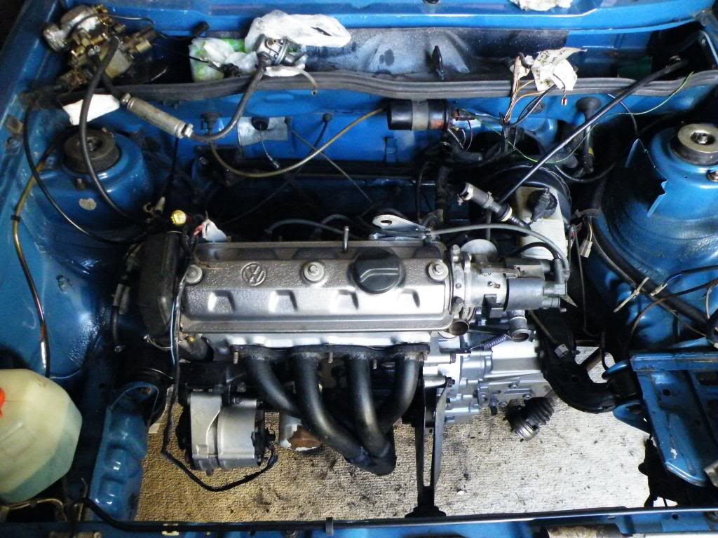

engine and gearbox now 1 component.
![](https://vwgolfmk1.org.uk/uploads/pbextract/1323884/DSCF2991_zps48b1b54e.jpg)
cracked out the crane!
![](https://vwgolfmk1.org.uk/uploads/pbextract/1323884/DSCF2992_zpsacf02413.jpg)
engine back in and all monts fitted and tightened up

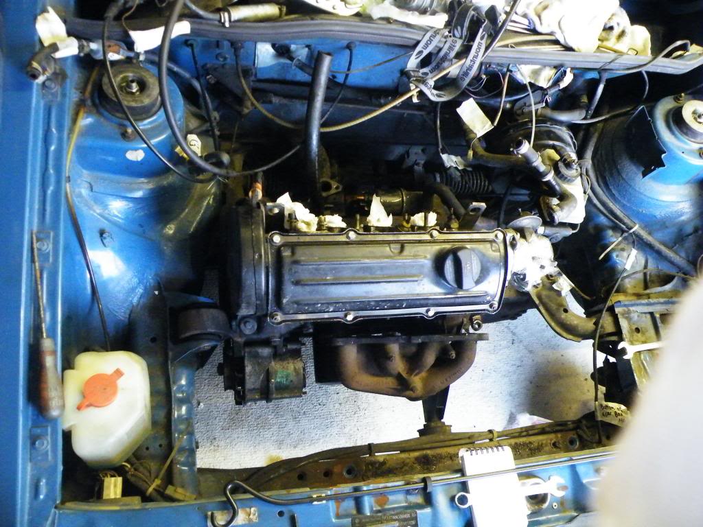

![](https://vwgolfmk1.org.uk/uploads/pbextract/1323884/DSCF2993_zpsc9f501b7.jpg)
rad back in, inlet manifold fitted and as much of the wiring plugged back in as i can do as some of the connections are in different locations or just not there.
![](https://vwgolfmk1.org.uk/uploads/pbextract/1323884/DSCF2994_zpsfea225eb.jpg)
on the look out for a carb that will fit a polo coupe inlet manifold. got to do a bit more wiring. also got to modify the gear stick to accommodate the 5th gear (not quite sure how to go about it) but im getting there and for an afternoons work im happy
