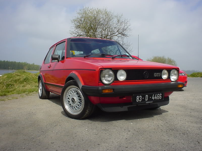

My MK1 1.8 GTi Campaign
Shot from Castlewellan 07 where it won Best MK1 of show

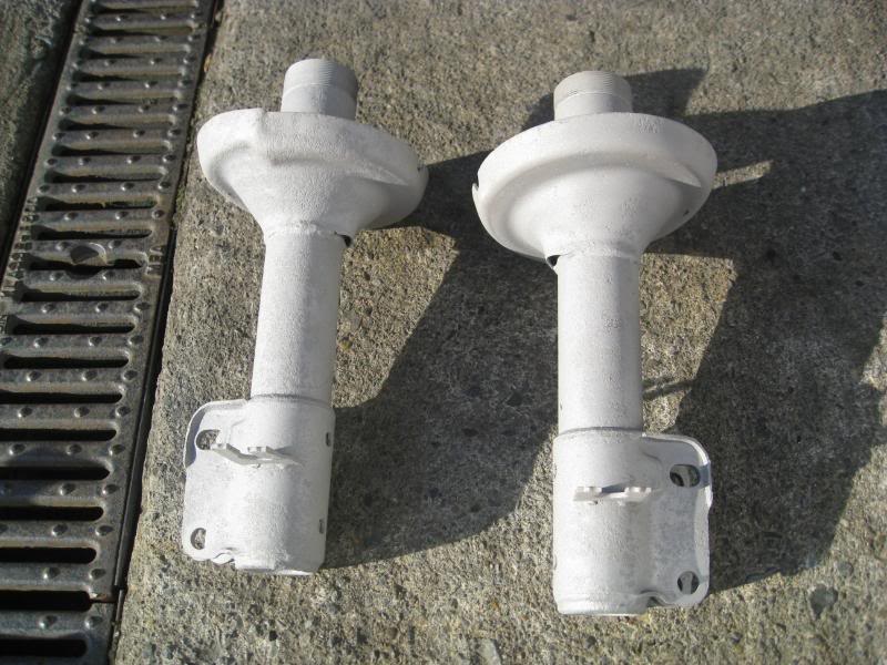

Strut bolts

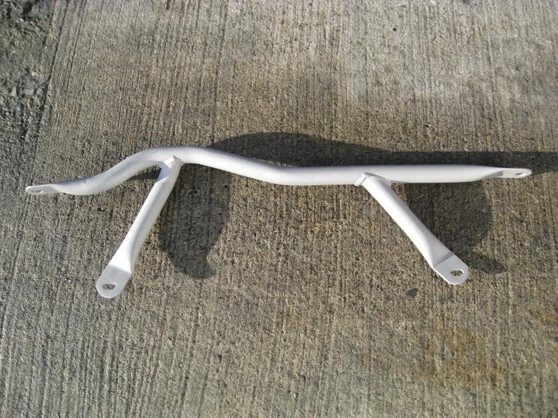

K bar will also be fitted to tighten up the front suspension (sample pic)

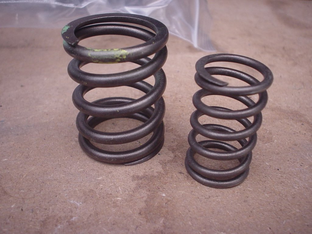

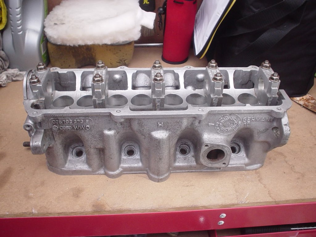

and a nice new mild Kent GS1 cam (its the one on the right - for comparison, the one on the left is a standard GTi cam so you can see the difference on the lobe profile)
New springs

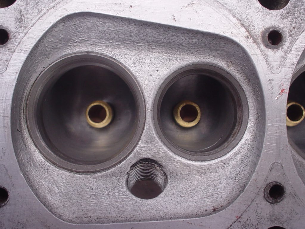

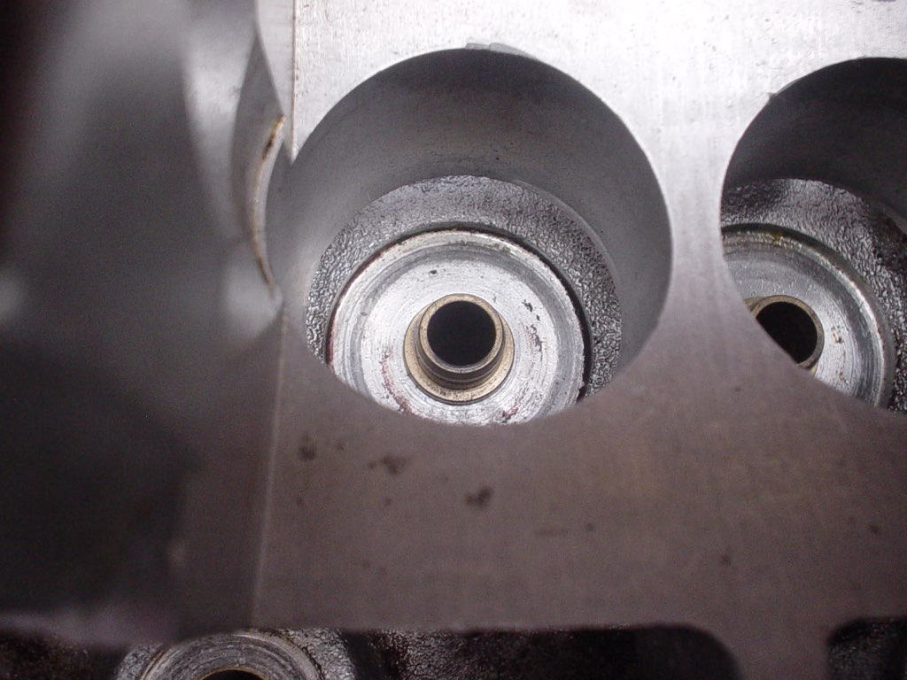

New valves

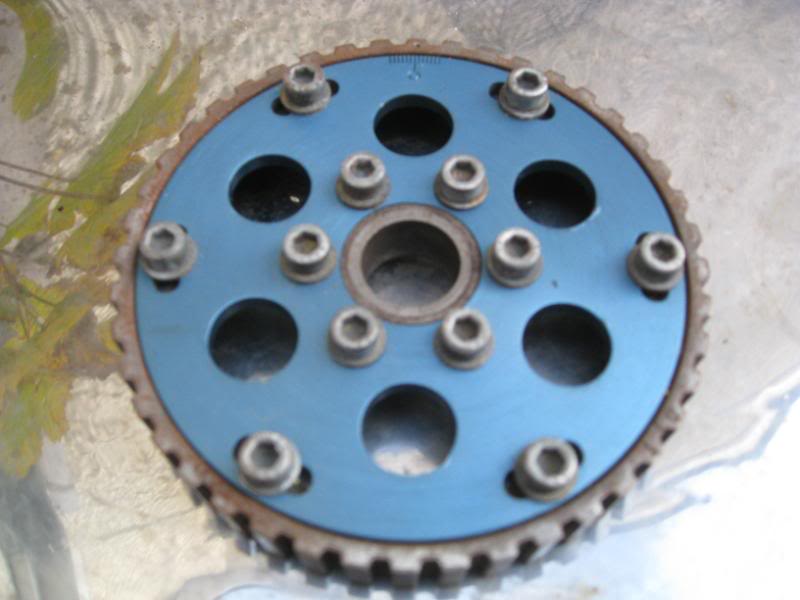

and to complete the sequence a vernier pulley

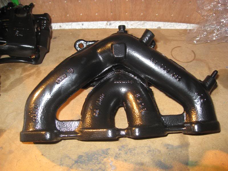

New manifold…

Supersprint stainless steel manifold and Jetex stainless steel exhaust system front to back

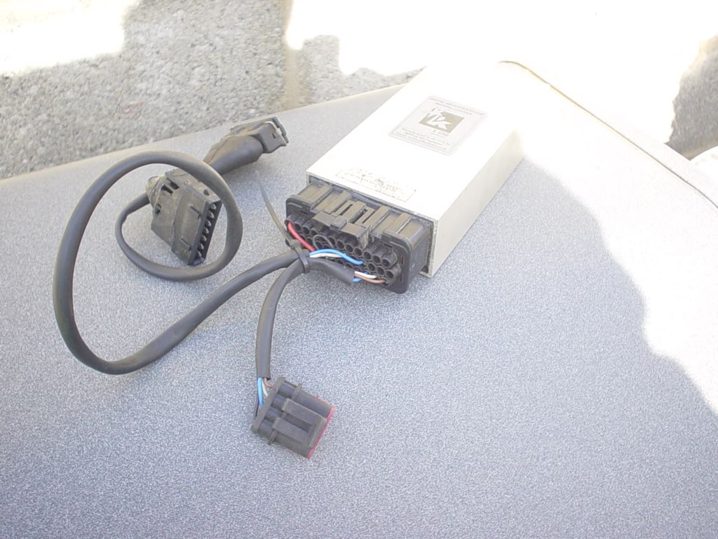

I have a spanking new distributor to fit and have decided to give one of these KStar modules a go:

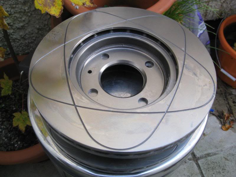

Front callipers, discs and pads will all be renewed.

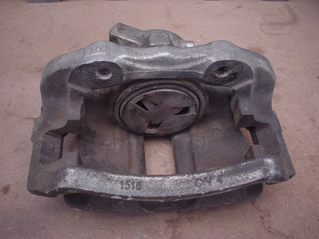

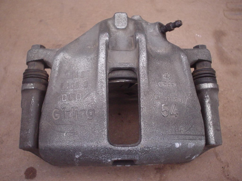

The Callipers will be 256mm from a Scirocco 16v
Discs are ATE powerdiscs - vented and grooved and griped by EBC pads.

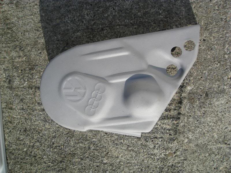

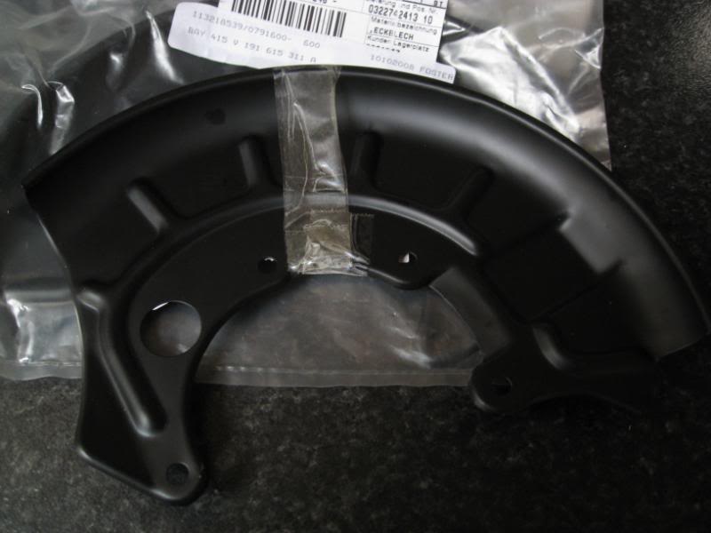

Splash guards

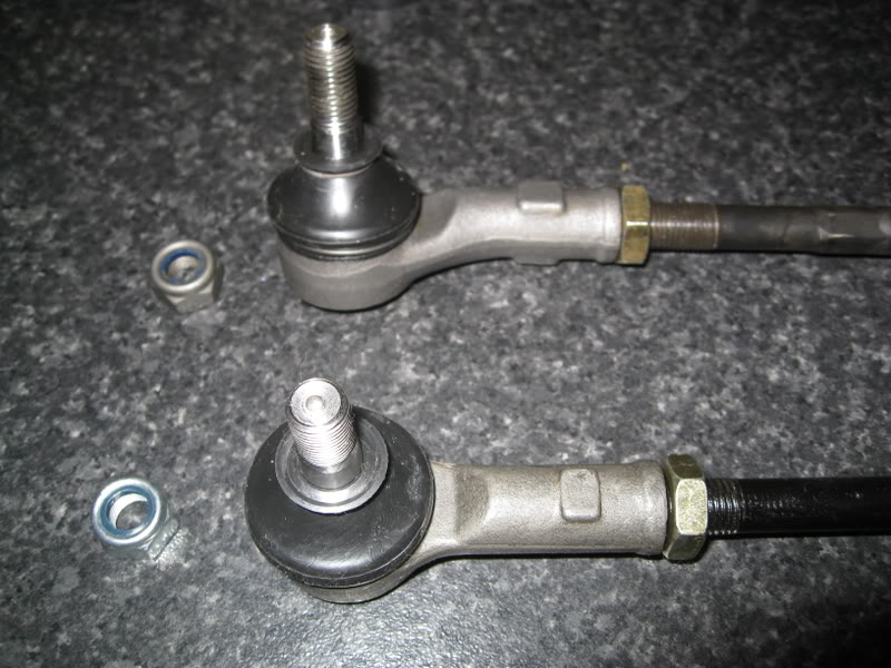

- steering, ball joints etc

Note: originals are not threaded nor adjustable on both sides but when getting replacements you can get both threaded. Just makes it slightly more convenient and less confusing when the guys are setting up alignment etc
Note the subtle differences between the two generations. MK1 is straight ended and MK2 has slight angle.
MK2 is upper one
MK1
MK2

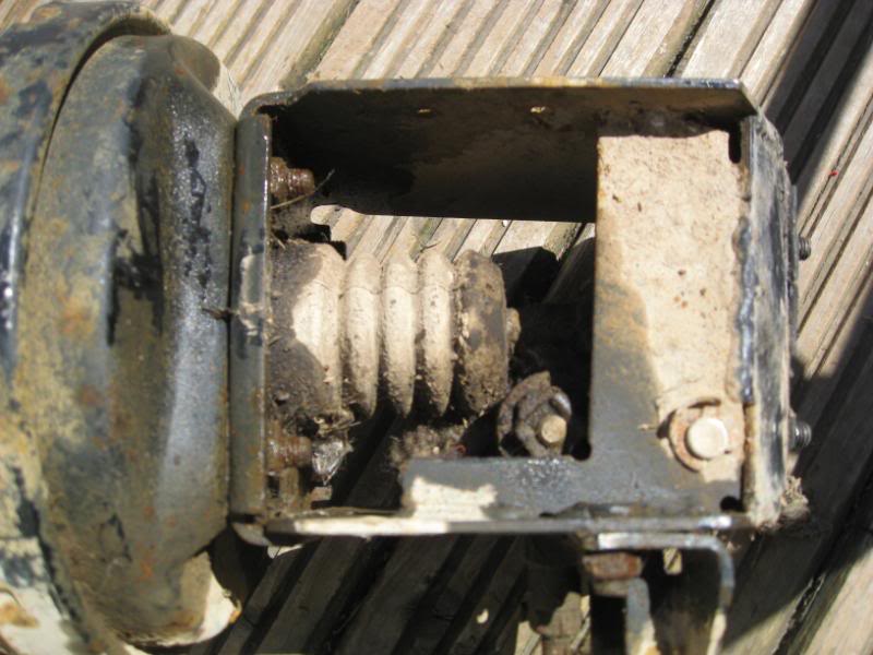

Rubber boot

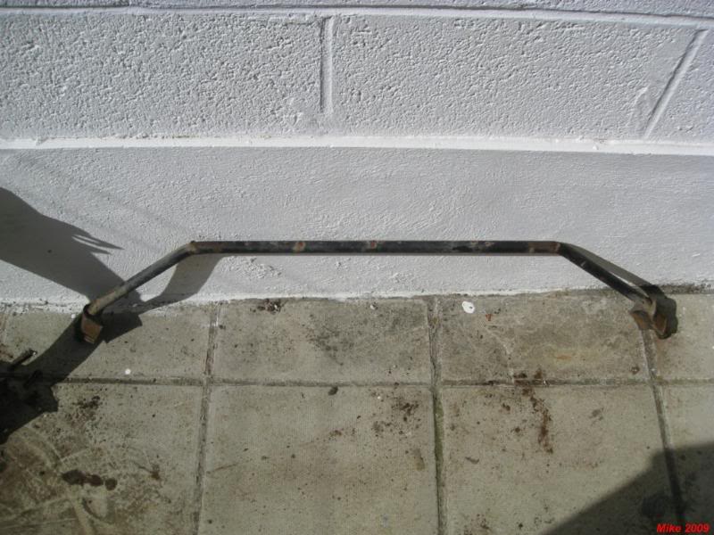

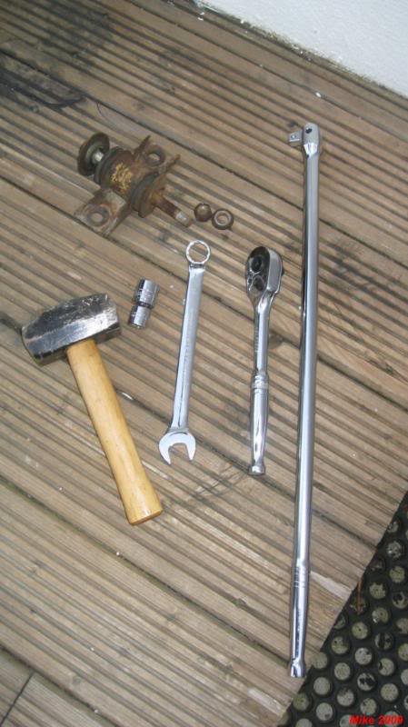

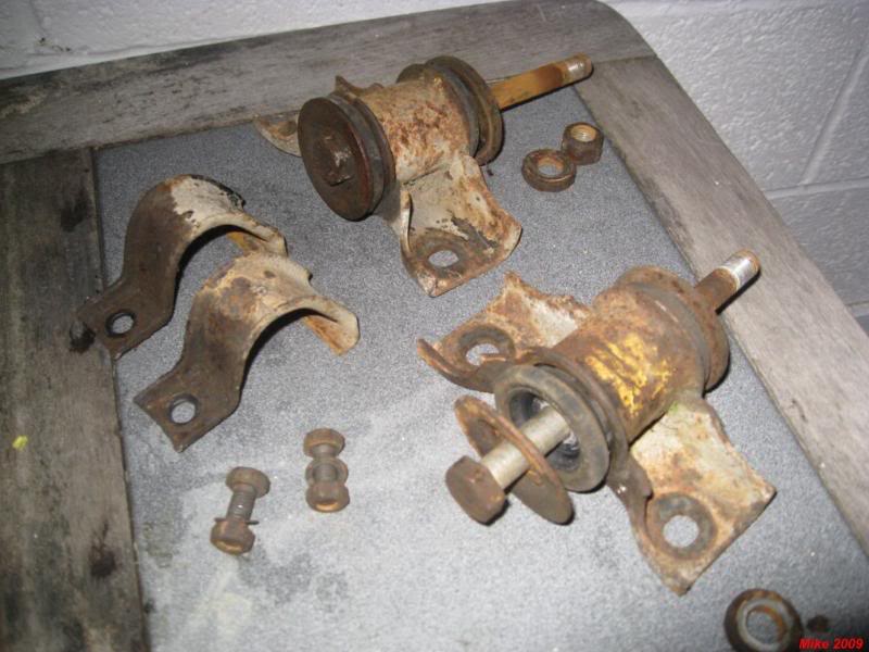

This post describes the strip down process which will cover:
- Anti roll bar removal
- Brakes

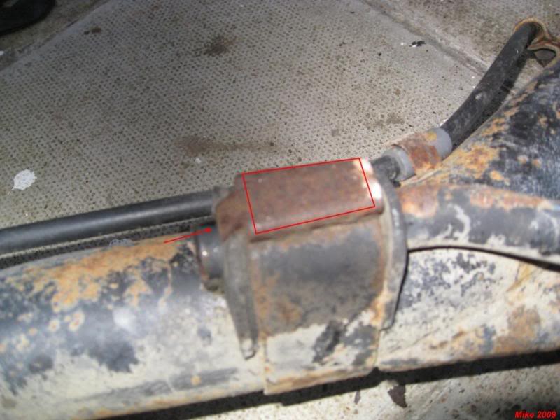

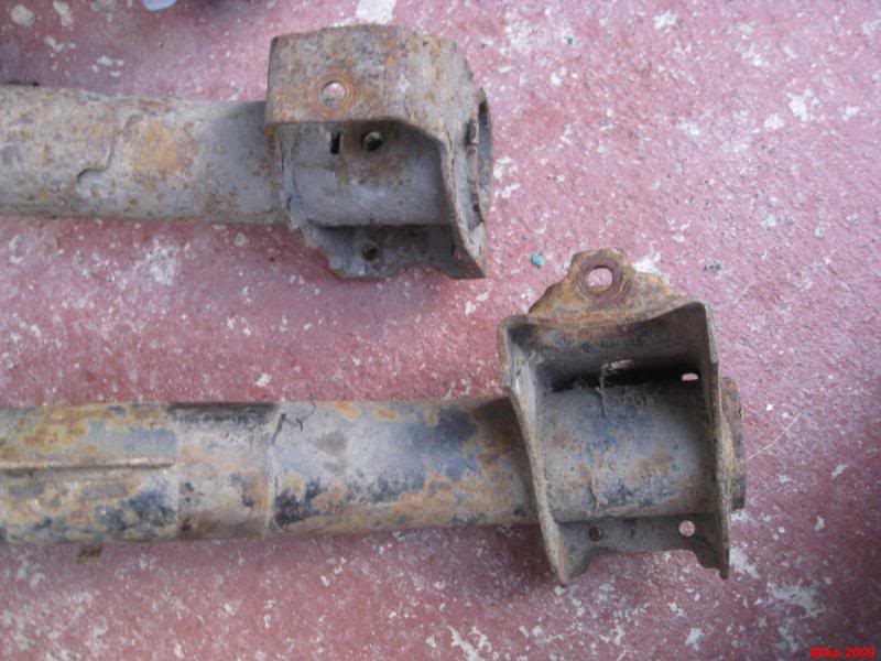

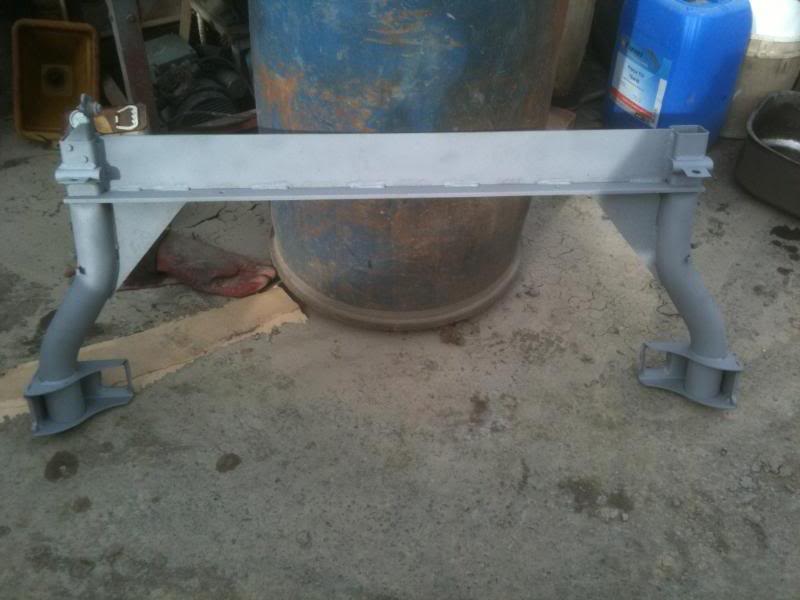

These beams are now close on 30 years old so some preparation is recommended before you belt ahead with the work. Prior to starting the job, I sprayed all bolts with easing oil a couple of times.
First up the tools. Big lever can be handy!
[/list]

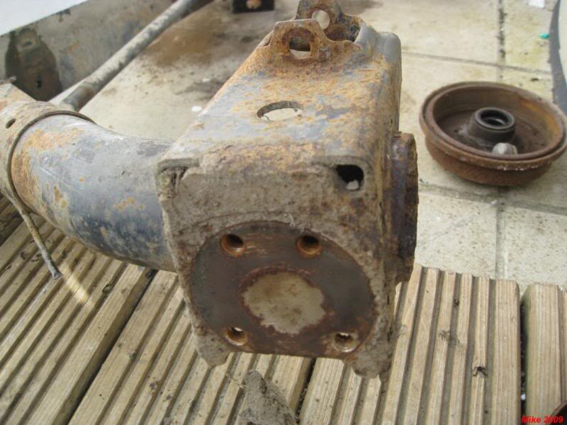

The beam itself was in reasonable condition. The arrows below indicate the areas you need to tackle. The anti roll bar is held in place in 4 locations using a combination of straps and clips. I will be fitting a set of Eibach ARBs at a late stage and the kit includes the new parts required to attach ARB to beam.
Loosen off the bolts holding the retaining clip. The easing oil made this relatively easy.
The clip once removed looks like this.
Next you need to tackle the straps. The straps are secured by a tapered top plate - see red lines. Bend the retaining tab upward and using a hammer and punch tap it off. Unfortunately mine was well secured so I ended up having to cut the plate down the middle. The straps and plates are still available from Crazyquiff in UK if you need them.
The removed strap. Note the grooves at either end where the retaining plate is secured.
Next hold head of the bolt and loosen off the retaining nut.
You should then be left with the selection of parts below. Bush will need to be removed and parts blasted and painted as needed.
The removed ARB

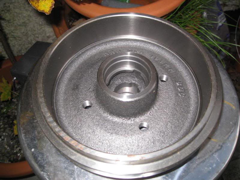

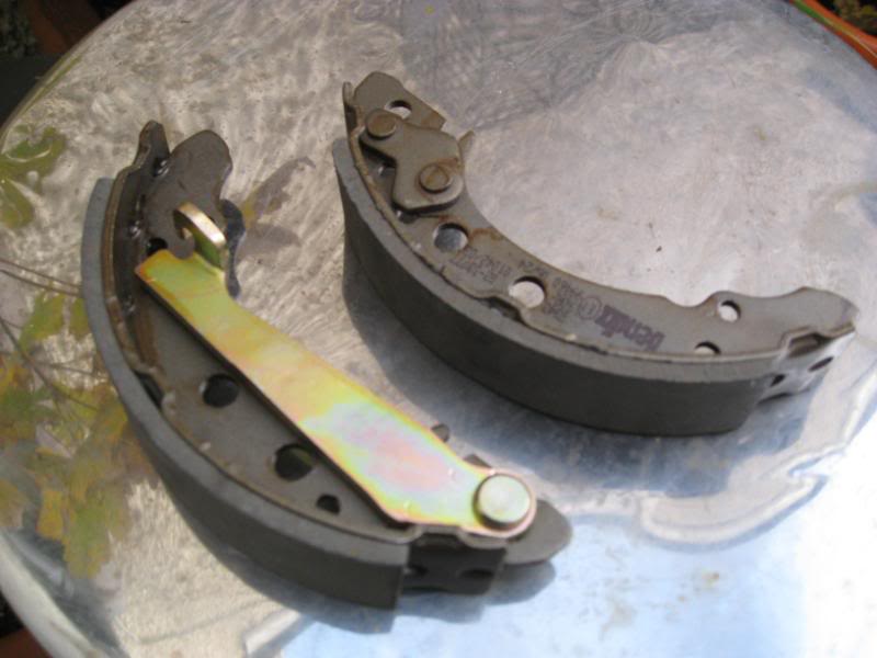

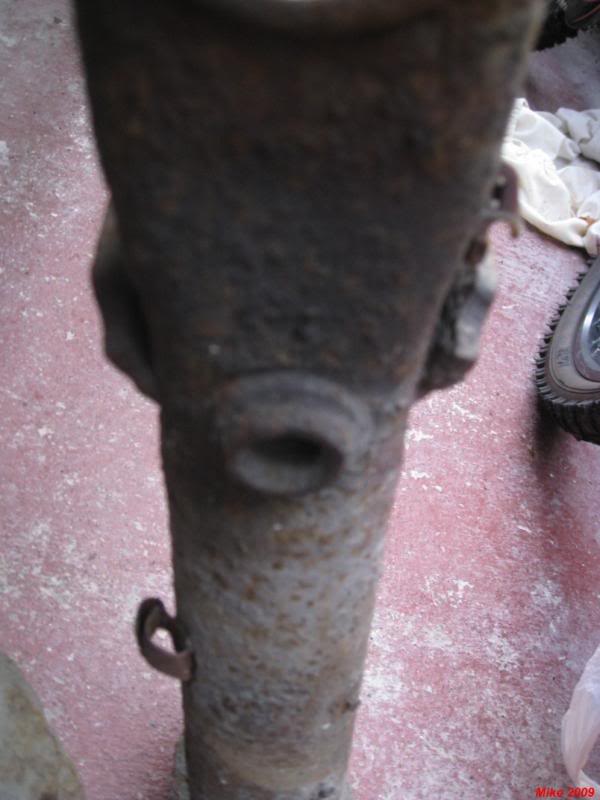

Next up the brakes.
First up remove the end cap, pin, nut, bearing and drum.
Before removing the assembly, loosen off the retaining bolt for the brake cylinder at the back
Next loosen the 4 bolts as indicated. Note the lower arrow which points to a little clip with prevents the brake spring mechanism getting fouled. The big lever may be needed at this point

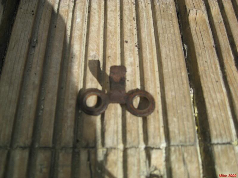

The clip - put away for safe keeping! Note the full spring clip is still available. I got mine in ECP.

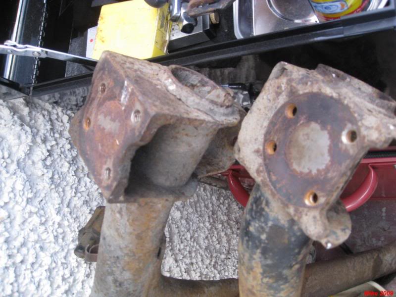

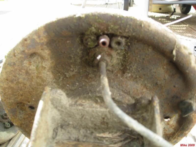

What the end of the beam looks striped:
and the rear of the plate
The striped MK1 beam

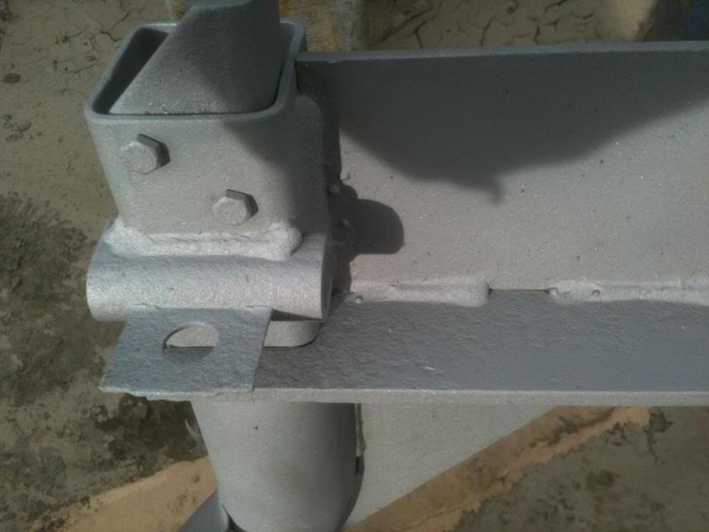

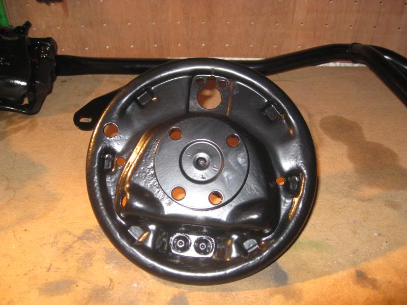

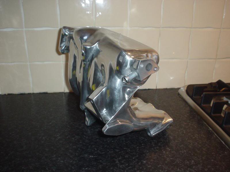

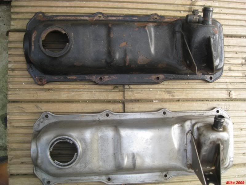

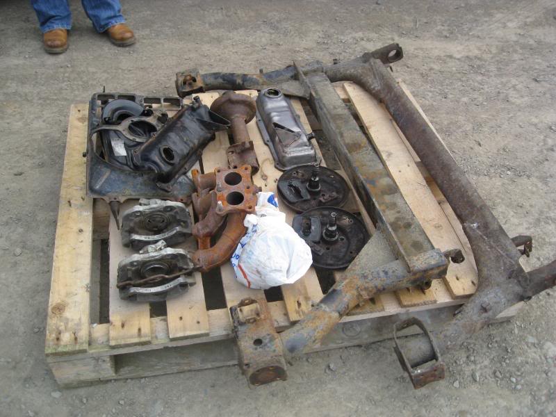

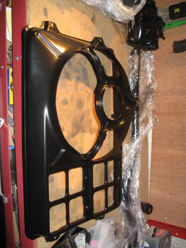

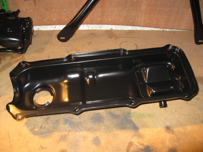

Some of the other bits heading off to be blasted and painted. Mixture of rocker covers, rad, K-bars.
I have some more parts to be done but need to dig them out this week. Just showing these pics so as again you see before and after to get an understanding of what is possible.
K-bar, one of left is actually fine but I'd like to get it touched up.
MK1 Golf Gti - Mars Red Campaign / MK2 Golf Rallye SE/ MK2 Golf Gti - Black 16v (small bumper) / Corrado - Red G60 / Porsche 911 (Daily)

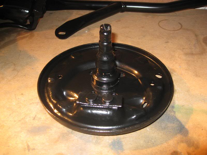

Very happy with first phase.
This is what they looked like before!
I'll put up better pics when it's all being reassembled.

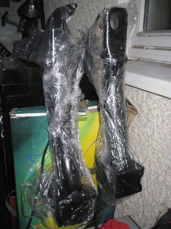

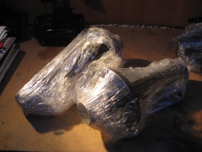

nicely wrapped up
Didn't strip the beams but you can see the end result
Note: shafts were wrapped in tape

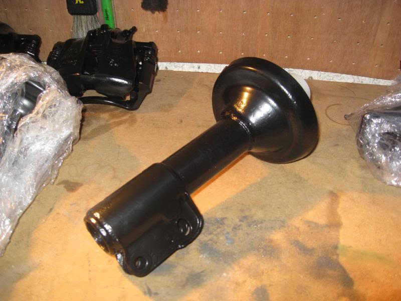

Rocco 16v Callipers

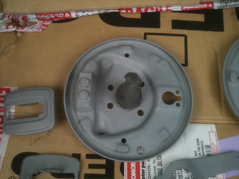

All parts so far are satin finish whereas callipers are gloss…

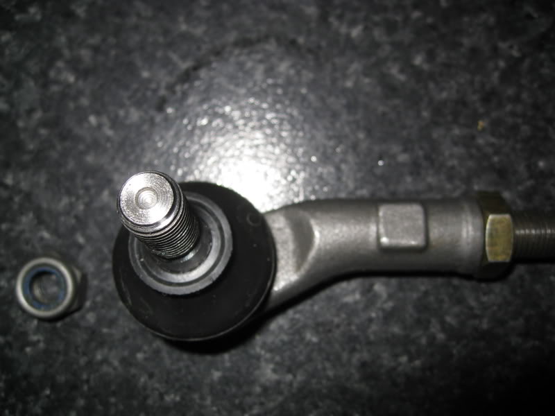

I have new aftermarket MK1 wishbones but given the way the sand and powder work is turning out I picked up a pair of originals to get the treatment also. I'll see how they turn out then select the best option.

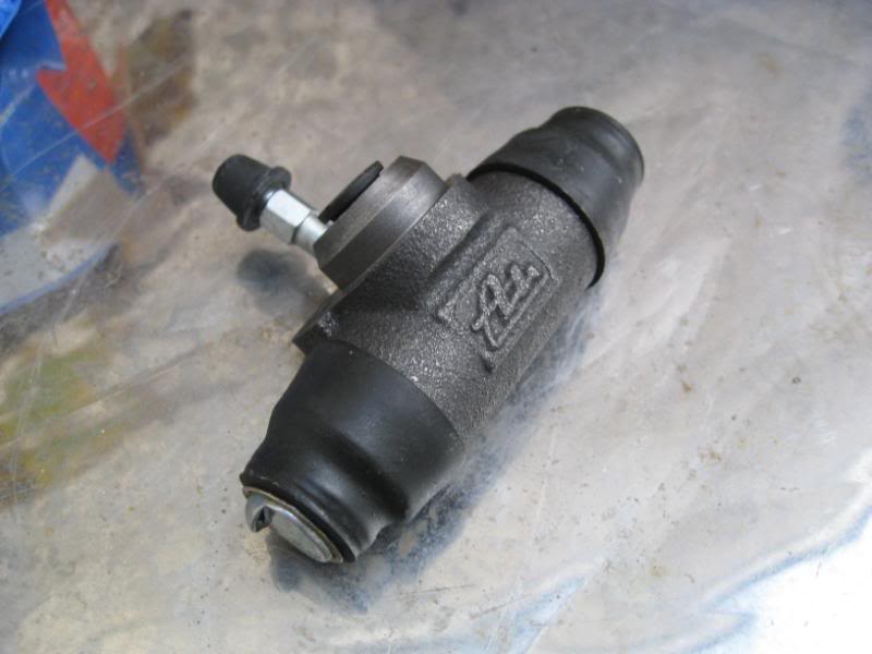

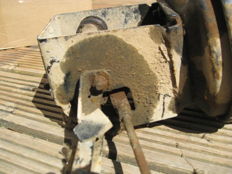

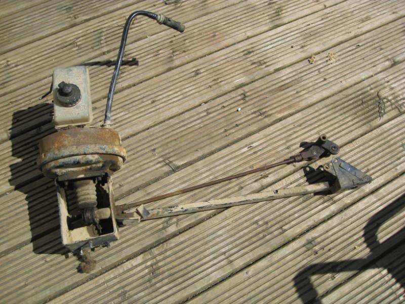

Also, the infamous brake linkage from the MK1. Planning on refurbing this also. Again a variety of pics below to see how it all hangs together. Will get better ones after the refurb for those interested.
