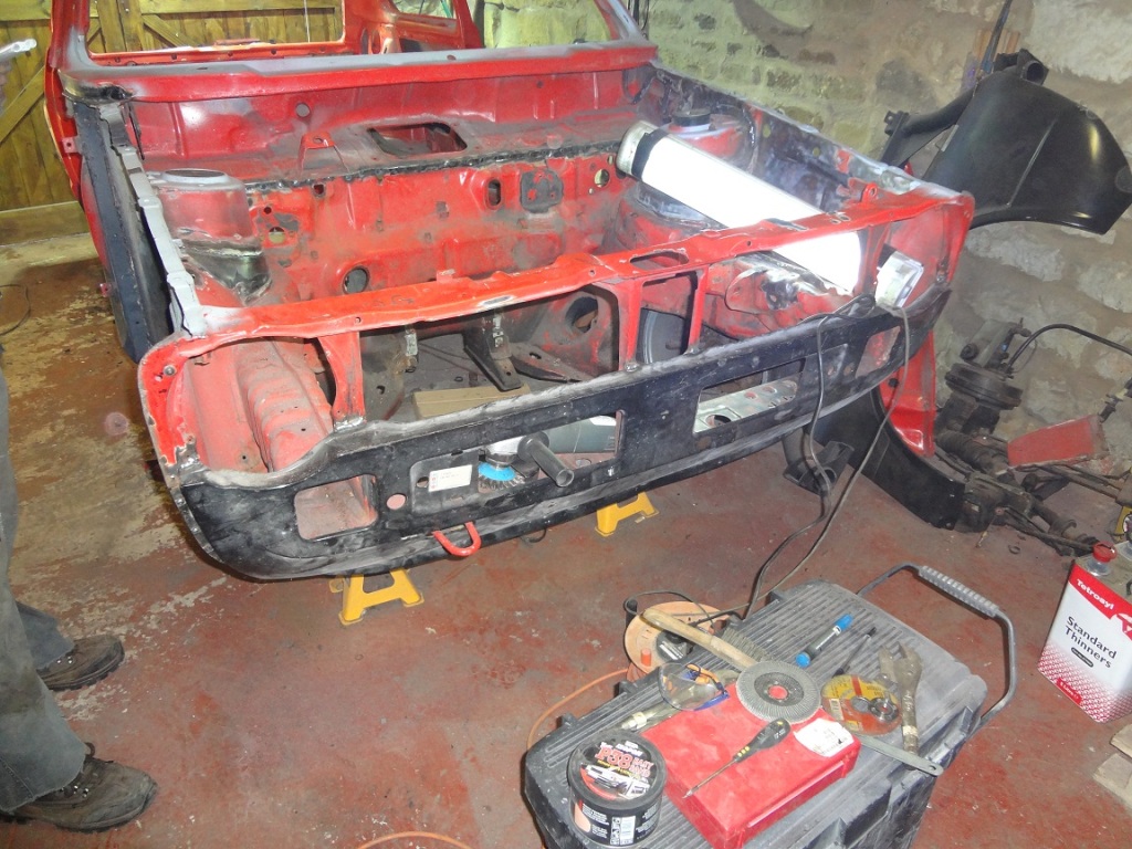

My mate who's a steel fabricator has a few days spare so we've hammered on

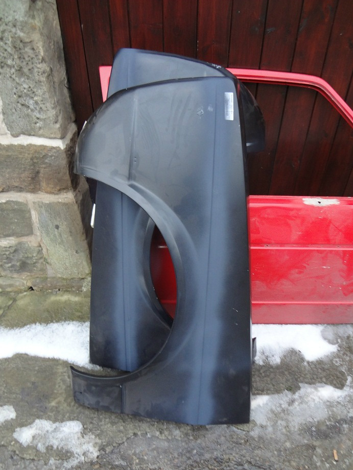

Replacement front wings have had the mid level trim holes welded up

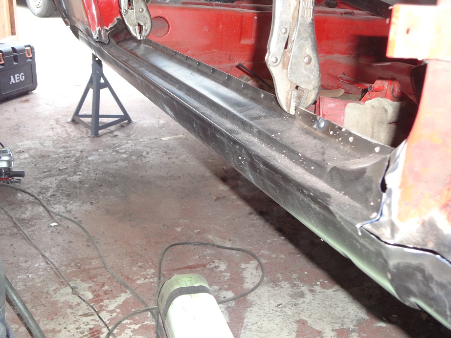

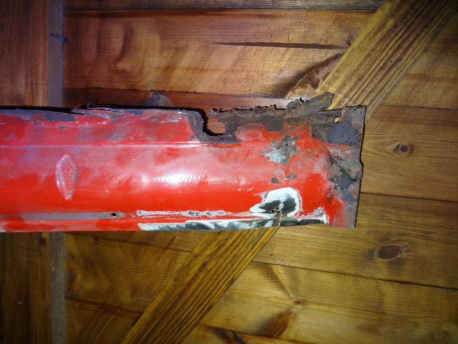

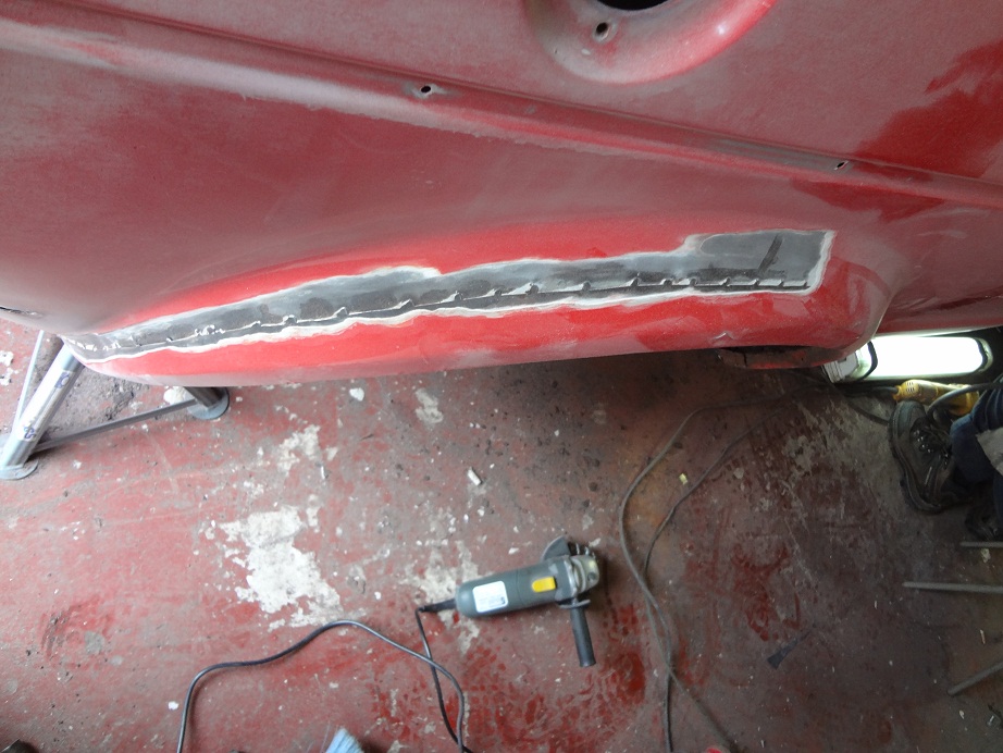

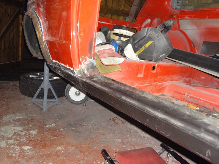

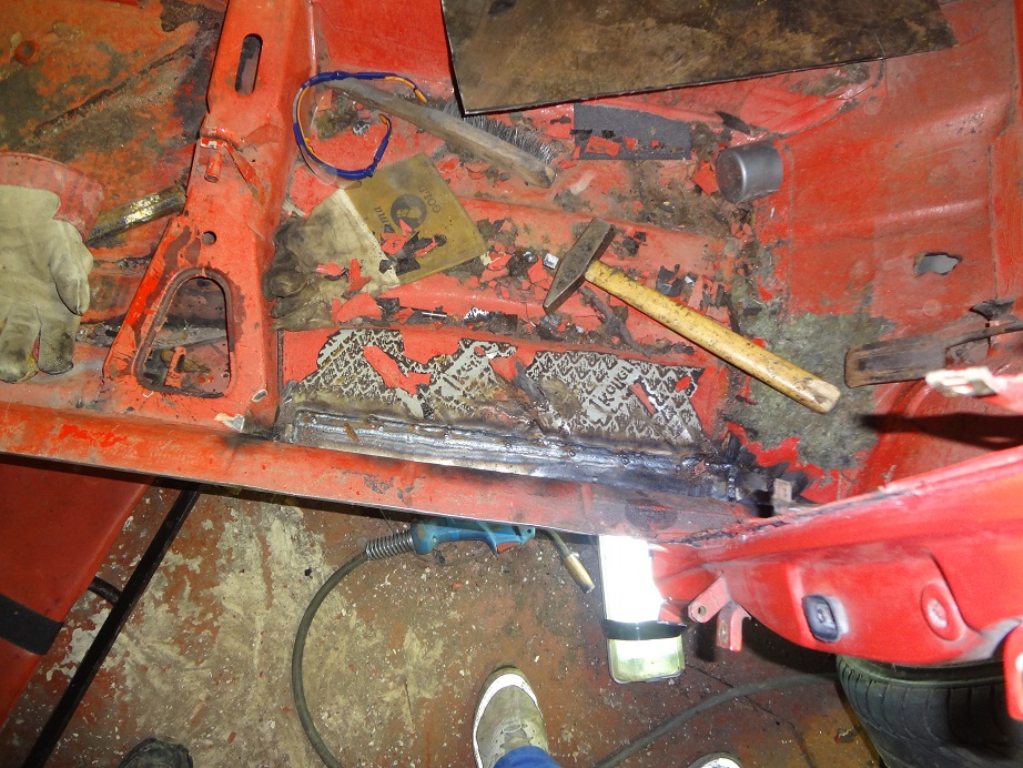

Took the offside sill off as it was pretty much all rotten
Ended up having to replace panels in the floor prior to fitting new sill

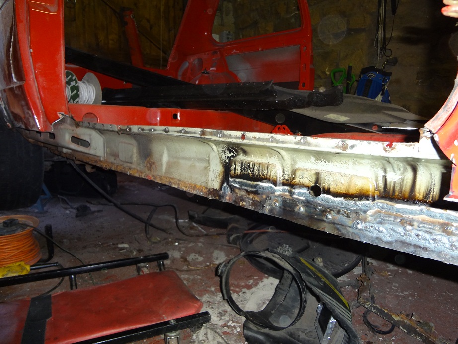

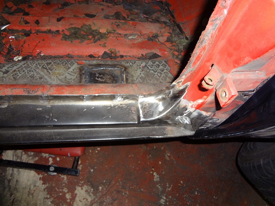

New sill offered up
And now in place and all welds tidied

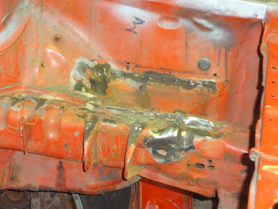

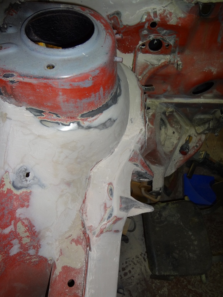

Scuttle tray removed
Battery tray removed

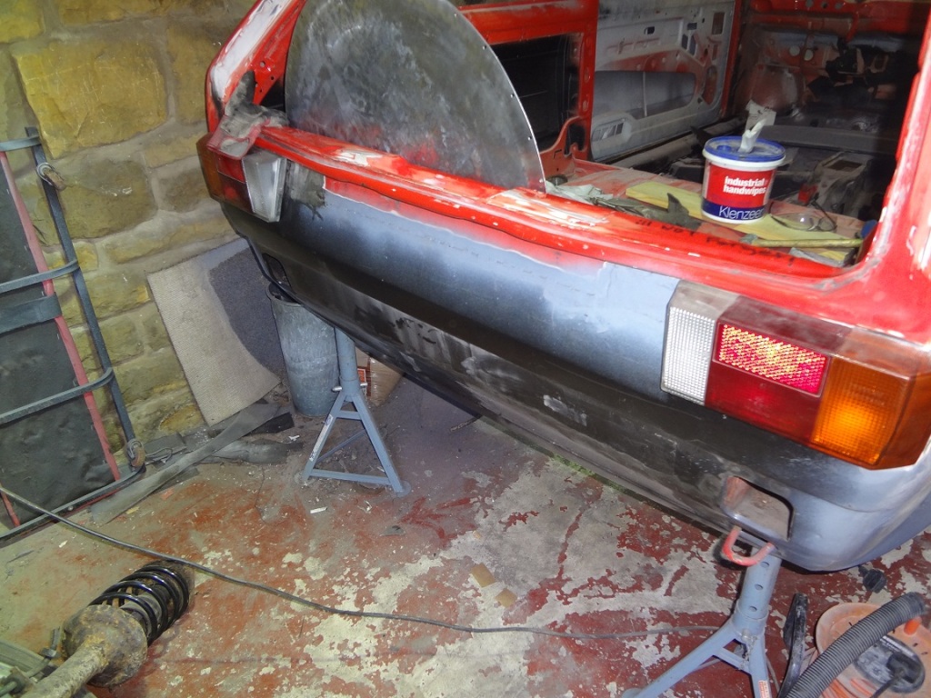

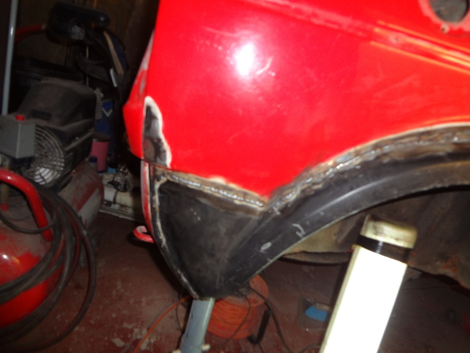

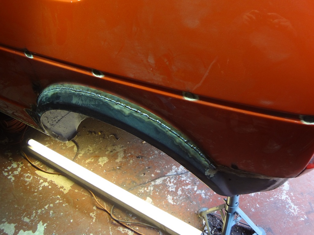

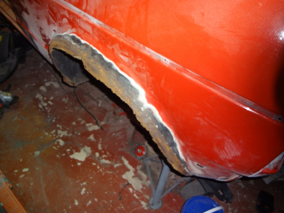

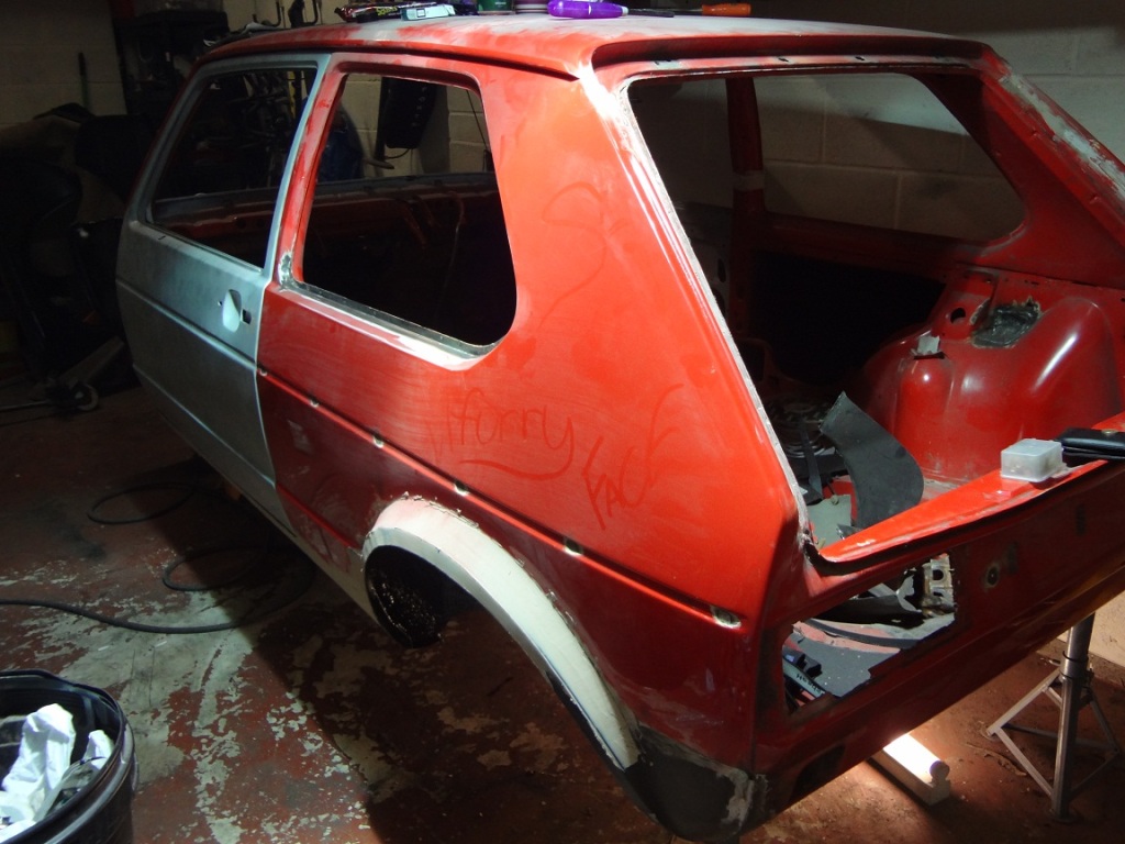

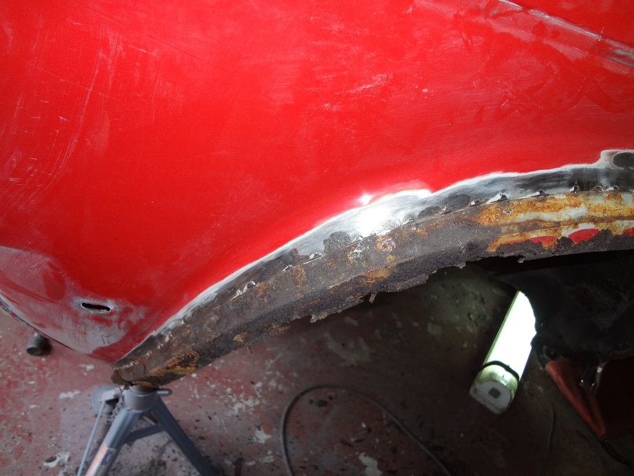

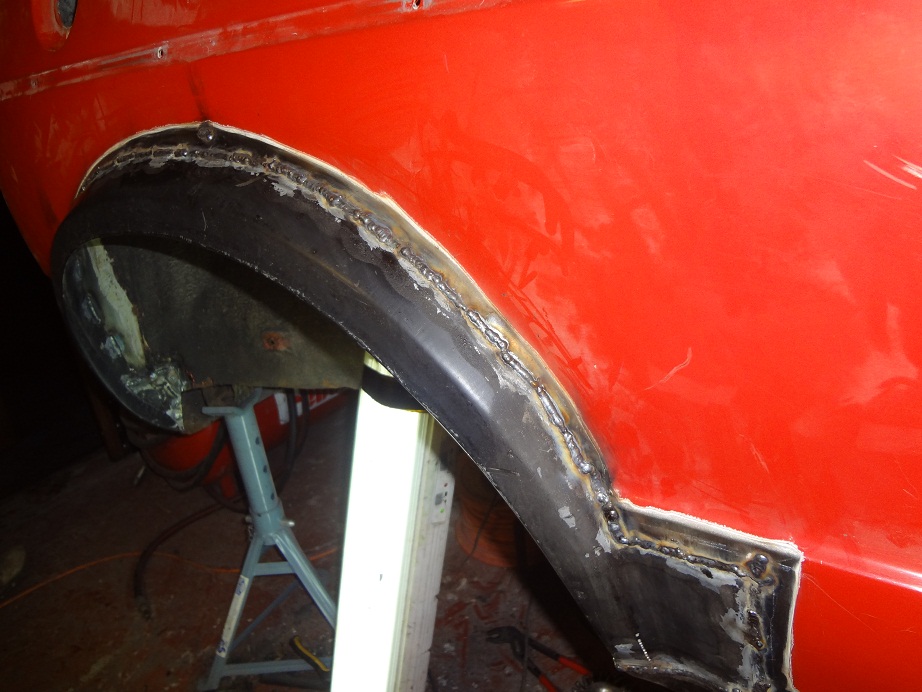

Knowing the rear arches had been replaced at some point (because you could see the spot welds through the paint!) I ground back to find that they had been placed over the original arches, and 6mm of filler used to try and cover up.
And here's what I found after removing the previous 'repair' work
So inner arches on order and hopefully arriving tomorrow. Aiming to have one arch fitted tomorrow.

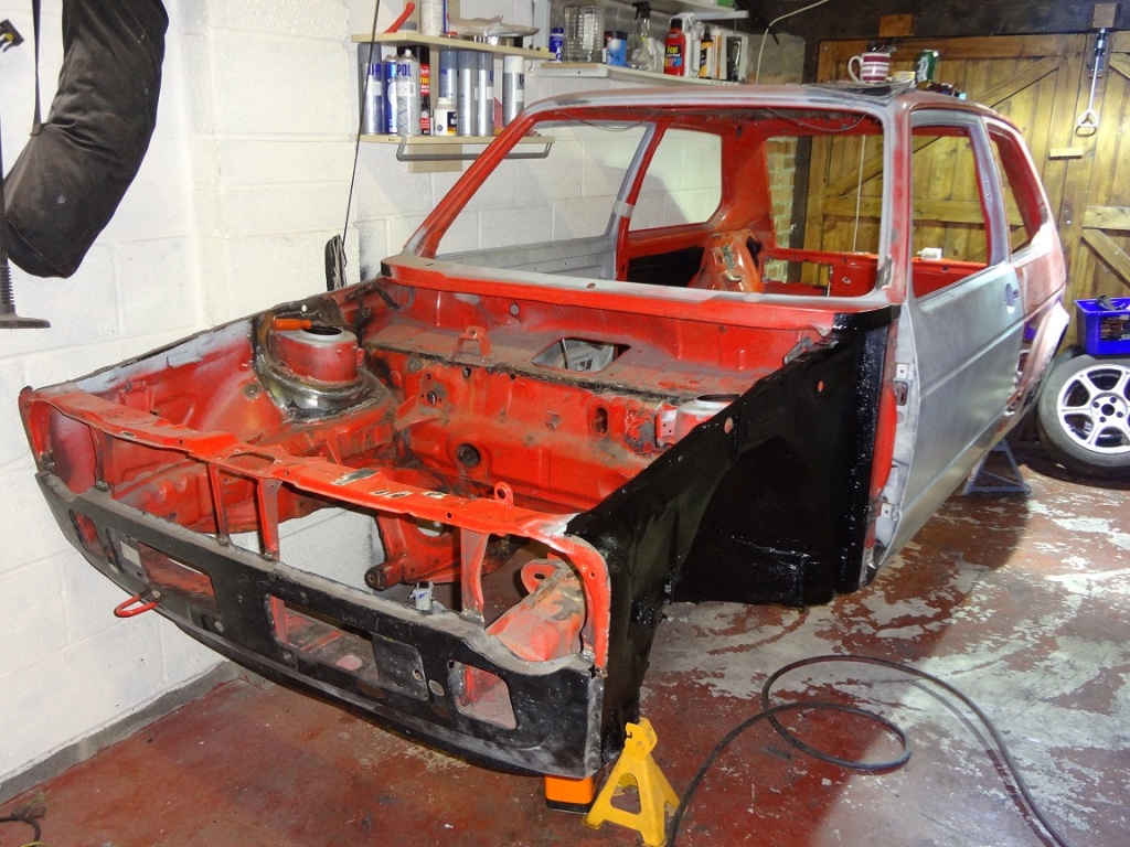

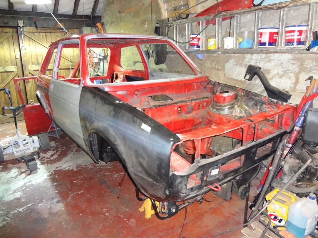

front end on
Front and rear offside arches shutz'd
The doors gone on but then we found that the roof gutter had corroded at the end under the paint

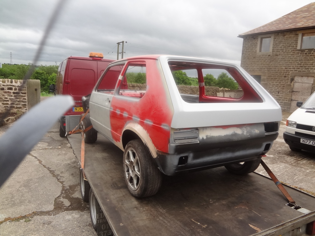

Rear end prior to small light conversion (to be completed next week)

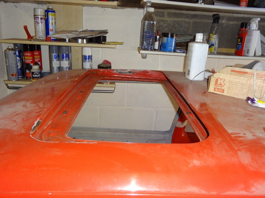

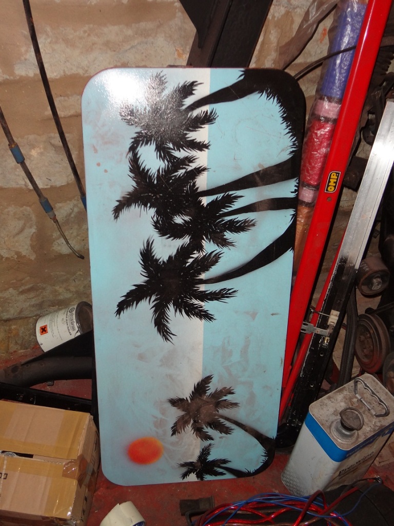

Sunroof removed and more rust
Love the old sunroof. Gonna try to save it as much as possible but it will be difficult

Getting there. Now things have changed though. Colorwise and engine wise. Need a BAM

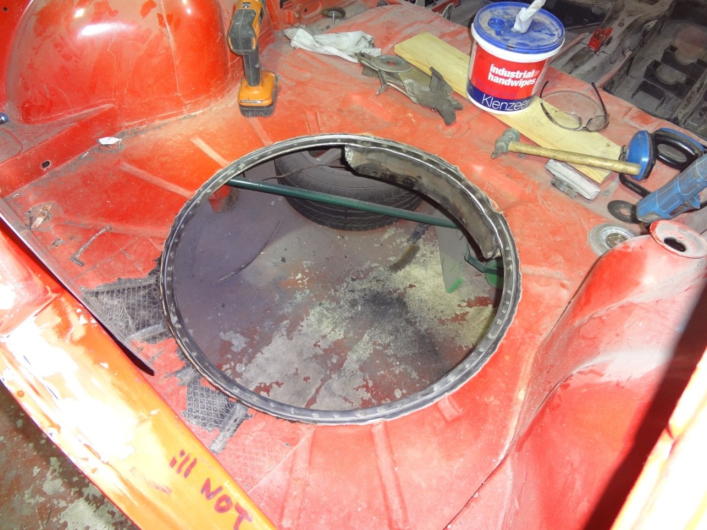

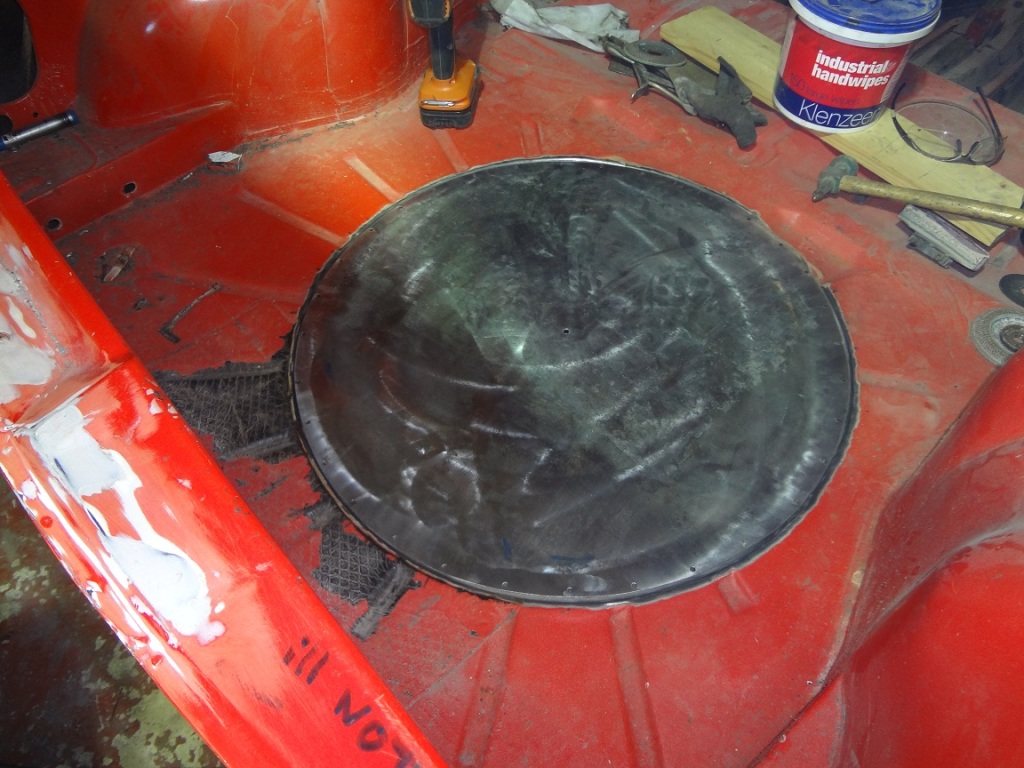

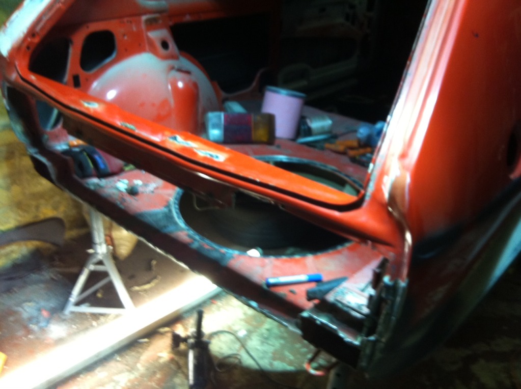

Took the spare wheel well out as it was rotten as
Nice shiney plate now

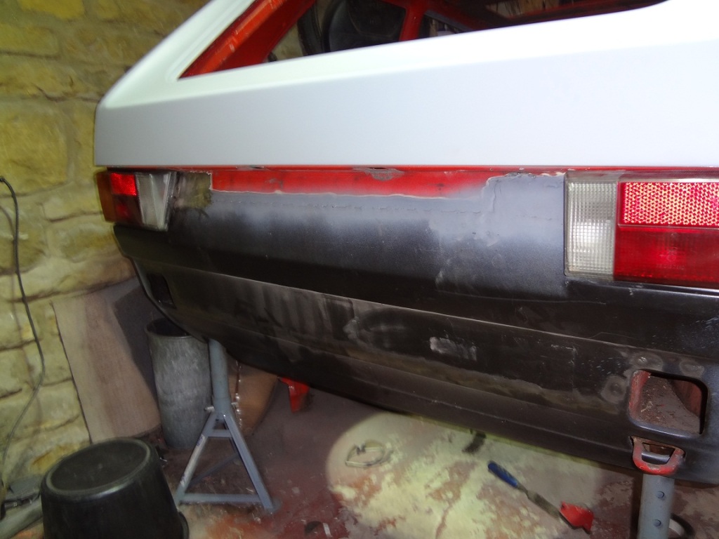

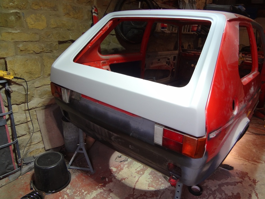

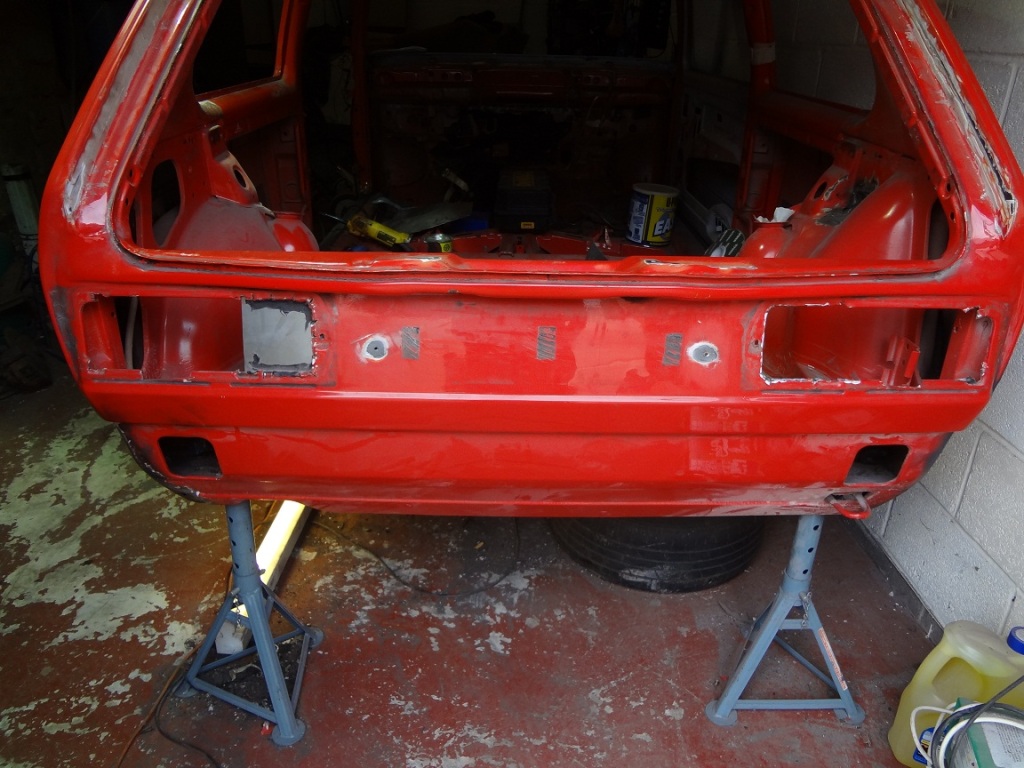

Rear panel off
New rear panel on and those small lights fitted
Looking sweet so now to get on with the filling and sanding

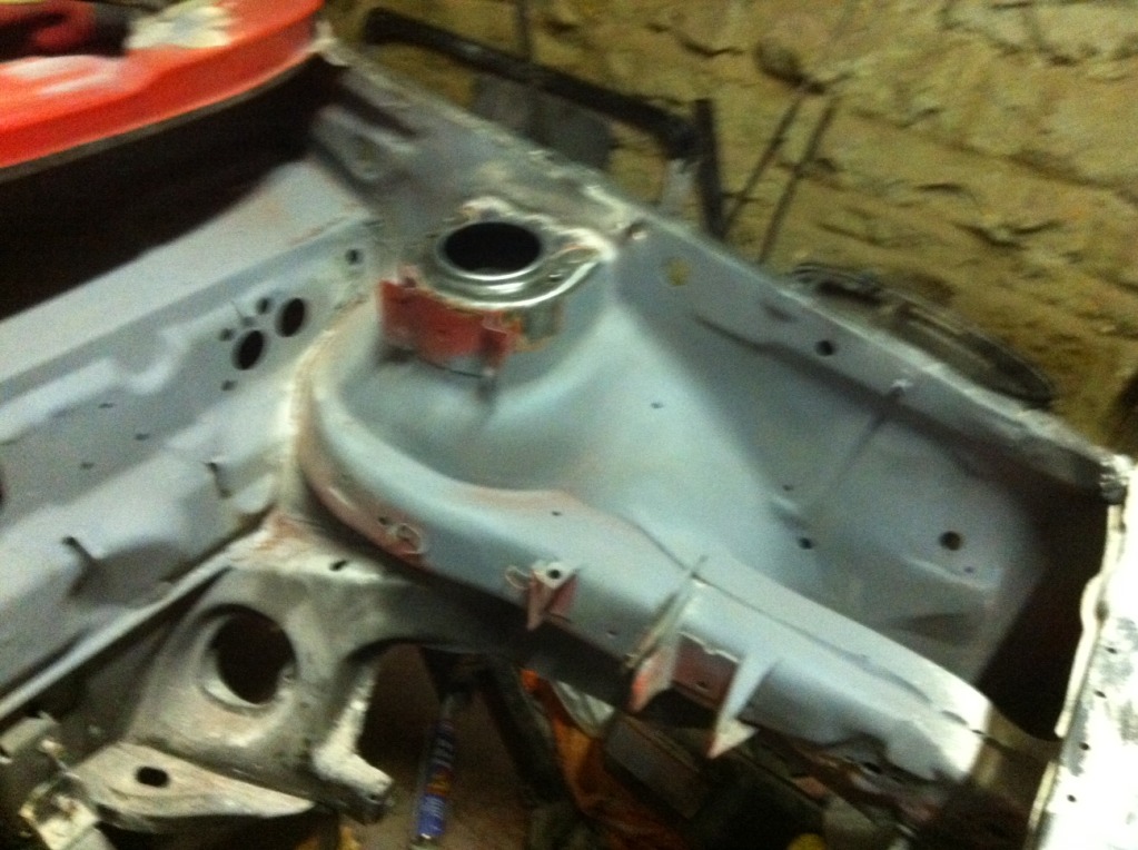

Already made a start on the engine bay

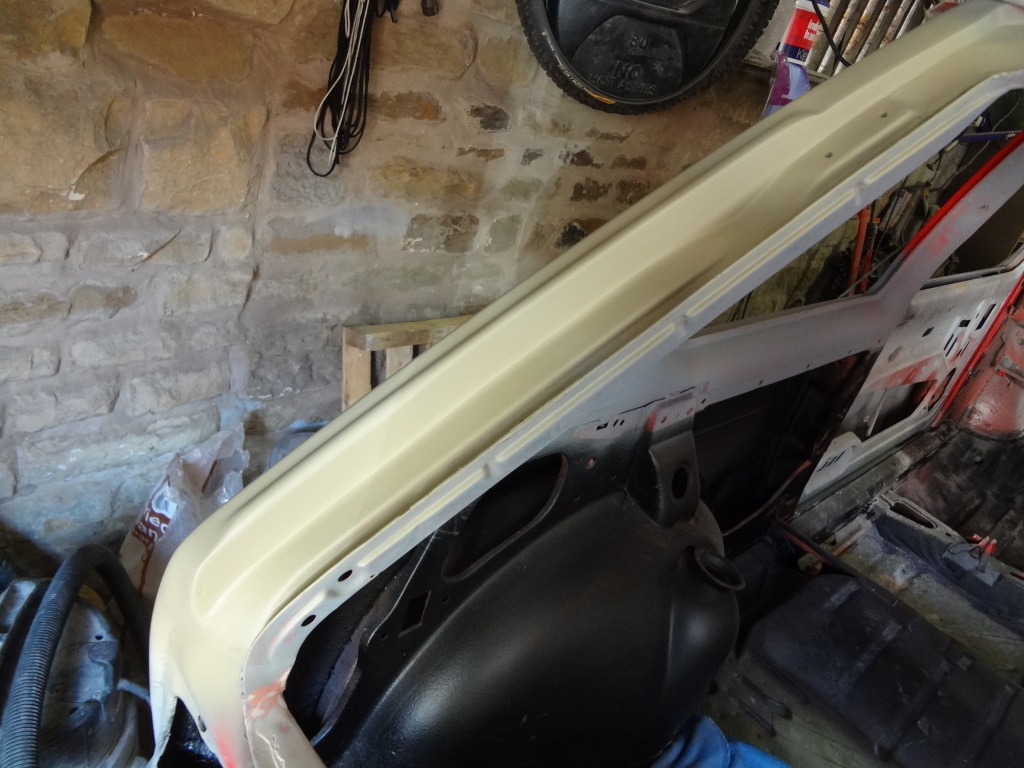

Smoothed both rear end rain gutters

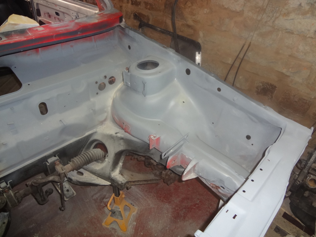

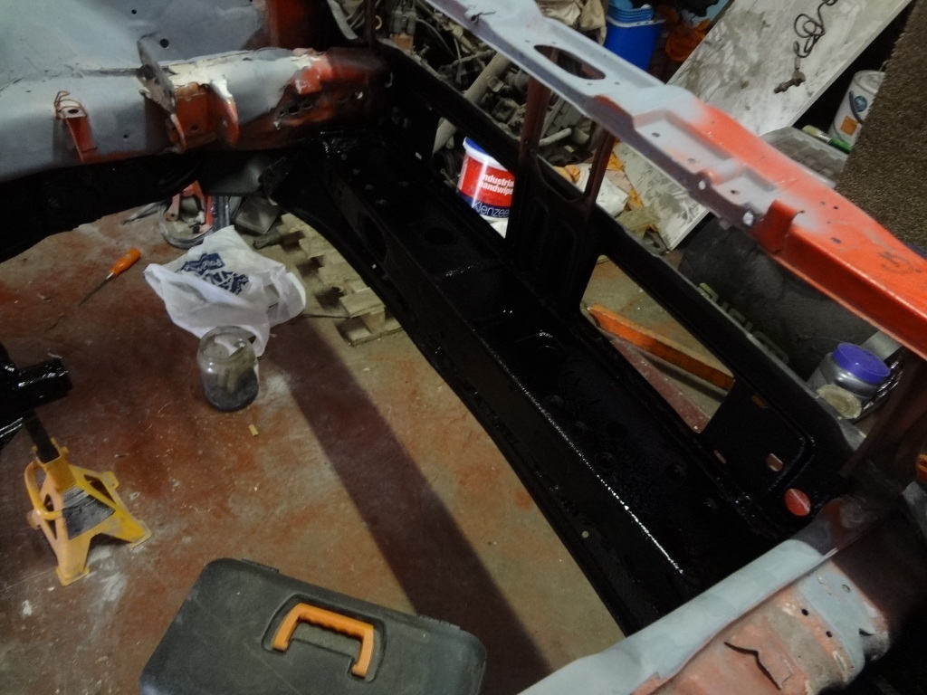

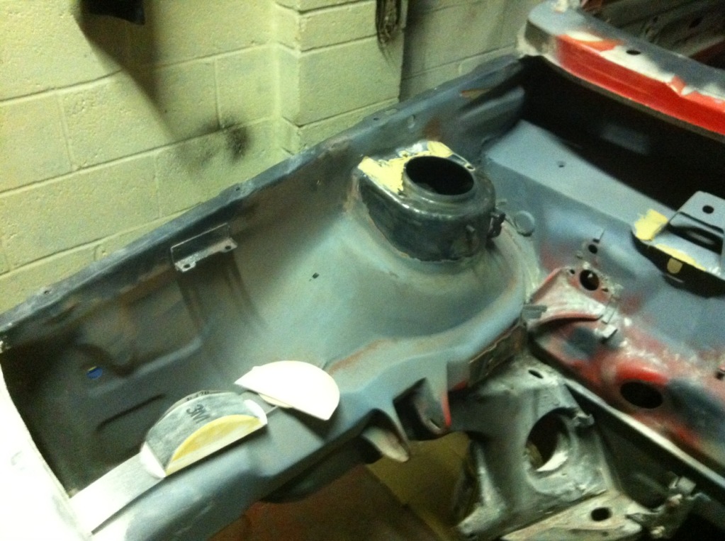

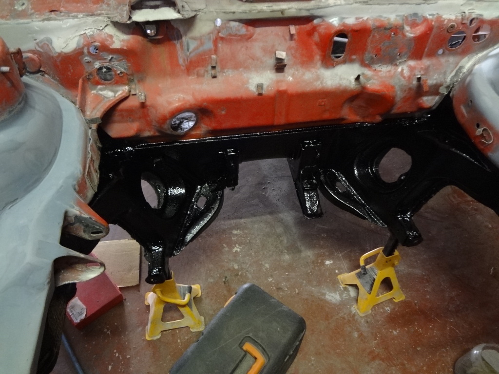

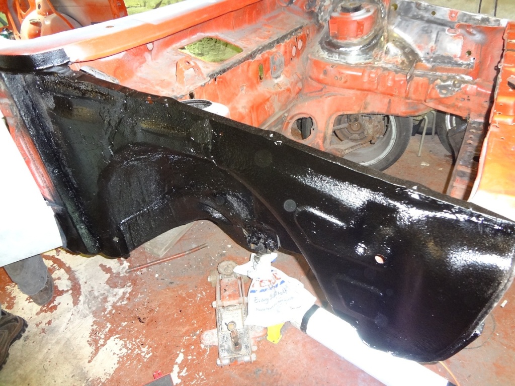

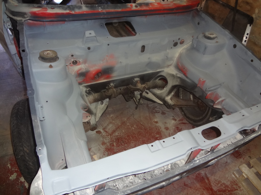

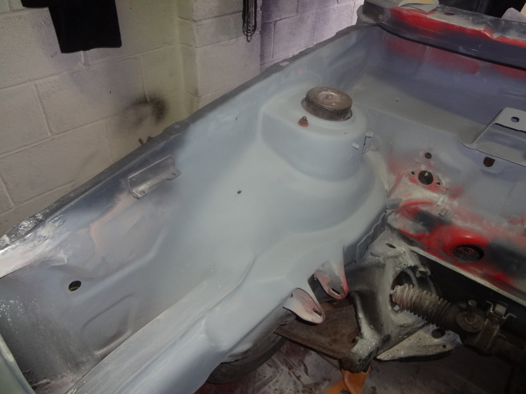

Shutzed the lower part of the engine bay for added protection

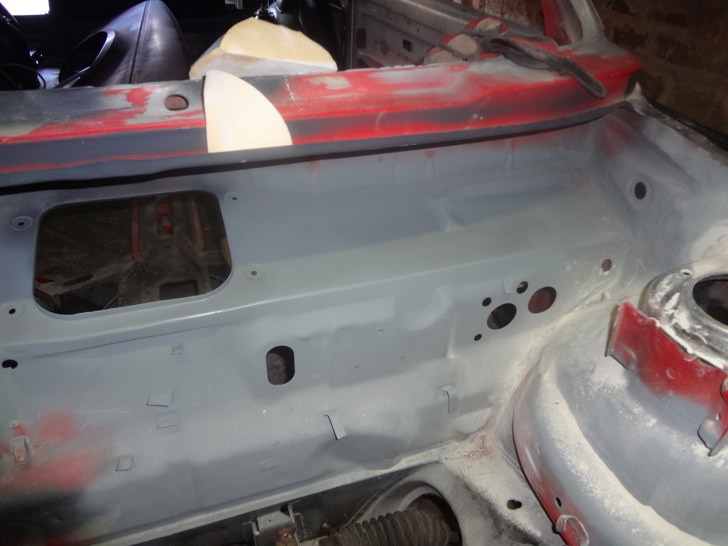

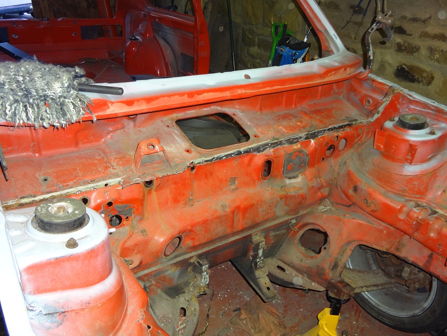

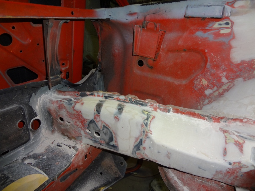

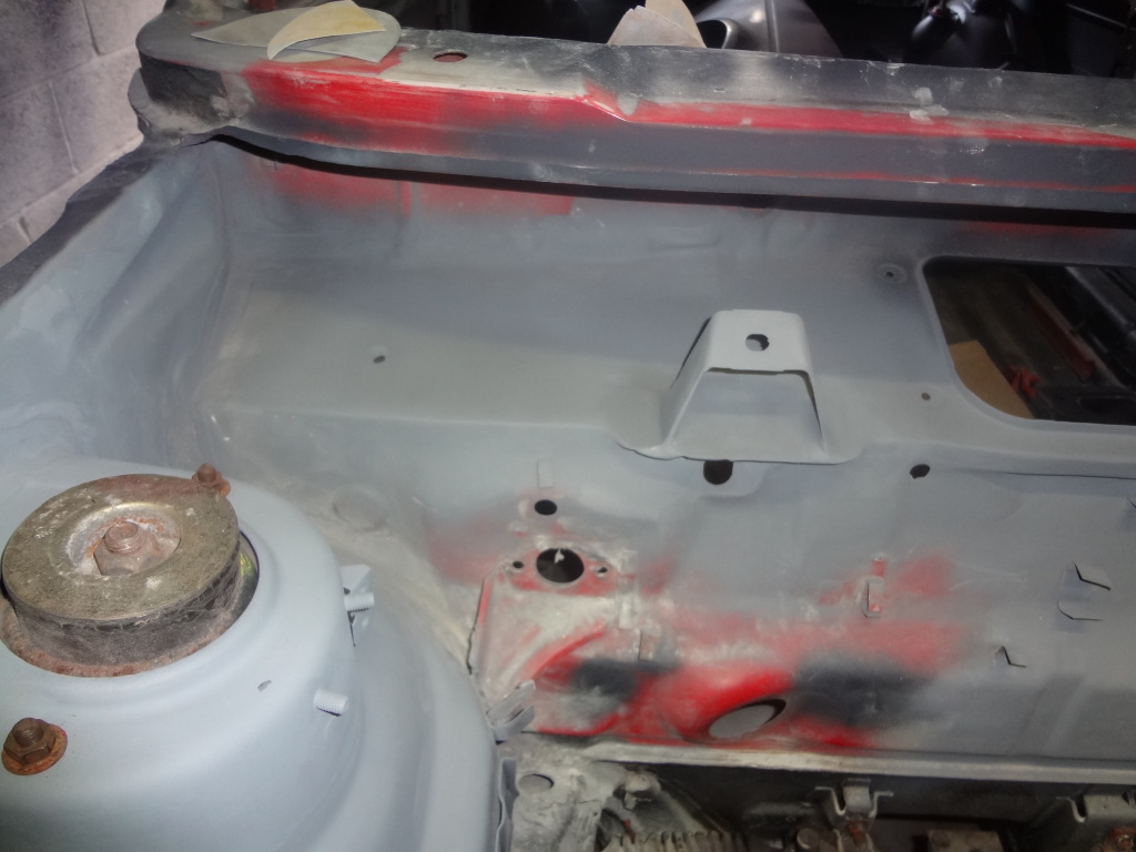

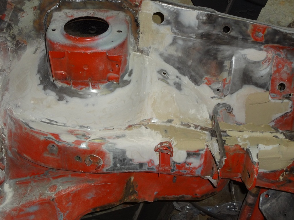

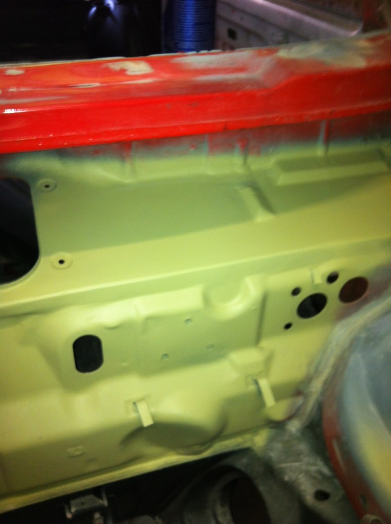

Fire wall has been smoothed and s.o have the pits left from removing the scuttle
Not the best photos because my camera died so had to use my phone. Heres the results so far

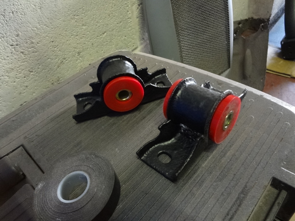

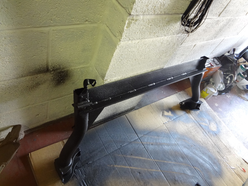

Ive also reconditioned the rear axel and polybushed the axle mounts
Ive had engine mounts, cam belt cover etc. blasted and powdercoated but no photos taken and wouldnt want to bore everyone to death. Shes now a rolling shell and off to painters Thursday. On with the engine next. Thinking wrinkle VHT paint for something different. The instructions recommend baking the paint for best finish so when wifey went to tesco's I thought I'd try fitting the gearbox in the oven. Wifey came back early and wasnt impressed. It didnt fit anyway so plan b is the utilise a diesel powered garage heater that Ive spied in my mates garage

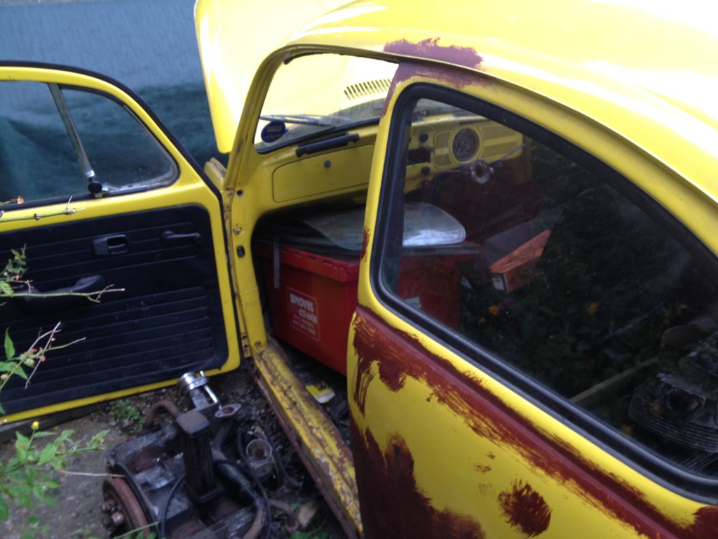

Our Gert however has practically bought a bug for £400, calling it 'my next project'. And it all stems from using my mates bug for our wedding car. Picture here, again photoshopped by me

Betty the bug has now joined us thanks to our gert
